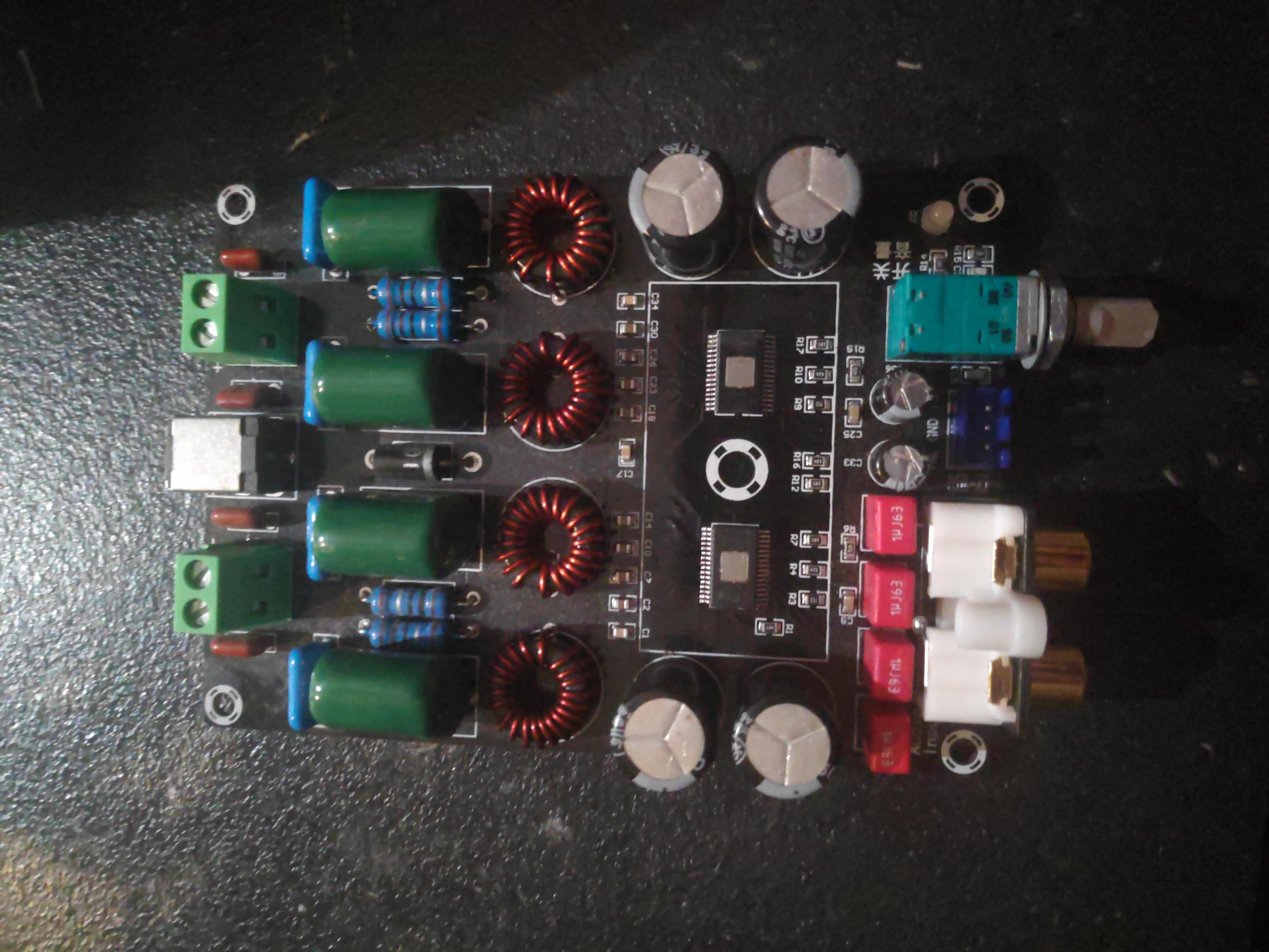

I decided to swap the incredibly shitty pot on my amp board for a better one.
And I managed to somehow destroy it. One channel is still playing nicely, without the noise of the original pot, but the other channel is just noise and no sound.
I imagine I damaged the pcb when prying off the old pot. I think the connections are on the top of the board, where they can't really be seen so well. Can someone with a better knowing of this board suggest where I should try and solder a jumper wire first?

XH-M590 Many postings ago I was asked which TPA3116 board I found was the best. I made a brief study from photos of different boards and concluded that the XH-M590 board seemed to be one of the best ( KYYSLB DC12 24V High Power 100W*2 TPA3116D2 Digital Power Amplifier Board XH M590 Home Audio Amplifier Board 2~8 Ohms|Amplifier| - AliExpress ): Good output filter components, dual TPA3116 chip with a large heatsink fastened with a screw, decent power line decoupling with possibility for upgrade, good connectors and film input capacitors.
An issue was that the XH-M590 board exists in two version of which a less attractive version has two smaller heatsinks glued to the TPA3116 ICs and uses non-standard squared power-rail decoupling capacitors. I managed to find the version I preferred and ordered it on 30.11.2019. Tracking the parcel with the board went well until I was told (E-mail) that the board had just been delivered to me which it had not. I investigated the fate of my parcel but found nothing precise and in the end I kindly got reimbursed. I forgot about the board. But, Monday 8 June 2020 the board somehow made it to my mailbox, in original packing, after more than 6 months!
Now I will briefly describe my first test results because the board actually is one of the best considering the price (from a bit above 10 Eur with sending costs).
The board layout is neat and the PCB of good quality. The mounting of components on the board is quite good, and I only re-did a few solderings.
For power-rail decoupling, four 470uF/50V capacitors are used. While 50V voltage rating is unnecessarily generous, 4x470uF is not much if benefit is taken of the dual chip design with low impedance loads. Luckily the initial decoupling capacitors are physically rather short and at ”fat” such that there is good space for larger decoupling capacitors. After a very brief check with a 12V supply that the initial board functioned, the initial decoupling capacitors were changed to four 2200uF/35V Nichicon capacitors. If you use low impedance speakers, the DC input connector (for power supply) may be bypassed by supply wires soldered directly to the terminals below and the reverse-polarity-protection diode short-circuited.
With a 20V/24V power source, the board plays very well. Good vocals and bass. The gain is for most use (too) high and without music, I believe I can hear a bit of hiss with the volume potentiometer in mid-position. I will reduce the gain to 20dB and mount two 4K7 resistors on the potentiometer output which should certainly remove any hiss.
From my test of the board, I can only recommend it as one of the best for a moderate price.
For less experienced members, such a basic board (stereo) without a buffer amplifier at the input and no sophisticated control of activate/mute functionality can be an important advantage. In case a basic board does not function well, the circuit implemented is close to the circuit recommended in the datasheet. The moment 2.1 features (filters), pre-amp circuits, numerically controlled input selection circuits and in particular BlueTooth circuits are included, much goes wrong in these circuits and we on the forum have no idea how these circuits are designed and implemented. Therefore, it is difficult to help you find errors in such complex boards. Keep it simple and use basic boards. If needed, use separate boards for filters, pre-amp circuits and BlueTooth – this way we can decide which boards work and which not.
I would use four 470uF low-ESR capacitors IN THE BOARD and add an intermediate board (between the power supply and the XH-M590 amp board power terminals) with further two 2200uF Nichicon Gold Tune capacitors. Short-circuit the polarity protection diode. You need some decoupling with very short leads (on the board) because the switching spikes are of high frequency. Connecting Gold Tune capacitors through wires as replacement of the capacitors on the board will leave too high ESR at high frequencies.
You have a possibility. First, if your input impedance is 1K, remove the two SMD resistors. Next, the RCA input connectors are located next to the red input signal coupling capacitors. Make small wire-jumpers from the RCA signal terminals and to the relevant two red input signal coupling capacitors. Eventually, mount two 22K resistors below the RCA connectors, from the signal terminals and to ground. That way you do not have a very high input impedance and noise sensitivity.
