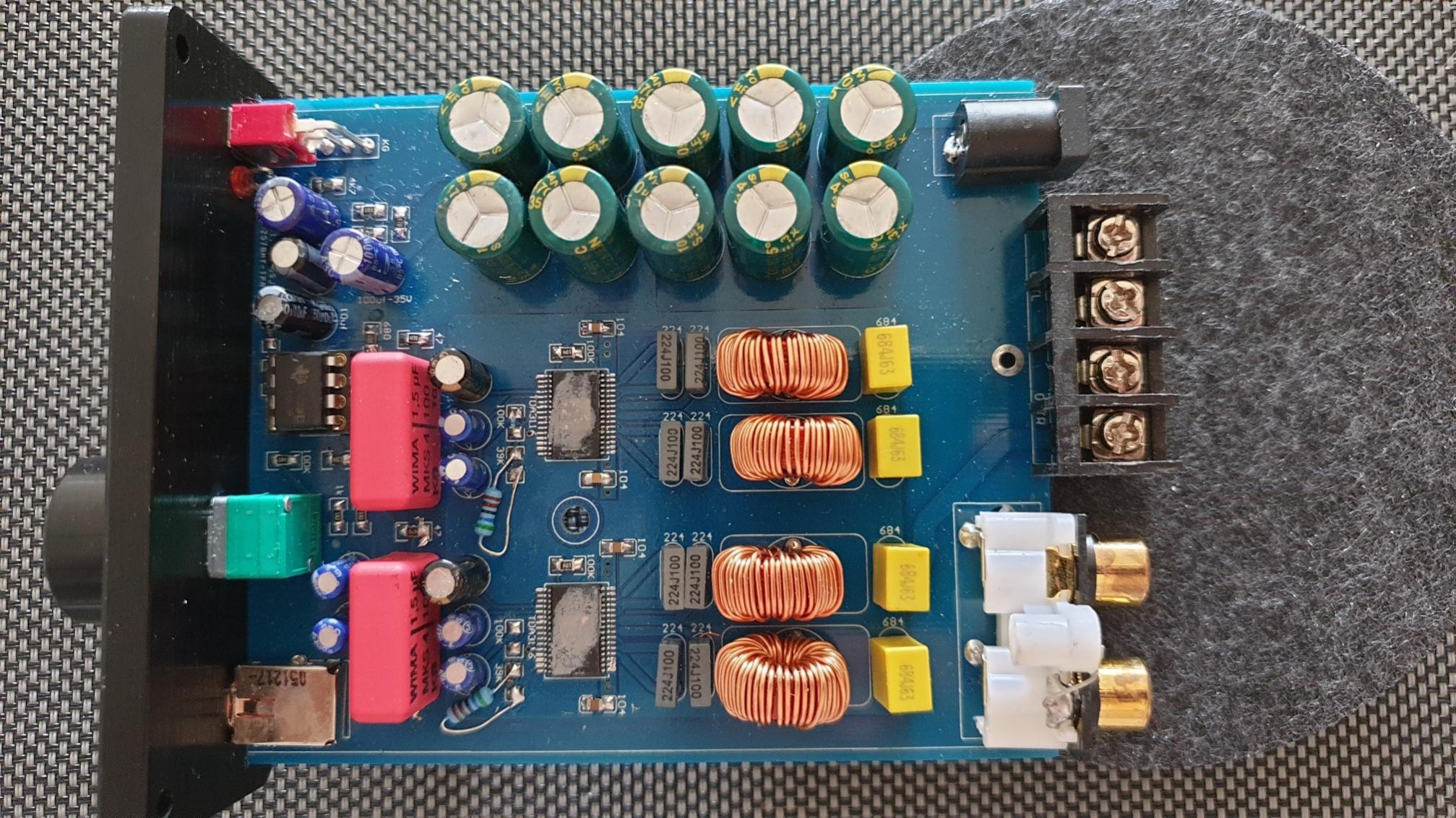

I did some modding to my XH-M590, reduced the gain and added some beefier PS caps, but found that at a certain sound level (reasonably high) I am getting some distortion. I have just removed the 1k resistors suggested a few posts back from here. The sound is very good until I get to a certain level and the distortion intrudes again. I have tried both 12v (1A) and a 24v supply (5A) and the results are the same,
The only thing I can thing of looking at now are the input caps, but am not sure which ones these are. There are 4 blue MKT type caps near the RCA sockets, but there are also some SMD caps in that area. Any ideas chaps?

Hi.Can you post a photo of your board first?
A 12v (1A) psu is suited only for low level listening volumes.
What is the impedance of the speakers you drive?
Maybe you overdrive the amplifier hence distortion is normal or u need a more current capable psu.
If these 4 blue MKT have a value of 1uF,better change them to 2.2uF wima.they fit there nicely if your PCB is same as mine.

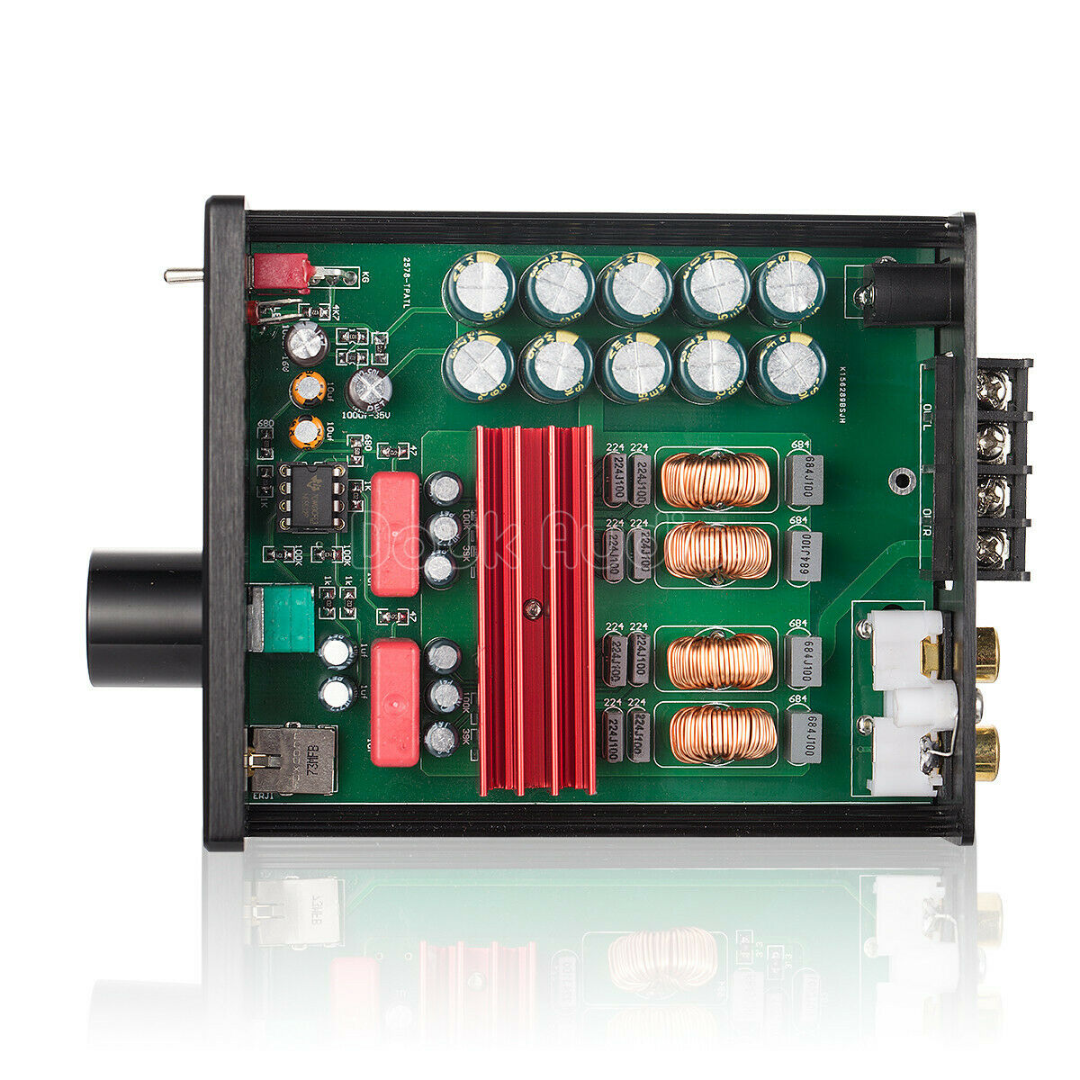

Hi Maouna,
It was not easy to find the board but finally it was there.
I checked with my Ohm-meter and you are RIGHT, there is a 1K and a capacitor across the input! It should not be so and my first intuition is to remove the 1K and the capacitor (from each channel). Perhaps it was a layout mistake or perhaps they were added in desperation over hiss.
I use my TPA6120-based headphone amplifier for input and that one can pull almost anything so I didn't notice.
Well spotted! Unfortunately another board that needs modification. Is that why the board suddenly became so cheap?
I haven't got time to do the "modding" right now but I will report back when done.
I have removed the 1k resistors, but not the caps mentioned above. Do you know what happens if the caps across the input are removed?

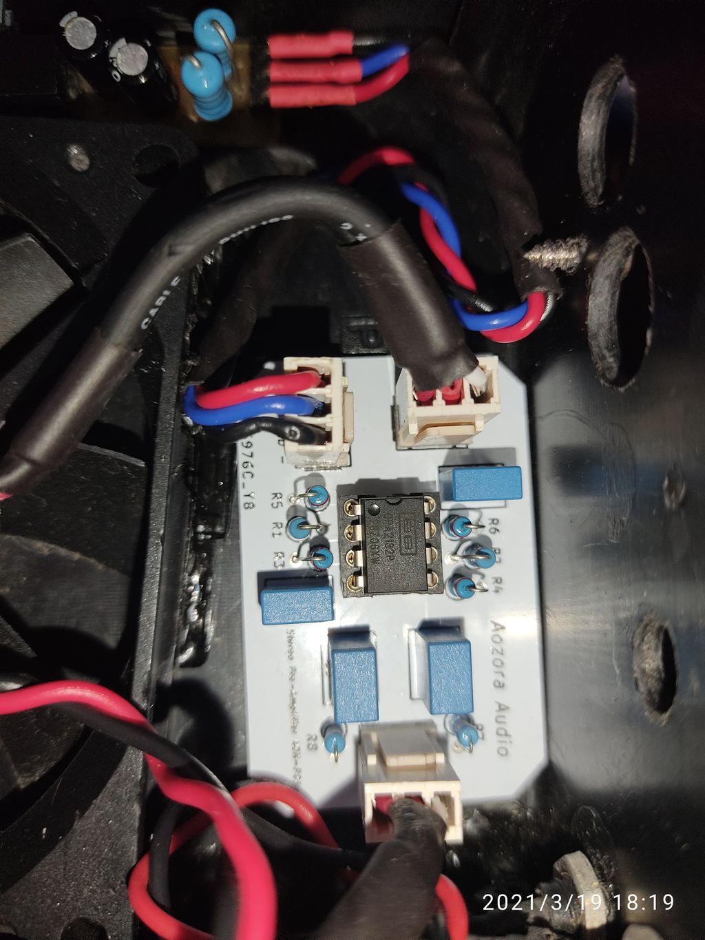

We have a different board. What is the purpose of the opamp in your board? maybe the problem of distortion and poor low frequency response lies somewhere there....can you design the circuit around the opamp? track the route of the input signal from the rca until it enters the opamp and goes out from the opamp to the input of the tpa3116
Thanks for your reply as well. Don't know exactely. Seems to be a similar question to the thread described here. There they write "Unfortunately, the F3 of the 1st order HP section is set at ~34Hz limiting low frequency. This is easily solved by replacing two 1uf electrolytic caps with a 4.7uf ones - same physical can size. That lowers the HP F3 to ~ 7hz." If I recognize the caps correctly it must be the 2x 3.3uF on the lower left.
Honestly, I'm not able to fullfill your recommendation and "track the route of the input signal". Don't have enough expertise to do so - and probably not enough measurement equipment

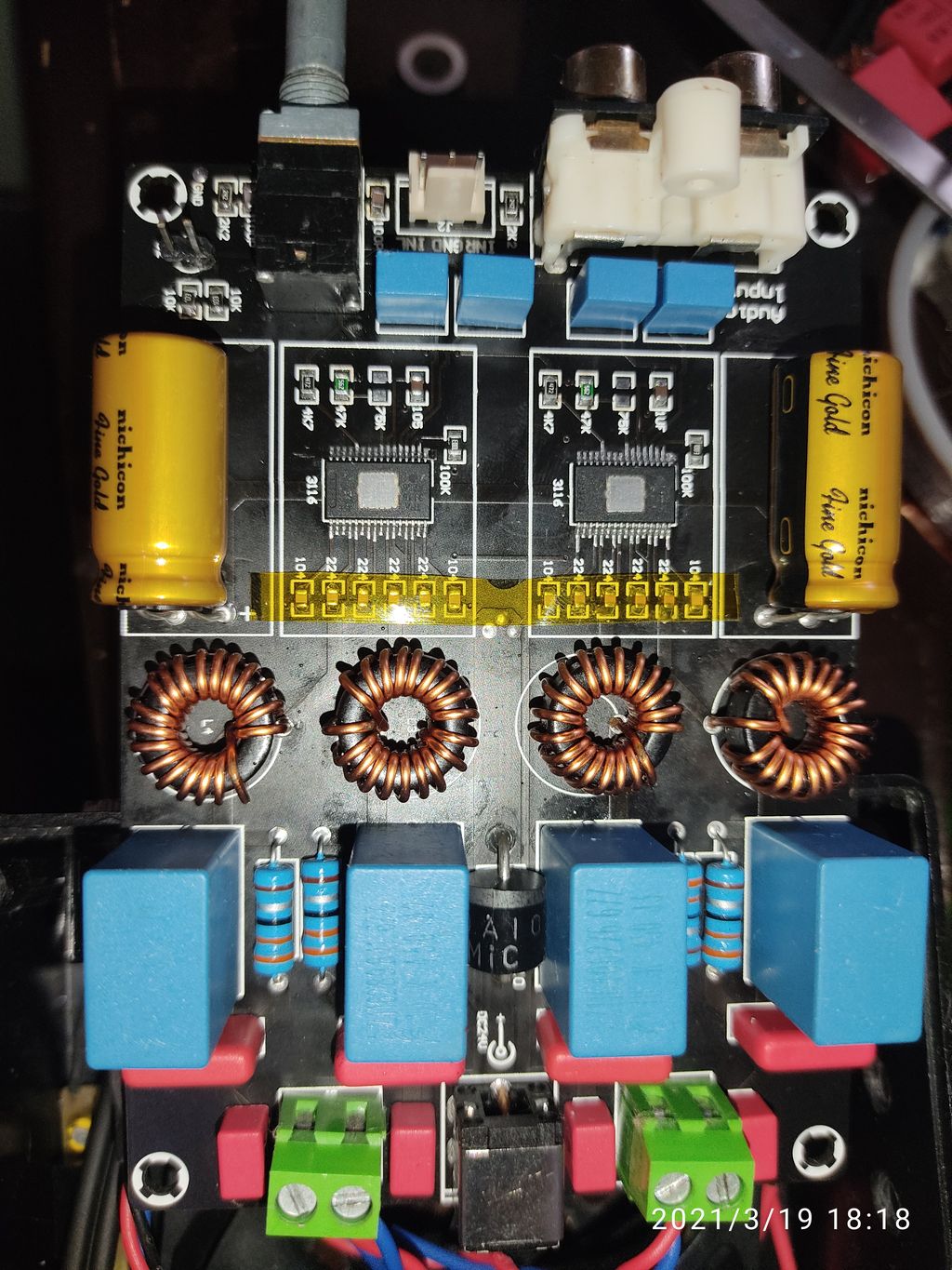

I finished my Desk amplifier, I will only change my PSU to a MeanWell one now as mine seems to consume too much idle power, some pics attached.
My board is the Aiyima one. The bad thing about it is not having a screw mount heatsink, but I got some plaster to put on it.
List of mods to the board:
- Input Caps changed from 1.5 uF to 1uF 63V Epcos
- Output filter cap changed from 680nF to 1uF 450V Epcos
- Bootstrap capacitors changed to higher quality Wurth Ceramics (220nf)
- DC caps changed to Nichicon FG 470uF/35V
- Pot changed to better quality A10K (from the B50K included)
Besides those, nothing else was changed. The white board in the picture is the a simple non-inverting amplifier with a OPA2132P I developed, nothing special about it. I made it tiny to fit in that space.
No hiss, no pop on/off, just as I wanted.
Cheers @FauxFrench for helping everyone a lot
UPDATE: I have finally solved the problem of distortion at higher levels. I had previously tried a more powerful PS as mentioned above with no improvement. I have now made a regulated stiff 24v PS. I had some Teddy Pardo Regulators lying around from years ago so I used these. So, the only thing left to ask is about the SMD caps near the input. I have removed the 1k resistors and wonder if there is any point in removing these caps?
I've been using 24v Industrial PSUs for a while, but man, my old one was bad and I didn't know how till now.
I just received my Meanwell PSU, seems like an original one as all components are well put together and seem original. The difference in sound quality, just from changing the PSU was noticeable. There is actually even less noise now, even with the pot turned all the way up, there was a small bit of hiss at maximum volume with the previous PSU.
I previously had one of those cheap-o chinese ones, two actually. One of them blown up out of nowhere and I think the transformer got toast.
Anyways, I just noticed while looking at my pictures I have those resistors/caps in the signal path. To be fair, I'd rather remove ceramics from the signal line as much as possible. The Bootstrap on my board would require those TDK MLCCs which I can't get right now.
Did you just remove them or shorted?
I just removed the 1k resistors.
Thank you Puffin, I removed them.
I did take out the ceramics as well. My board had 2k2 resistors and 100pF caps.
There is definitely more volume now
