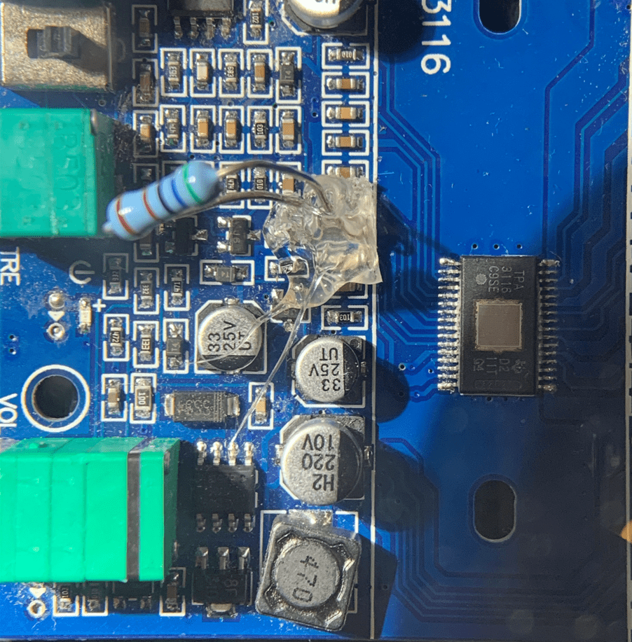

Hello,
I read quite a bit of threads online and saw that you are very polite and understanding, so i decided to ask you a very common question that i'm sure you answered 100 times.
I bought this 2.1 Blutooth board from China and i'm quite pleased with it, but there are some problems.
TPA3116D2 Bluetooth 5.0 2.1 Channel AMP
1) There is an awful hissing sound. I plan on fixing it with reducing the gain to 20dB.
As you can see from the photo i've marked the resistors connected to pin 7 and 8 on the chips. Right now the gain is set to 32dB and the subwoofer chip is set as slave and the L/R ship as master.
My question is: Do i have to change both the master resistors to open+5.6k (as per datasheet Table 1) and the slave resistors to 51k+51k (to set the gain to 20dB too) or only the master chip resistors and leave the subwoofer (slave) chip set to 32dB gain?

Yes you'd have to replace both sets of resistors. Changing only the master set will put master at 20dB of gain and slave will remain at 32dB.

@Trileru so I got around setting my amp's gain to 20 dB, but before I do that I tried running the amp with absolutely no gain resistors (open circuit), surprisingly the amp ran fine? and there was almost no audible hiss, makes me wonder what happens If I set no gain resistors, but also how would I know if I have correctly soldered the gain resistors haha.
Depending on your source that may work or not.
Those resistors set the input impedance so it's a good idea to have them to spec for a known good input impedance. You might have issues with frequency response based on the resulting input impedance and the coupling caps values.

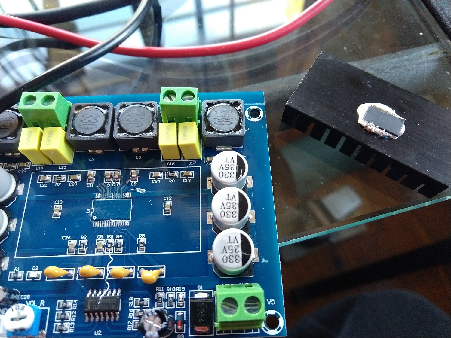

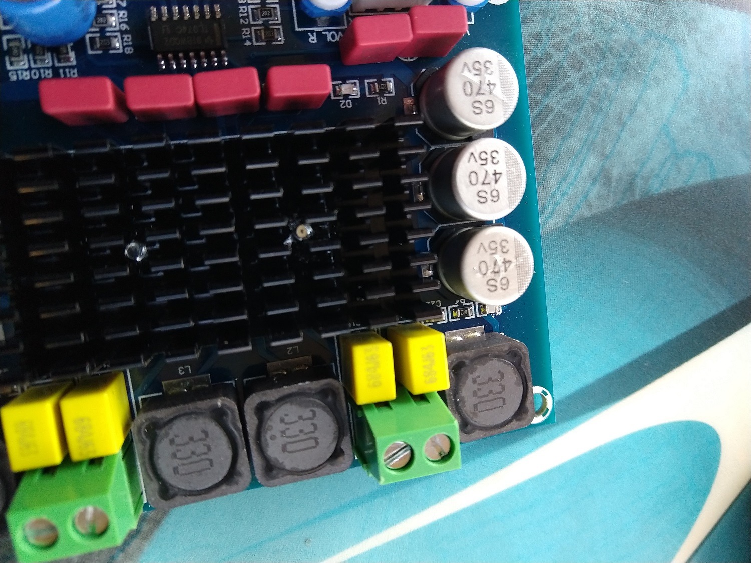

I have played with a bunch of TPA3116 boards. I usually replace the existing heatsink with a larger one and use silicone to glue the heatsink on. A twist on the heatsink breaks the silicone glue very easily.
I am currently playing with another TPA3116 2.1 board. The heatsinks are removed to make changes on the board. It hasn't gone into thermal shutdown yet. Power supply is 22Volts. Sub is 4 ohms.
maybe it wasn't silicone. Try a razor blade between the heatsink and the chip, if there is room.

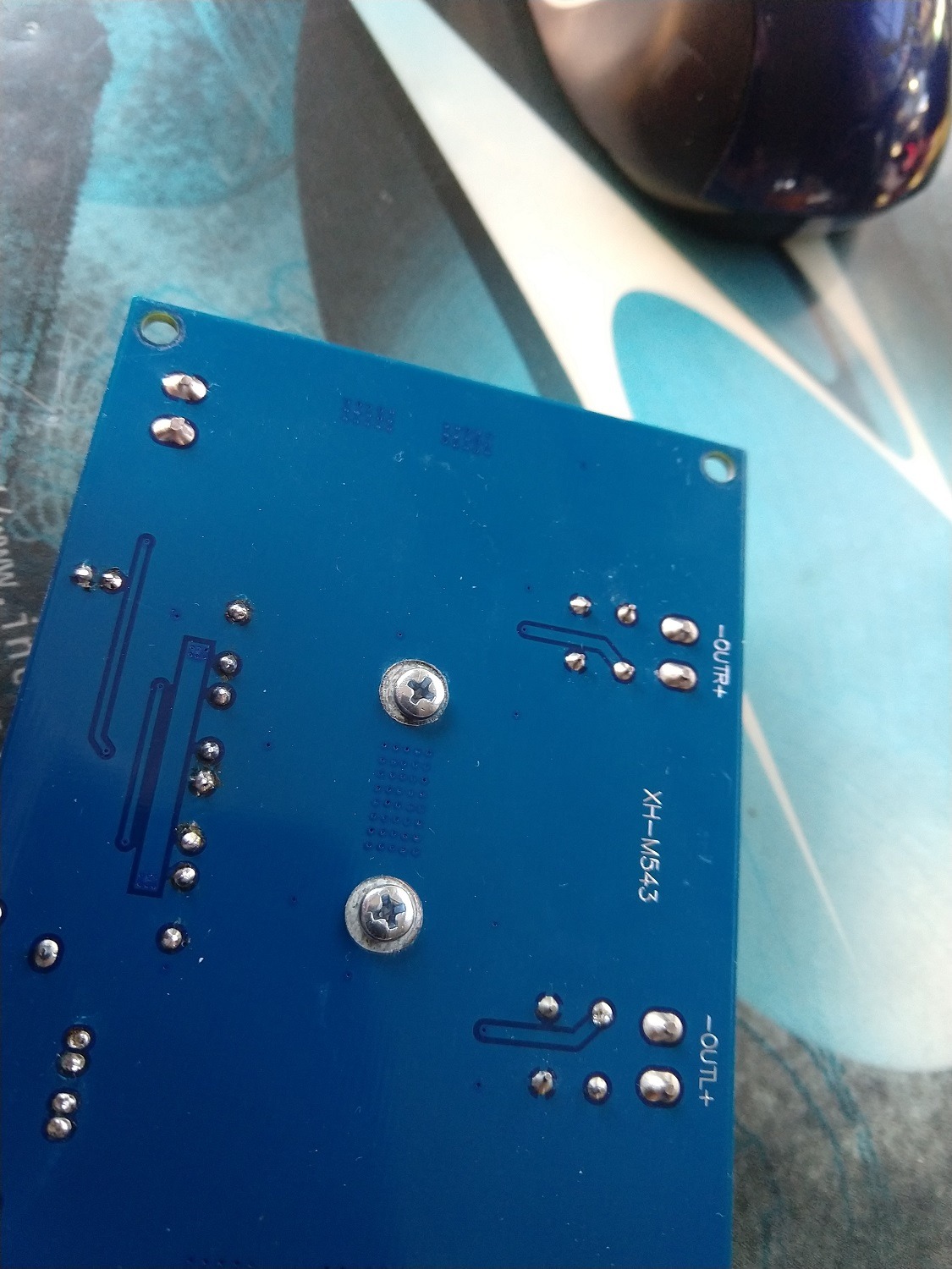

I drilled some holes in the dead board for fun.......there doesn't appear to be any traces in the holes, other than the entire bottom plane of the board appears to be a ground plane. I can insulate the screws..........or perhaps glue on a smaller heatsink that still allows access to the components as you mentioned above.
I drilled holes .400" from the centerline of the chip on a good board (same place as the inner hole pattern above) and milled a spotface in the bottom of the board to get the ground plane away from the screw heads. Heatsink was tapped with 2.5mm threads. Amp works fine...no issues.
