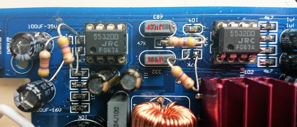

The standard approach to this is to leave the resistors and change the caps (of course, you can do it by changing the resistors as you indicate).
Pick two caps from available values to balance two factors: (1) The Fc or cut off frequency; and (2) The Q of the filter.
With the original 47K resistors, and selecting standard value caps: Change C1 to 33nf and C2 to 47nf (top cap in photo). This gives you a Fc of 86hz and a Q of 0.6. This places the 2nd order LP filter squarely between a 2nd order maximally flat Butterworth (Q=0.7) and a 2nd order Linkwitz-Riley filter (Q=0.5).
On my amp I went the other way crossing a 2.1 boombox with an Fc at ~876hz. Pre-modification, my Fc was 107hz. I've modified the amp twice, 1st was at 1073hz needed to go lower. For all three variations (original, 876hz and 1073hz), measurements validated the calculations.
But I'm confused, the original SMT resistors were 47K according to the silkscreen. The new axial resistors are also 47K? Was the board populated with different resistor values than the silkscreen's 47K designations (like the one polyester black cap: silkscreen 33nf, populated 68nf)?
No, the smd resistors I removed where marked 472 = 4.7kΩ
Hmm,I´m confused.
You mean those electrolyt caps marked C1-C2 on your photo?
Or C21-C22 as marked C1-C2 on the schematic?

Oh, that explains a lot. With those two resistors originally miss-populated with 4K7 and the two caps at 68nf, then the Fc of the filter would have been 500hz. As you say, useless for your application.
And we've all been confused (comes from me trying to squeeze in these posts during 5 minute breaks from work). The red C1, C2 are the designations in the standard filter equation (corresponding to C22 & C22 on the schematic). Here's a simpler approach:
And I had another error is my earlier post ... With the two axial resistors now at 47K and C1 at 33nf, C2 at 47nf, your Fc will be 98hz, with a Q of .7 (2nd order butterworth).
If you make both caps 47nf, then your Fc will be 72hz with a Q of .5 (2nd order Linkwitz-Riley).
