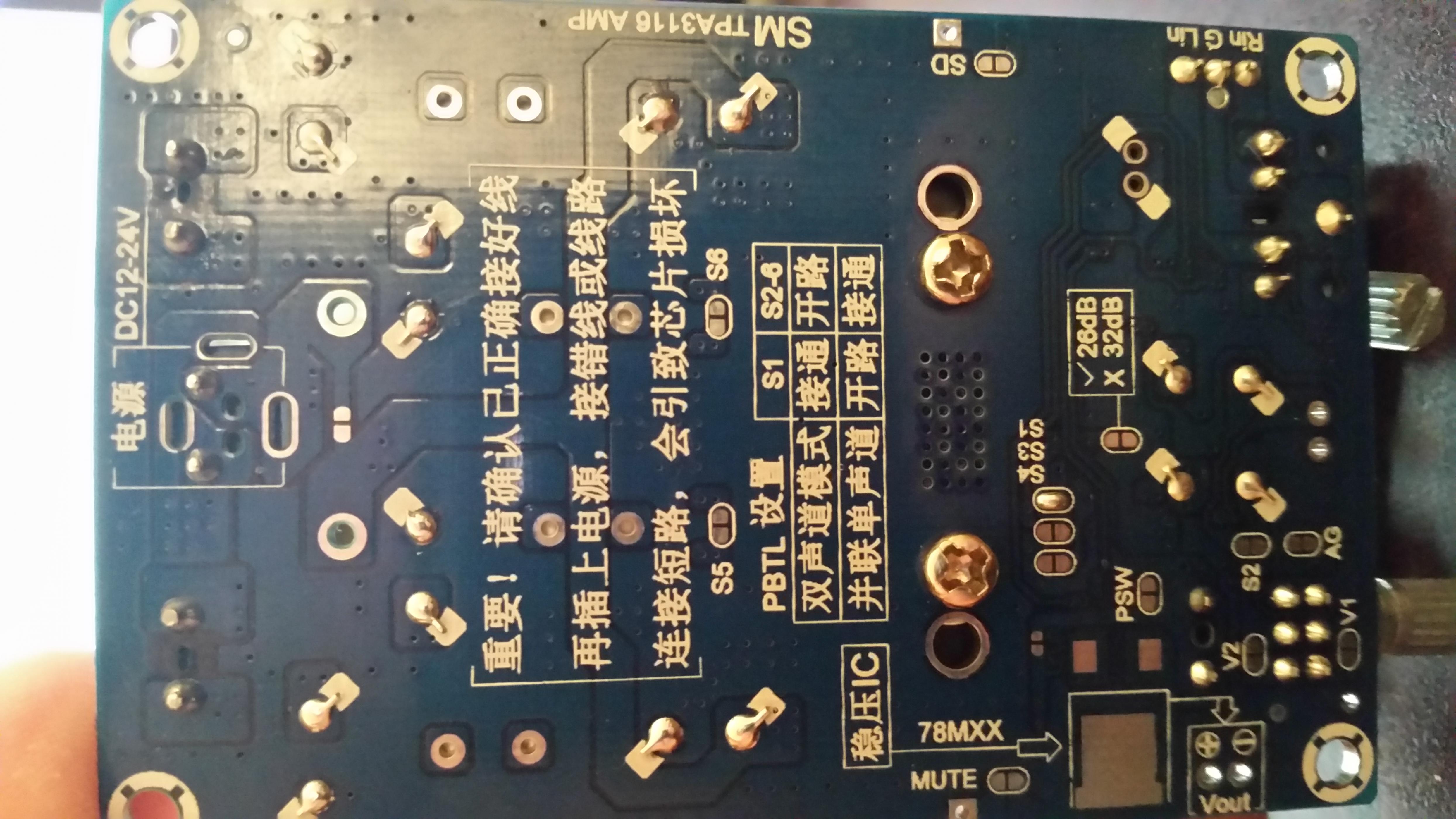

In the meantime, this showed up today. I have seen this version on ebay too.
http://www.amazon.com/gp/aw/d/B00KC...smakn+3116&dpPl=1&dpID=41PVJ5+tJuL&ref=plSrch
It has some interesting features, variable gain, PBTL option, bypasses for the volume pots and power switch, Shutdown and mute broken out, and space for a DPAK 78Mxx IC. Sounds pretty good too.
Yup. This is one of the better ones. I have this one about a year ago (I bought directly from the "manufacturer" (TPA3116??????12-24V??????/???????????-??????). Sounds fine. This is a newer version and has more features built in. Probably the "best value" among all the boards available, all things considered. Looks like the power on LED is removed. It is very bright. Enjoy!

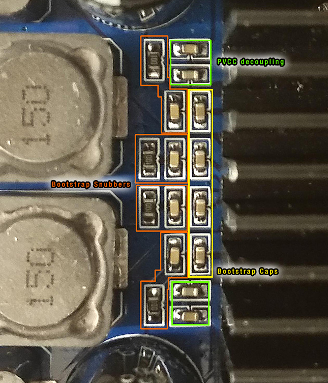

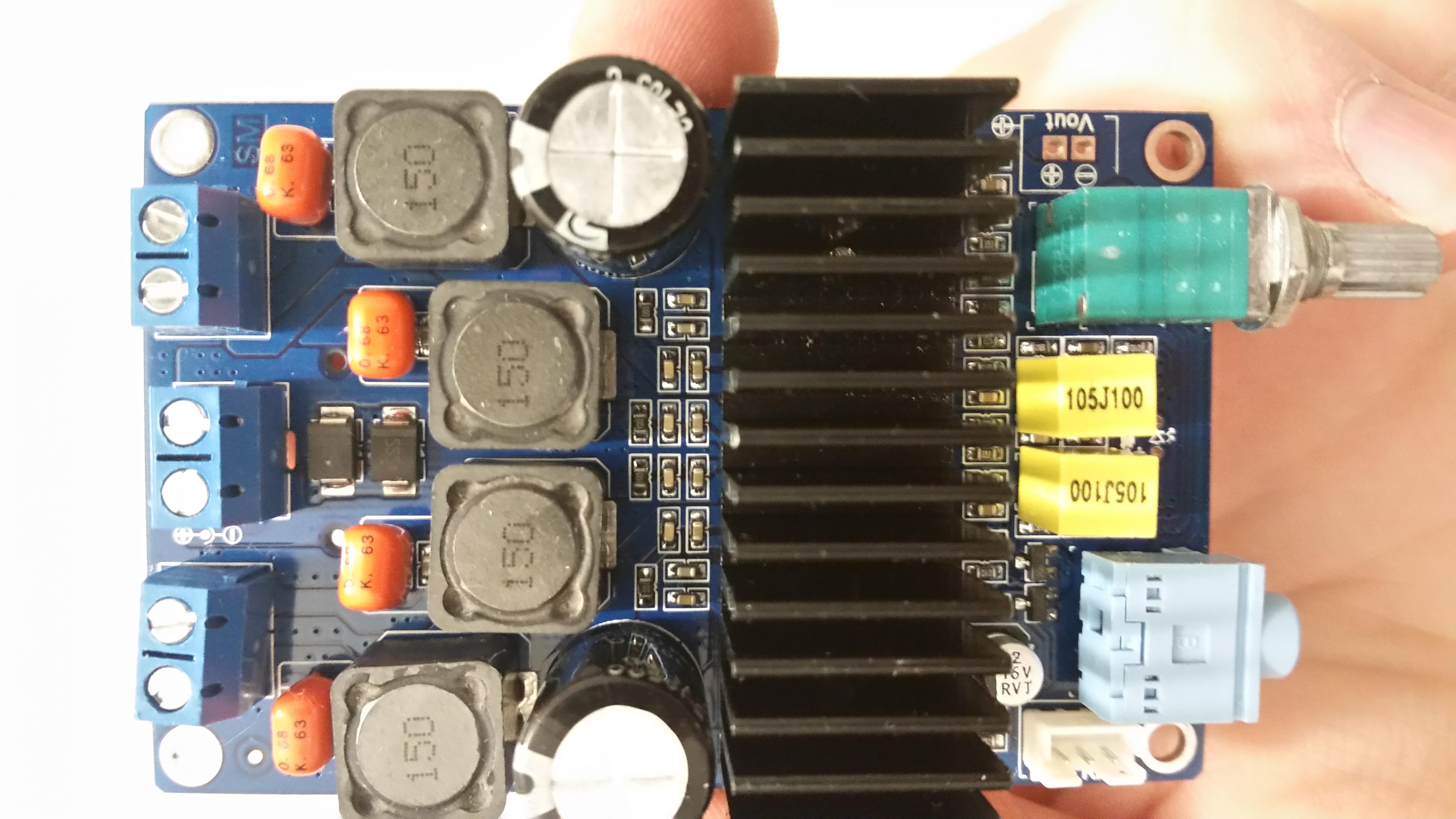

I have the same amp - the "SMAKN" with lots of options. Sounds fine too as Lo Tse has said. It does concern me that they skipped the output snubber - there is no resistor and cap snubber after the main LC filter. This might mean some noise from the "dead time" between the transistor switching on and off as Irrebeo pointed out in the 3118 thread.
Interesting choice of 15uH inductors - a compromise between 4ohm (10uH) and 8ohm (22uH) output impedance?
