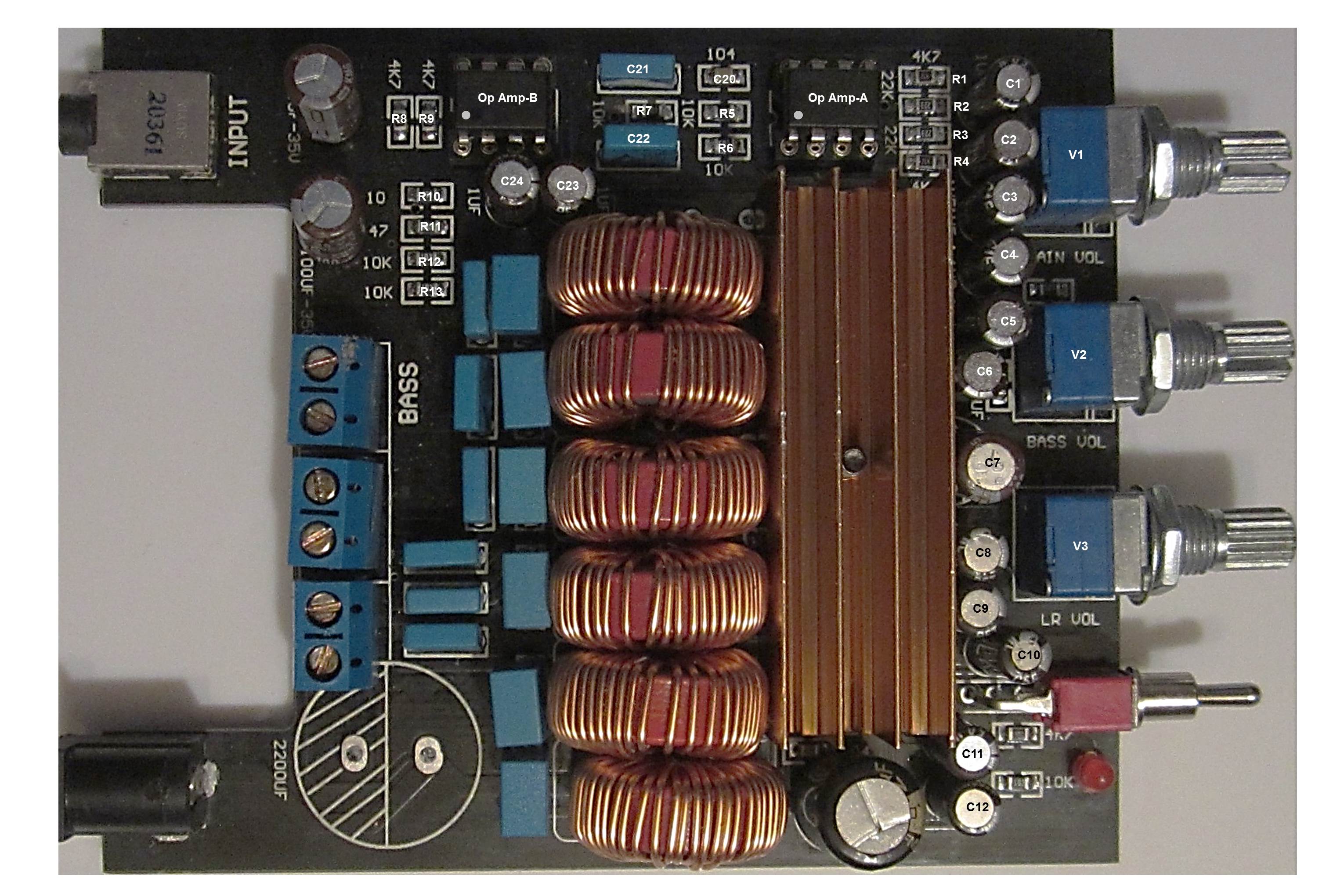

Oh, sorry, I meant the rectangular polyester black caps, not the round cans. The 1uf cans are simply bias resistors between op-amp stages (to mitigate any DC offset). The two polyester caps are the caps that determine Fc of the LP filter.
BTW: the two 4k7 resistors that you replace in the photo, one is in the LP filter circuit, the other is a DC bias resistor for the Op-amps.
The graph shows the LP with an Fc currently between 200 and 300 hz. I presume this is post your resistor modifications.
Can you take a photo, much like above, but showing both op-amps and the all 4 resistors you replaced?

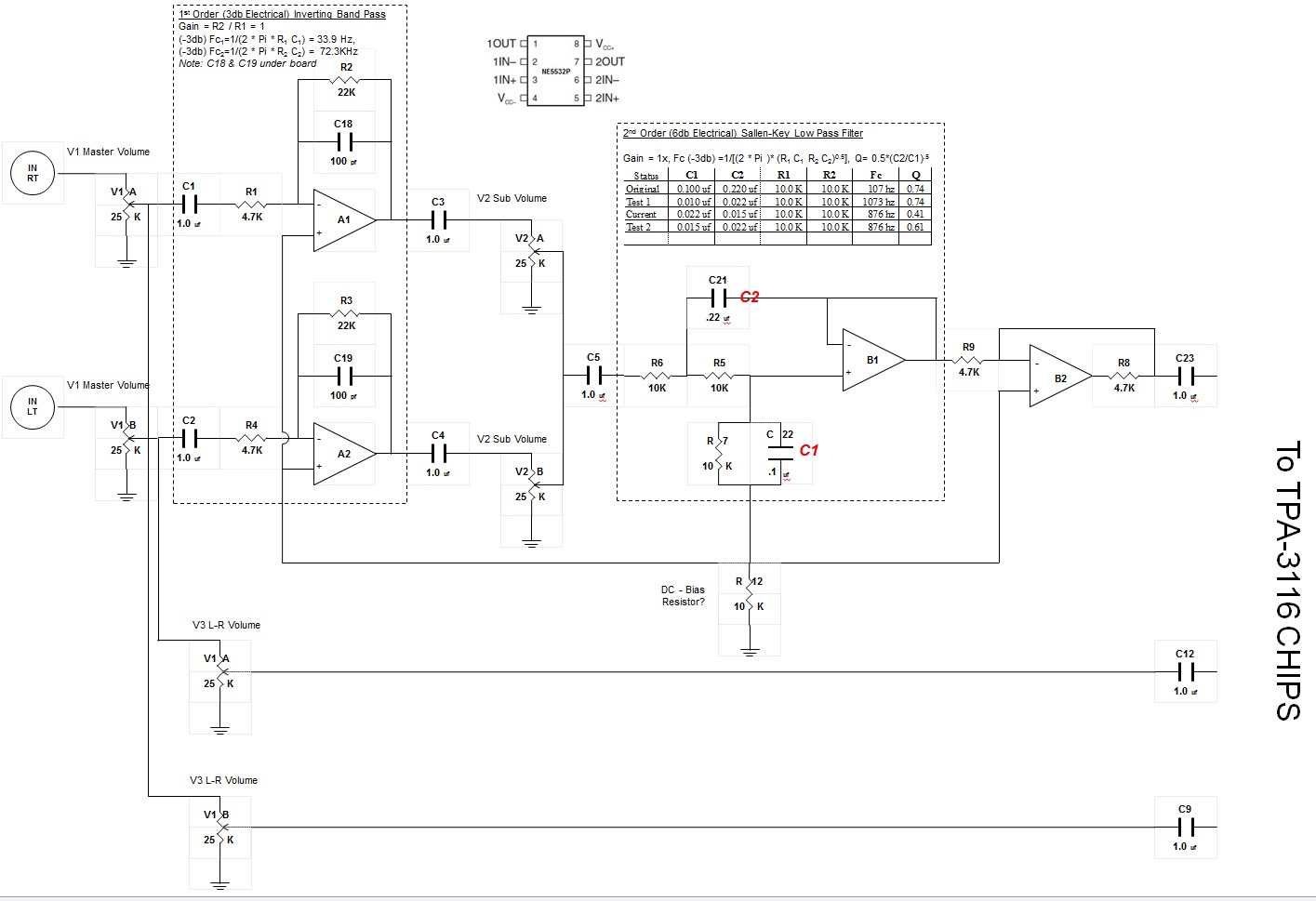

Ah now the first opamps have considerable gain by virtue of their feedback Rs being 22k. Is there a reason for this?
If this schematic better reflects the 'reality on the ground' then both 4k7s and 22ks are best swapped for 47k. I can't see a point in having gain in the input op-amp.
There's no gain on the input op-amps (there's no divider network to ground). The resistors/caps are implementing filters with unity gain.

The top pic is the problematic board. This thread from the PE Techtalk forum describes the problem with the top board: two distinct amps, same problem on both. The bottom pic is an alternative similar to one I suggested as it doesn't use the same Bluetooth daughter board. But no info/feedback on that. Not sure if the original poster from this link will report back on the alternative board or if he's given up on bluetooth (see post #5 for the link to an alternative board on eBay ~US$34):

Referencing my schematic and amp legend in post 8881 ...
The two modified resistors on the left (R8 & R9) are buffer resistors between op-amp stages and the TPA3116 input on it's PBTL sub channel. I'm guessing that the TPA3116 on these boards is set to 26db gain which, according to TI, makes its input impedance 30K. By increasing the resistor from 4K7 to 47K, you may have reduced the overall gain as the amp input becomes more of a load to the 47K resistor, perhaps not noticeable.
The other modified resistors are the two resistors in the sub's 2nd order Sallen-Key LP filter. Prior to modification, I read two 47K resistors, a 68nf cap and a 33nf cap per the board silk screen. This would put the Fc of your LP filter at 72hz. But it looks like both caps were populated with 68nf caps. That would put the filter's Fc at 48hz.
Now you've replaced the two resistors with the same value (47K) or is the "Orange" color band actually red. That would mean you replaced both 47K resistors with 4K7 resistors. You have two 68nf caps and your filter Fc would become 498hz. And your graph from an earlier post looks like the filter's Fc is ~500hz.
Lastly, it's not a good idea to mod the resistors as you've done. The leads act as little antennas next to the high frequency switch of the digital amp. So if you can put the original SMT resistors back, I would change the LP filter caps (the black rectangular polyester caps) to achieve the cut-off Fc you desire. Using two 33nf caps will put your filter Fc at 98hz with a filter Q of 0.5. This is a Linkwitz-Riley 2nd order LP filter.

Then ofcourse you are right, the mods I did was only for the sub channel.
It must be some break in time in the stereo channels that fooled me beacause it sounds better now, not so harsch.
I have an EQ board 24db/octave 80hz wich I will use somehow.
Maybe possible to do an jumper and feed it to the subchannel?
Your bracketed text makes me think that you believe the absence of a divider network means the opamp's acting in unity gain. Well - this is only true for non-inverting configurations, inverting is different.

You can change the cutoff frequency of the sub channel to suit your horn. It would need probably only 2 resistor changes. However we have so many apparently different versions of the schematic now its hard to work out which is the correct one.
Inverting Operational Amplifier - The Inverting Op-amp
You are correct. Sorry, I was just so focused on the sub LP filter which does not have gain. The gain on the audio bandpass is 4.68x.
The standard approach to this is to leave the resistors and change the caps (of course, you can do it by changing the resistors as you indicate).
Pick two caps from available values to balance two factors: (1) The Fc or cut off frequency; and (2) The Q of the filter.
With the original 47K resistors, and selecting standard value caps: Change C1 to 33nf and C2 to 47nf (top cap in photo). This gives you a Fc of 86hz and a Q of 0.6. This places the 2nd order LP filter squarely between a 2nd order maximally flat Butterworth (Q=0.7) and a 2nd order Linkwitz-Riley filter (Q=0.5).
