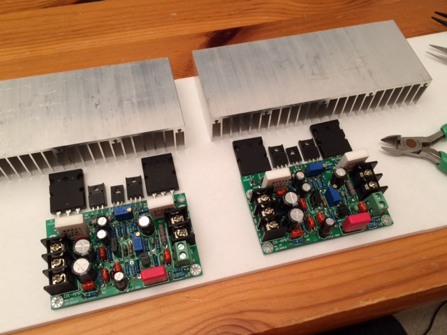

Sorry for the OT post, but just wanted to say I forgot how much fun (and easy) soldering thru-hole components can be compared to SMT's. I just completed a pair of 70w Class AB amps (the DX amp). Finished soldering these from parts in one night. Will setup and test another day. I have heard that these sound really good - we will see I guess.
