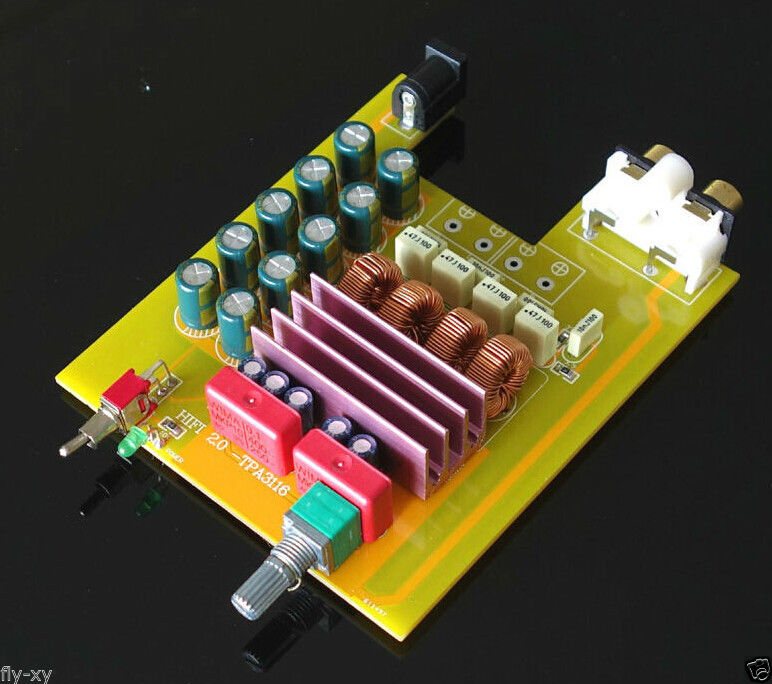

Prezen, I have that amp board. I have done a mini review on this board some pages back with pictures! The original caps are too far from the chip so upgrading them helps only a little. I put in better alu caps which helped to some extent. I suggest you take off the cooler fin and solder oscons directly onto/close to the chip to get true dynamics. Afterwords you could shorten the with of the cooler and glue it back on. I really love the mute function and the good output filter

I just read your post. That is a fantastic (and advanced looking) mod!
I think this amp really is a bargain and is easy to modify. I changed out the 10 DC power caps on the left side and replaced them with 470uF 35V Panasonic FM caps, I found it made a difference in clarity and noise reduction.
I tore out a trace on one of the little caps between the heatsink and the red WIMA input caps at the front, and i found it difficult to route around it so I gave up and went to work on other things in the meantime.

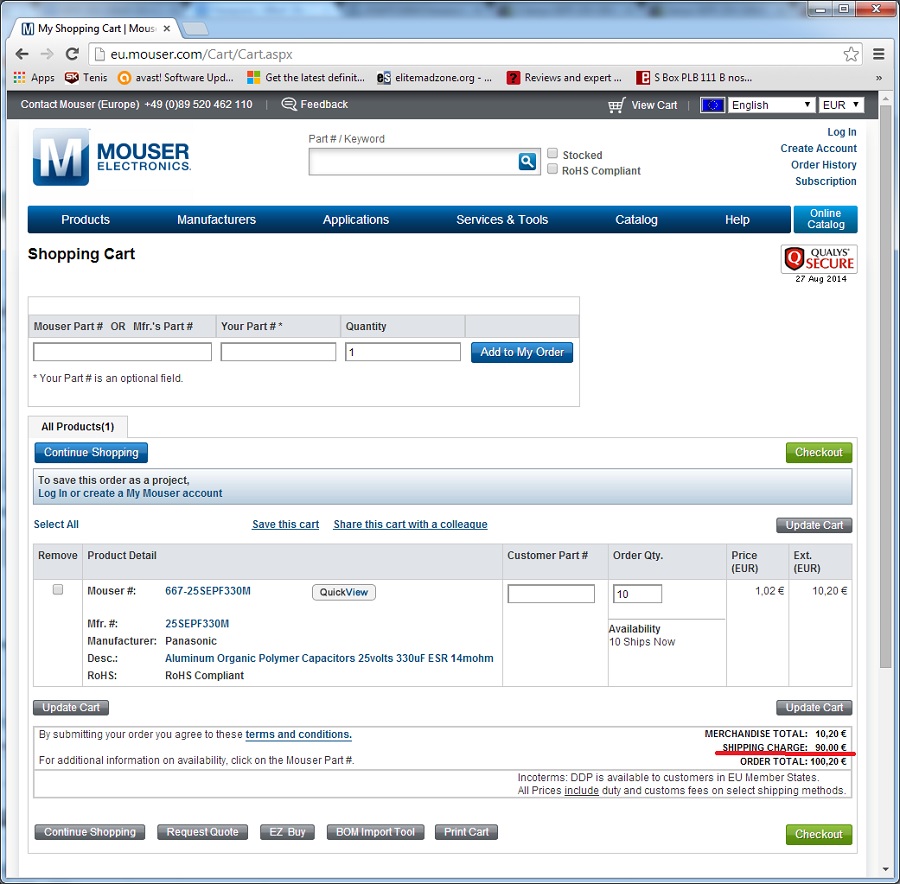

Where to buy OSCON's capacitors. Price in Mauser is 1.5$ and 90$ to send to Serbia. Nuts.
This are 2 peaces 7$
How about solder the oscon cap on those 2 104 SMD caps?
Try to contact Mikroprinc.Where to buy OSCON's capacitors. Price in Mauser is 1.5$ and 90$ to send to Serbia.
They work with Mouser
I just ordered 4 pices of OSCON's.
