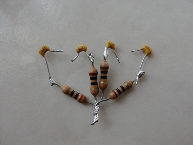

I did not like the prefilter snubber mod on my blue/black amp so I had it taken off. This is a picture of the parts I was using. Maybe it was a wrong parts selection ?
Parts look good, although are you using wire wound resistors? Those will change inductance of main filter. I use thin film resistors. Also make sure you connect the caps to the correct pins on the bottom side. What about the sound did you not like?
I was sure I connected them to the right pins of the caps on the bottom side, I read the pictures posted and verified on the board. Those 10R resistors were what I had on hands, I know they were not film but I don't think they are wire wound.
Anyway, few pages ago, I shared my experience with this mod that it seemed to have reduced the overall volume and over-tamed the sound. Maybe I'll get some films resistors and try again.
After installation check resistance to make sure you did not accidentally short to ground (scratched thru varnish). This happened on mine and I gif reduces volume and degraded sound quality too.

Did that too. There was no short at all. Don't know why my experience is inconsistent with everyone else.
