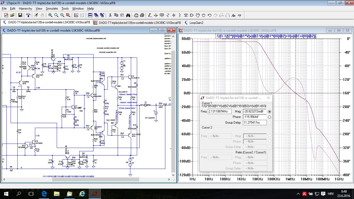

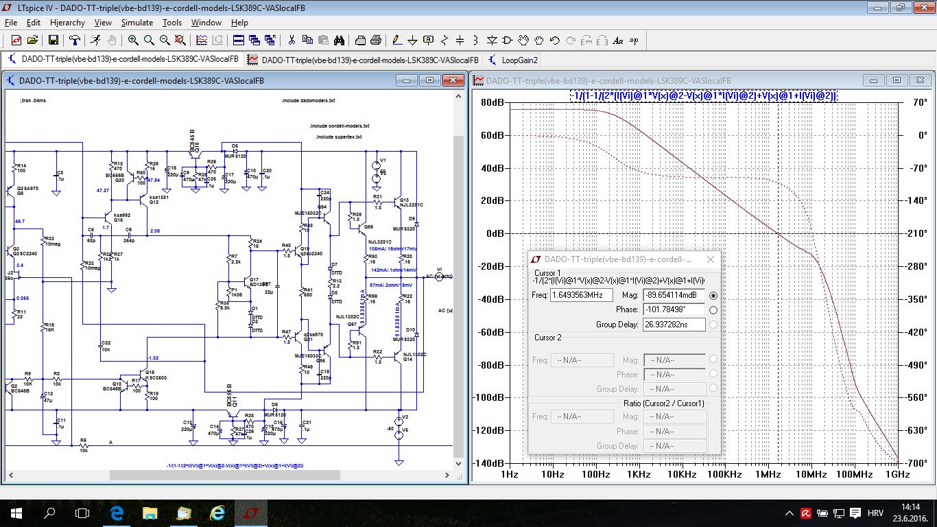

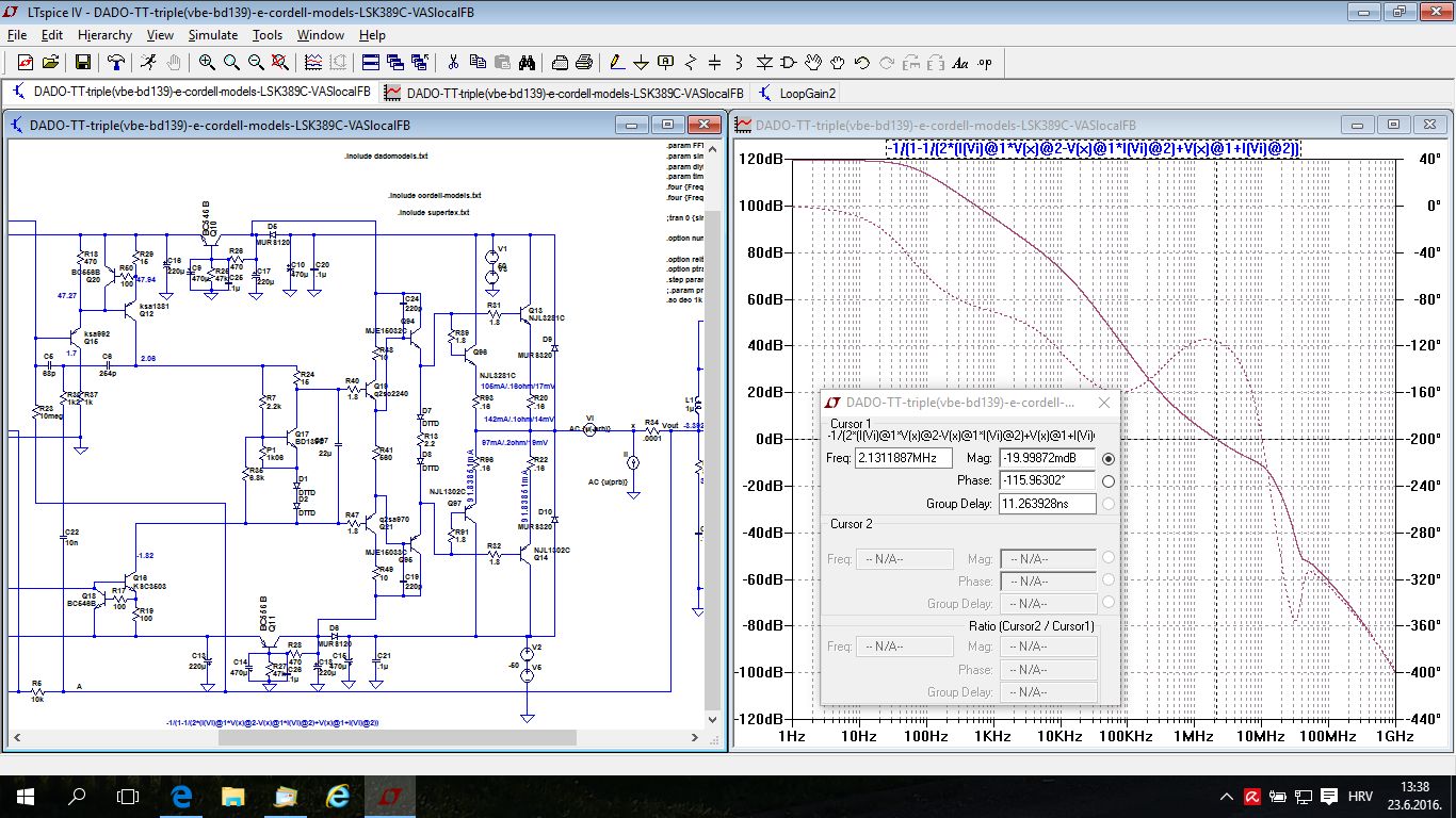

It all depends what you want to see. I wanted to see just global NFB without local NFB around VAS and OPS.
If I include local VAS NFB the plot is here.
Next plot is where both local VAS and TMC NFB are out of global NFB plot.
BR Damir
It all depends what you want to see. I wanted to see just global NFB without local NFB around VAS and OPS...
Of course, if you want to see any sub-path then have a look.
But what you plotted in the first example (post#597) does not provide any proof about the stability of the amplifier.
It's not really the "Global NFB", it just looks a bit like it.
The Global NFB is the sum of all feedback at the output.
When there are parallel paths then the feedback can split between them in any proportion, so just to look at one path provides essentially no information.
In your particular amp the path with R23 is very hi impedance so it makes little difference in practice.
But I do think it is important to understand the principle.
Even smart people were confused by this point in the TMC vs TPC debate, so I think we should be careful to show the correct way, even in examples where the practical difference is tiny.
So first example in post #606 is fine.
Best wishes
David

Hi David,
I have to disagree with you in some points.
You are correct in the TMC point as the TMC resistor should be connected before Tian probe, otherwise LG plot will show Miller like plot with to optimistic PM and GM.
I disagree how you interpret global NFB. The NFB around VAS - OPS is not global NFB. Resistor R23 will drop available global LG at low frequencies from 120 dB to 75 dB and keep it at this level up to 10 kHz(in this example) but will not change PM and GM. The plot (post#597) provides all proof about stability.
Best wishes
Damir
... how you interpret global NFB. The NFB around VAS - OPS is not global NFB...
Ok, perhaps the problem is partly the words we use.
I now understand what you call "Global NFB" but this is not a useful path so perhaps that name is not helpful.
The particular path tested in #597 does not show the stability of the amp.
In the worse case a multi-loop amp may require each loop to be tested individually, there may be no one test or measure of stability.
Then the whole idea of "Global NFB" may not even make sense.
But it is possible to simplify the tests of multiple loops if they satisfy certain conditions.
If multiple loops can be cut at one point then that point can be tested like a simple loop, the multiple loops are effectively in parallel.
This is true for the test point of #606 (first picture) but not of #597.
Bode worked this out way back before 1943 but even after I read his book it took me a while to really understand and be sure of this.
I have a more recent link I can search for, if you are interested.
Best wishes
David

Hi David,
I still don't get it, here is post #608:
Hi David,
I think I agreed with you how to simulate TMC Loop Gain plot and how to connect Tian probe.
Best wishes
Damir
It may be that I misunderstood what you meant, I will try to explain.
The TMC discussion was before my time but I think there was eventually a consensus that the outer loop Return Ratio was deceptive.
In other words, that we needed to place the Tian probe immediately after the OPS, before the feedback split into two paths (one for the TMC, one for the outer loop).
I think this is correct, essentially we check the inner loop.
I think the situation is similar for any nested loop, that we need to check the inner loop.
I have done some theory that confirms this, in fact I repeated the calculations when I couldn't easily find my notes. This was helpful because I did it a different way the second time and it was useful to have a fresh perspective.
When you wrote "You are correct in the TMC point" I believed that you understood that TMC required the inner loop to be checked.
So I could not see why you understood that TMC needed an inner loop check but considered that other nested schemes did not.
But now I reread the post and I am not sure what you meant, sorry for any confusion.
Best wishes
David
Best wishes
David
Best wishes
David
Hi David,
I think I understand now what is your concern. TMC is not only example where the way how Tian probe is placed inside the GNFB is important. Actually doesn't matter if it is TMC or other kind of compensation, it's important if some element of the compensation is connected directly to the amp output, like Cherry compensation or the compensation I used in my CFA amp, where a capacitor is connected from the amp output to the common TPC resistor (it looks as Cherry but I think that is unique or at least I never saw it in any amp or article). For all other type of nested NFB, TPC included, Tian probe placed in GNFB loop should show all data about stability of the amp in simulation.
If you are not in hurry with your article for Jan Didden, I can prepare this evening some drawing to make it more clear what I meant.
Best wishes
Damir
