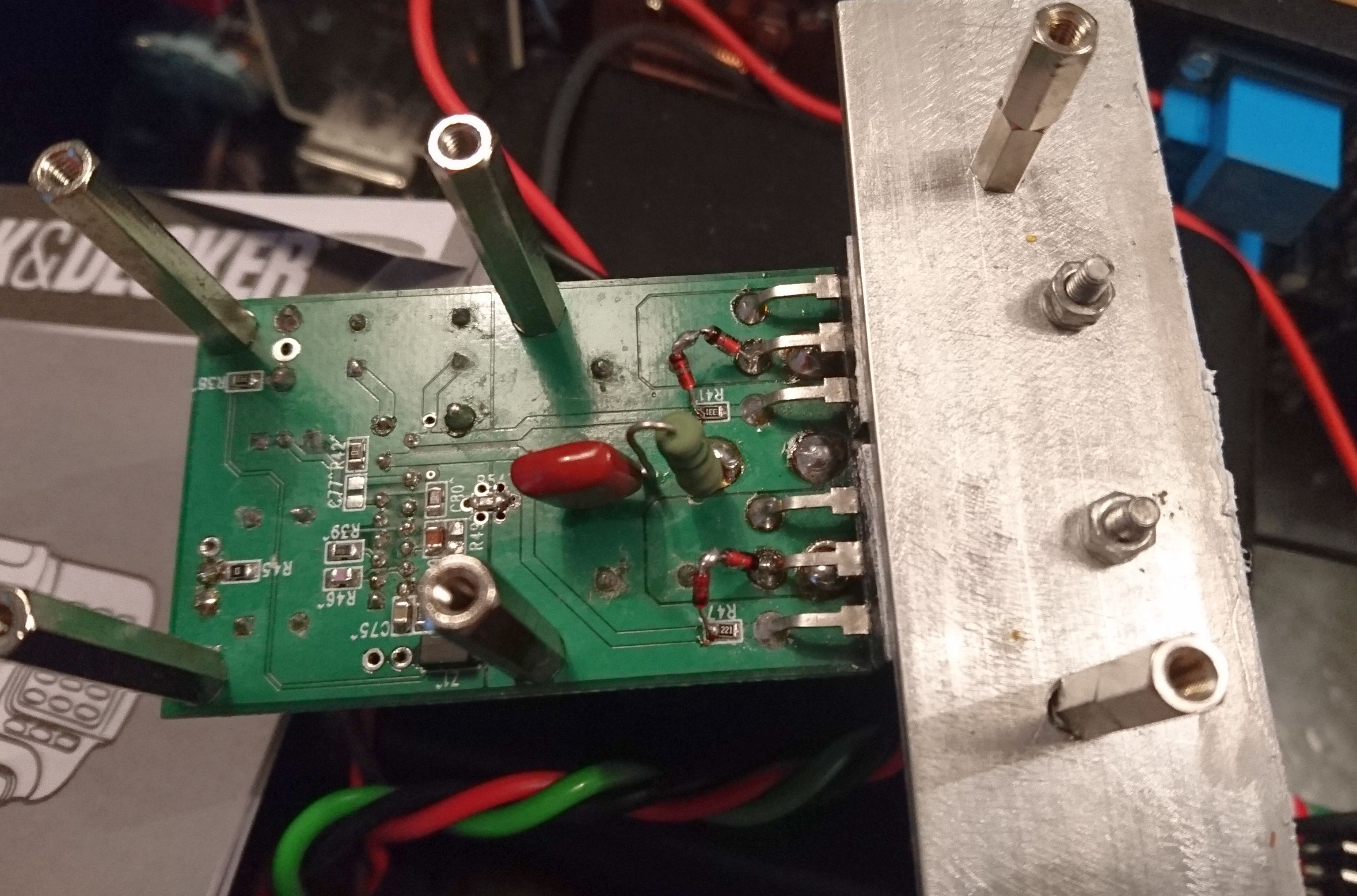

Are the vertical soldered transistors causing the problem? They are completely the same pcb's (ok, using 2200uF instead of 1000uF as main capacitors), but the transistors are vertically soldered to be able to mount them directly on the radiator. So not using an L-shape.
Are they to near to the "big" capacitors? I also use steal screws instead of brass to mount them to the radiator. Is that also a point of failure?

How long are the leads on the vertical transistors? Are they full length to allow for easy soldering?
If so, then that could well be the problem. Having each lead full length would add about 2" round trip to the sensitive G-S path, potentially causing issues. All my amps were built and testing with very short leads and the fets mounted horizontally with an L-bend right at the thin part of the leg.

Well, here a picture of my built.
I understand, but legs shouldn't be longer than using the L-shape.
Any interferences from the few mm transistors <-> caps?
I also tried to use a copper-shield between them, but no difference.
By the way... sorry for wrong information... the zobel halves the interferences, but it still stayes.

If the amplifier looks stable with horizontal mounted transistors but unstable with vertical mounted transistors the design is bad or on the edge. Try adding a 10 - 20 pF miller cap parallel to check if the oscillations stop.
Lateral mosfets are very prone to oscillations - every millimeter of wire counts in.

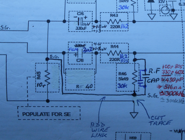

Input cut and link
Here's an extract from the lme49830 schematic showing where the Signal Return/Ground (SG) should be cut to separate it from the Power ground.
A new link needs to be added to connect R46 back into the Signal Return.
Before you cut anything check using an audible continuity meter which side of R45 connects to Signal Return and which to Power Ground. Check R46 as well. Once you have identified the two sides add a thin copper strand to make the connection. And cut the trace.
In addition there is no RF attenuation at the input.
I added an 805 NPO ceramic on top of R46, But I did not have the correct value, so I added another NPO on top of that to give a total Crf of 430pF
This combined with the 1k2 of R44 gives an F-3dB of 300kHz.
As usual I added a 47pF NPO ceramic across the input pins of the socket as it enters the enclosure.
The input comes in with 2M2||47pF shunting to SG, then passes through 2u2F MKT (C78) through 1k2 (R44) then shunts via 30k (R46) to Signal Return to go back to the input socket. I would have liked to use 3u3F for C78 but the 0.2" pin pitch and space on the tiny PCB prevented anything bigger and prevented using an MKP.
The NFB upper leg is 30k (R39), lower leg is 1k2 (R43) + 330uF electro (C76) for a gain of 26times (+ 28.3dB)
