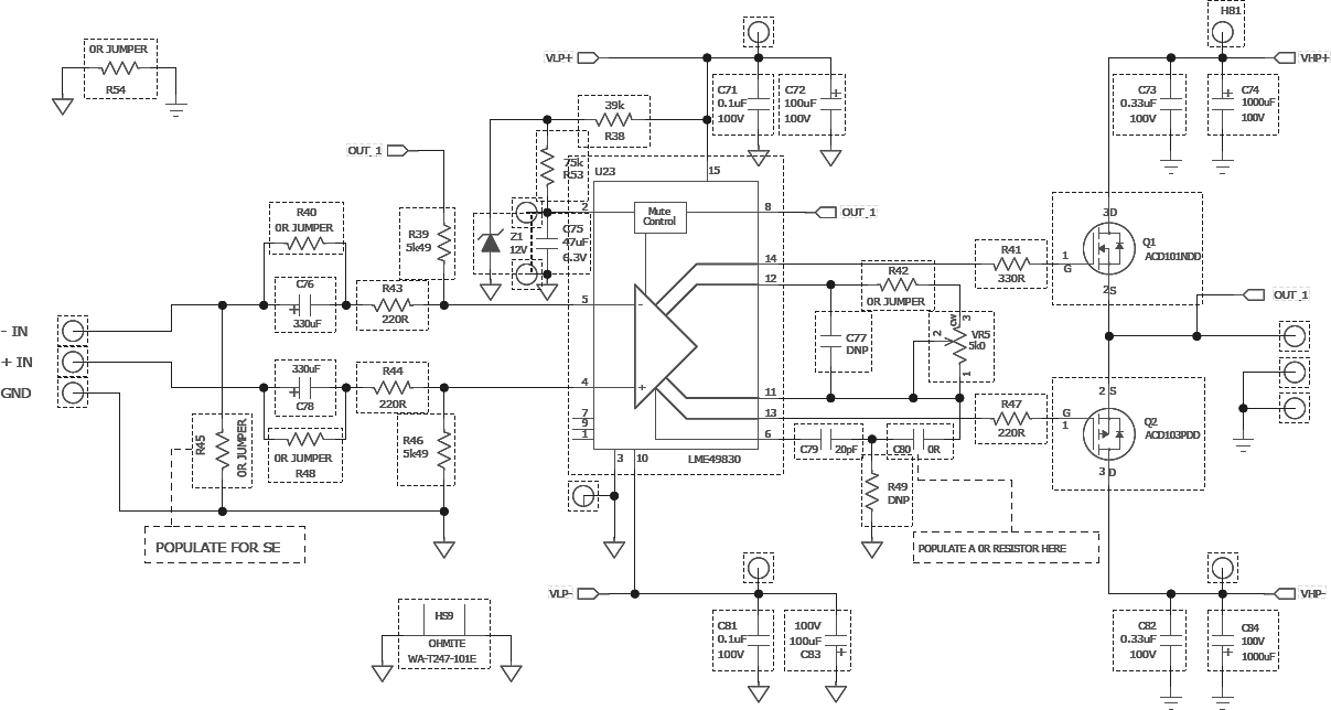

I just tried, and yes, same hum with only one amp connected. But I need to decrease bias to 150mA to turn off hum.
Like pos and neg also GND is connected by soldered 1,5mm wire directly, so I have no idea how the LME could have a GND issue.
One more hint... the signal is SE-connected, so inv is connected to GND onboard.

If it starts to hum immediately after a specific bias point it is very likely that the amp starts to oscillate hence draws more current from the power supply. HUM HUM
Try to increase the Miller cap!

I attach the sch that was issued for my green PCB.OK, so seem to be different PCB's.
and attach the sch dated 13/09/2011. This might be your white PCB.
There are component value changes and three more major changes.
R54 is removed.
The second Comp cap C80 is added.
The mute Zener is removed.
If your PCB has all these locations you may have the same PCB.

In the old green PCB, R49 is left empty and C80 has a shorting link. Leaving only C79 as comp cap.
Your Google drive is the old green PCB.
Did the 2011 sch come out after the white PCBs were issued?
The error between the PCB and the sch was around R46, R46, R54 and the traces to the signal return.
Because the traces are built into the multilayer PCB, it took a little detective work to come up with what in the end was a very simple modification to correct the error.
I used SE but changed the resistor values to make them more conventional for that style of amp. I did not want a 5k7 input impedance that necessitates an enormous capacitor to get F-3dB down to 1Hz to 2Hz.

OPC never accepted that there was an error.
