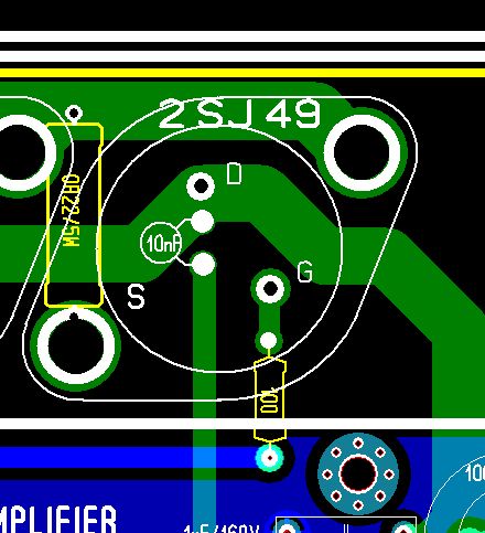

MOS FET terminal....
..... I think it's ok with terminal assigment look at the picture below .
Source resistors are on bottom side optional .:)
Alex.

Please take a look at the attach spec for ECF10N20. Alex is right with the pcb.
Alex, do you think you can send me the Sprint file? Tks.
Please don't keep asking about the source resistor. Post 1067 has shown how we can implement them even w/o changing the pcb. Alex had even changed it to show everything. But Alex, we still have to insulated the top screw as I had shown in Post 1067 right? My photo was a bit different from alex's drawing because I had a different orientation of the TO-3 (that was my super leach 8xTO-3), but the idea stands. Everybody is happy with the source resistor now?

Try to do it this way :
The line between G & D and the line between the 2 mounting screws makes a cross (not a +), the G is on the left when looking from top. Your drawing is right and so is alex's. the orientation of your drawing is confusing you. If you rotate your drawing to make the cross upright and do the same with alex, (angle of rotation is different for the 2 cases) you will see they are the same.
Right, I did not notice the position of the drilling holes at first. Sorry for bothering.

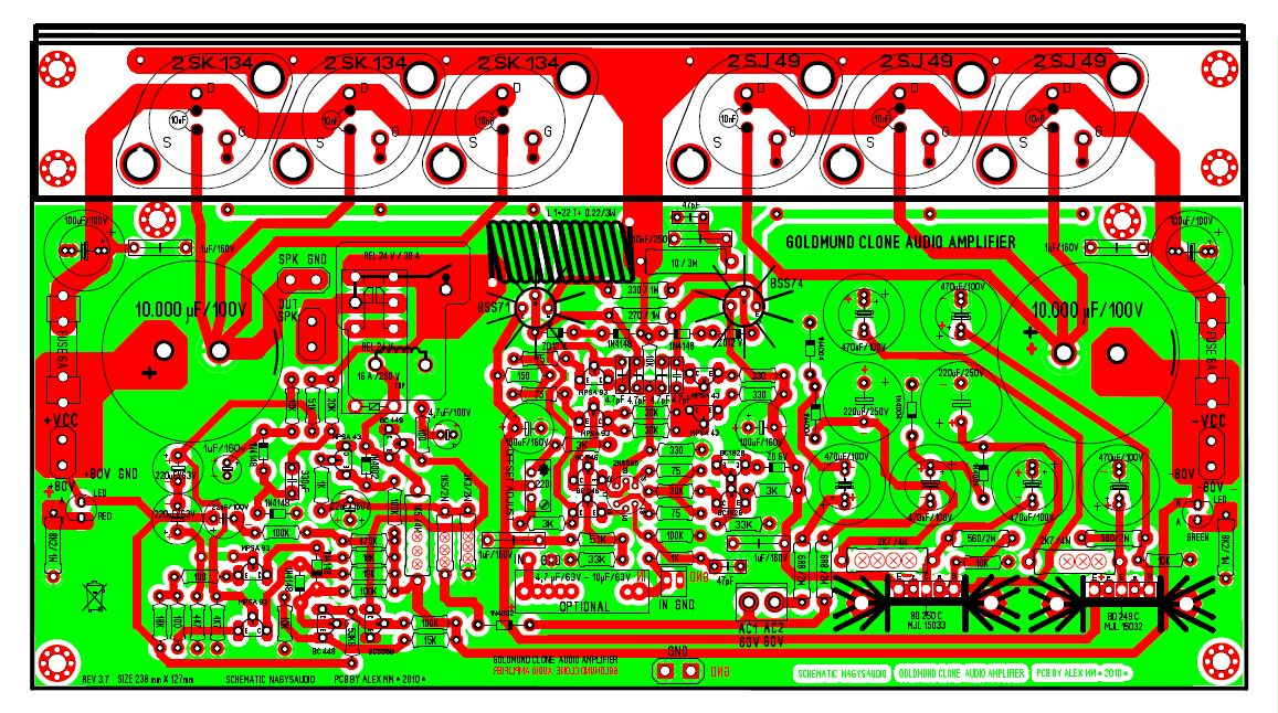

PDF files for PCB ...
..... files for top , bottom and silk screen in attachaments in PDF format :) .
I will send files in LAY. format to bigpanda .
Alex.
  • COMPONENT SIDE.pdf
The layout is finished. Anyone who wants to place a last minute order for the group buy, please go here and follow instructions in post #6: http://www.diyaudio.com/forums/group-buys/175296-pcb-order-goldmun-clone-18.html#post2353781
Please ignore the part regarding the protection circuit boards, as everything has now been incorporated into the main board. You'll need 2 boards (1 pair) in order to build a stereo amplifier. Once we get the boards, I'll start a brand new thread and everyone can follow while I build the amplifier step by step. I will list all the parts that I decide to use, sources where I got them from, and any minor tweaks/changes that I incorporate.
