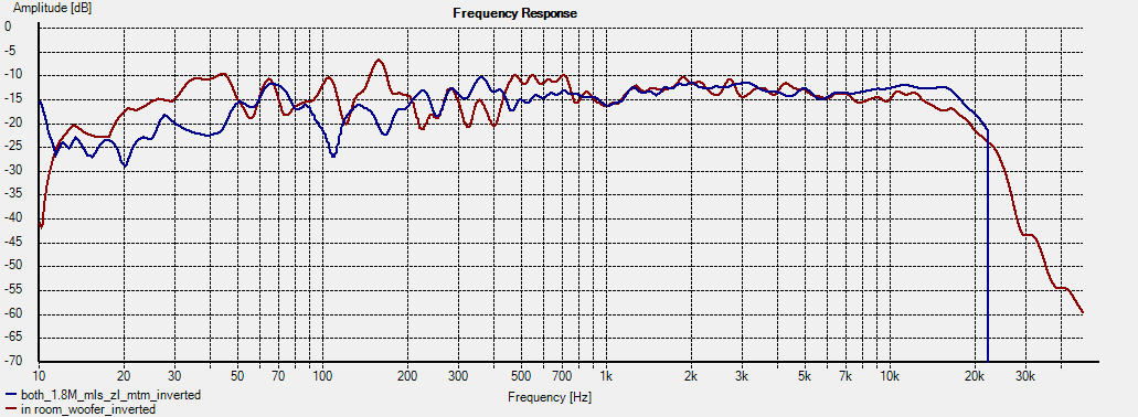

The passive crossover for the MTM I've posted here http://www.diyaudio.com/forums/multi-way/68301-my-morel-mtm-project-7.html#post2740332 The baffle step is in the form of a Notch filter (at about 1.2Khz) rather unconventional (when am I not) but does the trick nicely ;) It has a really flat response when out in the open.
post 140 in that thread http://www.diyaudio.com/forums/multi-way/68301-my-morel-mtm-project-7.html#post2776367 has measurements of the the completed crossover, and a comparison of the SIM'ed response compared to the actual.

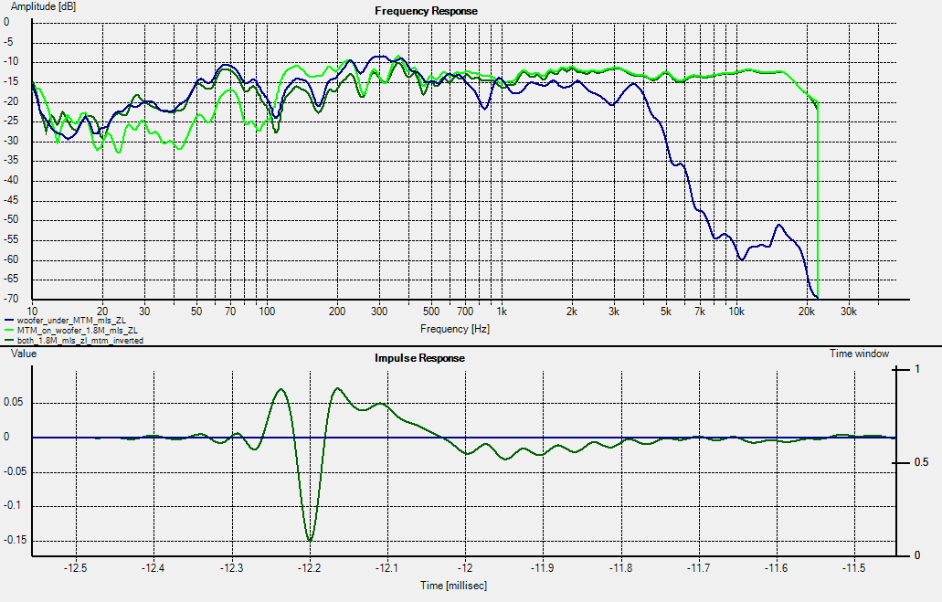

There is a bit of a hump between around 300 and 700 Hz in the mtm's in room response so I'm correcting for that in the crossover. It may be a dumb idea, maybe not. Perhaps I should try running the sim with the measurements I did outside and see what the result is :)
edit: added sim with outside measurements (ones that I wasn't particularly happy with) quite different, and if I tried to design with these then I suspect I would end up with very bass heavy speakers once room gain was taken into account.

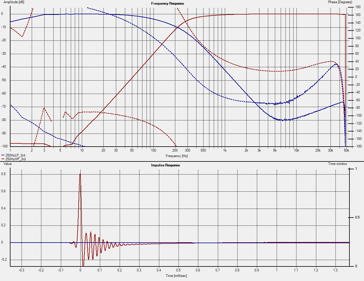

Well it's together... something is not quite 100% as the crossover point is coming in at 217Hz. I think that there is something wrong with my Spice sim, because the LP had about 3db drop compared to the HP in the sim, but the real world measurement shows virtually identical levels (within 0.1db (unless of course the default setting of the pot, coincidentally sets the levels exactly equal).....
The instability is back with the 3rd order filter implementation in the LP section, but I had to increase my resistors from 5K to 20K in the sim to get it not to oscillate, (which I haven't done yet on the board... wanted to see if it was necessary)... SO I guess I should do that.
Attached is the holm impulse plot of low and high pass. Again this is a deliberately misalinged filter slope, so if it looks a bit off it is ;)
I might give it a listen (one channel) as is. I'm really curious to see how it sounds!

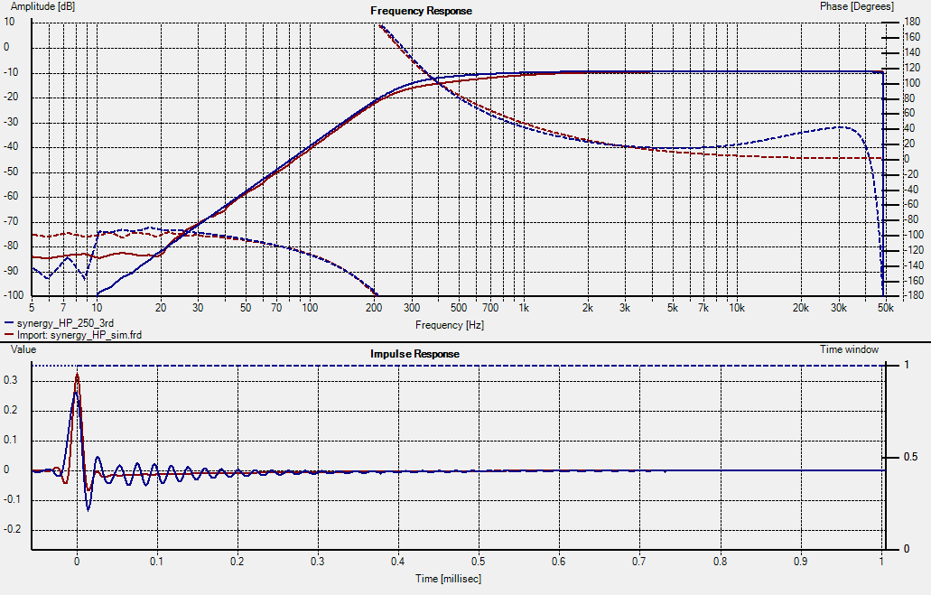

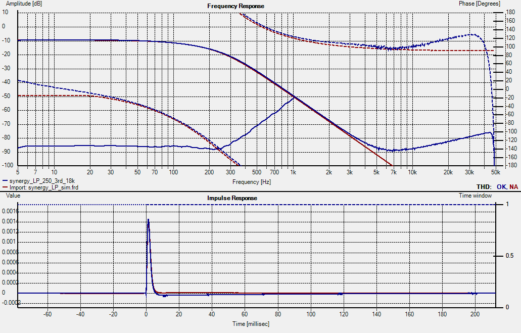

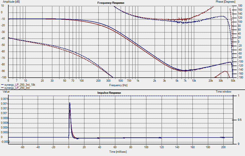

OK so the spice sim lied ;) where I thought I had to adjust the values in the LP section to match the speaker workshop sims curve, in reality the original value was ok. I substituted the 24K resistor for an 18 (passive sim says 17.5K) and now the LP is very close to simmed value. First pic shows the actual vs the sim.
2nd pic shows what I had last night vs now (now is blue).
The HP is also off, though I'm not sure what is happening there.. not as easy to diagnose. It looks more like a normal rolloff. Blue is measured the other is the sim. Putting in a bigger cap 41nf instead of 33nf, which is about 20% over does make the sim more like the actual value so it could be my cap is higher than it should be (cheap jaycar mkt for the test). The more concerning (perhaps) is the ringing in the impulse response. Not sure what that means... Blue is the measured result.
Tony.

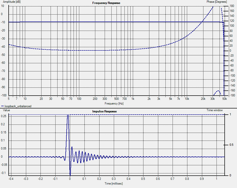

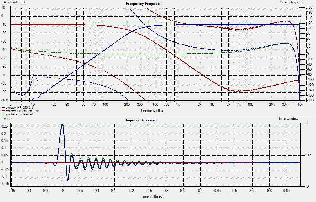

ok false alarm :) the ringing is at a high frequncy, approx 48Khz, and is inherent to the soundcard. attached is the loopback measurement. phew!
Most likely an AD artifact at or about the nyquist freq.
Also something I forgot to mention last night is that there is as good as zero insertion loss as well :) something that was worrying me from the spice sims.
The second attachment shows the loopback measurement along with the low and high pass measurements. All taken at -10db in holm impulse.

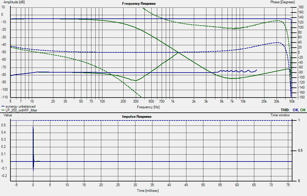

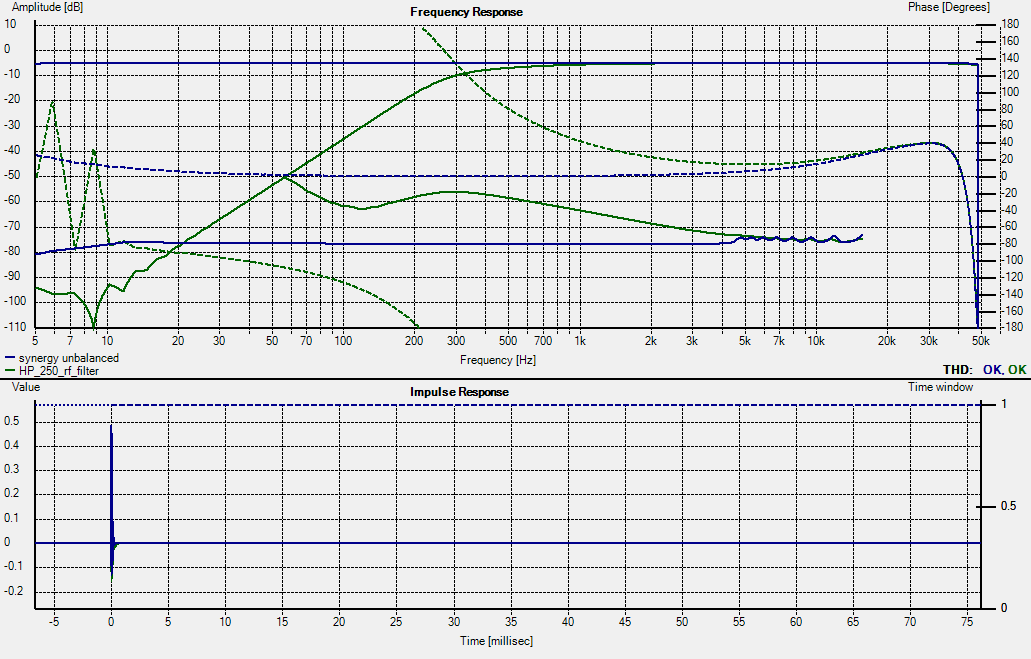

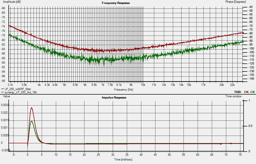

OK so I decided to try something else today. Some RF filtering. I had seen what looked like AM RF at around 1Mhz on the scope before which the FDNR seems to amplify.
I did the calcs and 1nf to ground after the 220 ohm gate stoppers is pretty good (for a test) frequency starts to rolloff at around 50Khz and the corner frequency is around 250Khz. I actually put two in. one before the first buffer, and one before the LP buffer.
It works. It doesn't completely eliminate the noise but it shows that this is most likely what it is. Unfortunately in a real world implementation (rather than my test bench) it isn't quite so simple, as the volume control, and the level control I have on the high pass, WILL affect the corner frequency if not full on.
Probably the best place for an RC of this type is between the first buffer and the other two, that's not easy to pull off with the current board... Luckily however, I think it is pretty much a mute point, as it is so far below the levels as to be basically inaudible anyway I suspect. I will probably being the obsessive person I am eventually eliminate it, but for now I am happy to have found the cause.
First pic shows the difference with and without the filtering. Without is the lower trace. you can see it is quite a bit more ragged.
2nd pic shows distortion performance of the Low pass compared to the Sound card (blue trace). The lower lines are the THD.
3rd pic shows the ditortion performance of the High pass. I'm uncertain how to interpret this one. It is pretty much the same as the card at higher frequencies, but rising as the filter kicks in. I don't know if this is holm assuming that the lowering level is distortion. This is exactly the opposite of what the LP shows, where as the filter kicks in the distortion (for a while) actually drops to levels below that of the sound card in loopback... Me thinks some oddities in Holm's distortion analysis.

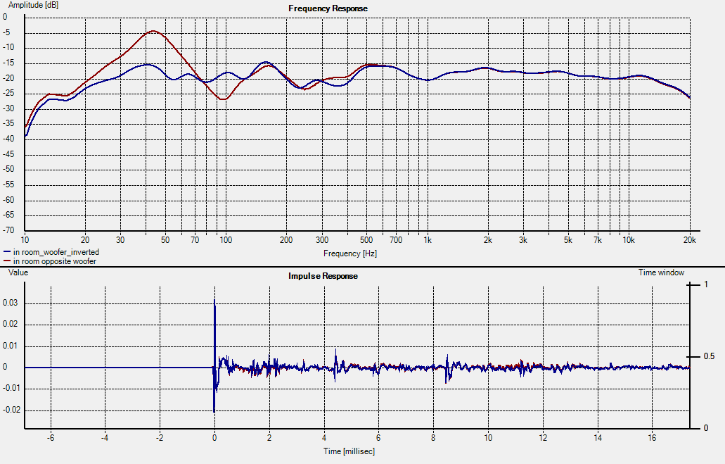

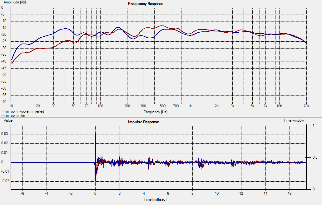

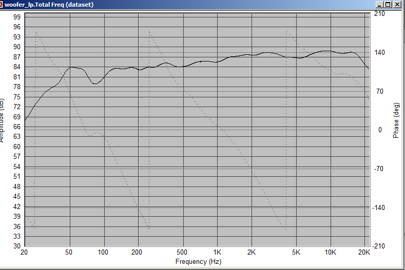

I also did some in room measurements. Perhaps my sim and values were not as successful as hoped... Though to be fair the measurements for the sim sim were done with both MTM's running, and both woofers running.
first plot is with left mtm and left woofer. Blue is the combined response. red is Just the MTM's (original dual measurement not the single one).
second plot was seeing what I would get if I ran the left MTM with the right woofer. Obviously there is a room node at 40Hz which is excited with this mic position and the right woofer running! Interesting I didn't get anywhere near that level when I ran both woofers, perhaps when both running they are smoothing out the room response.
I might have to try some new outside measurements as the ones I had before I was not happy with.
edit: graphs are 1/3 octave smoothed.

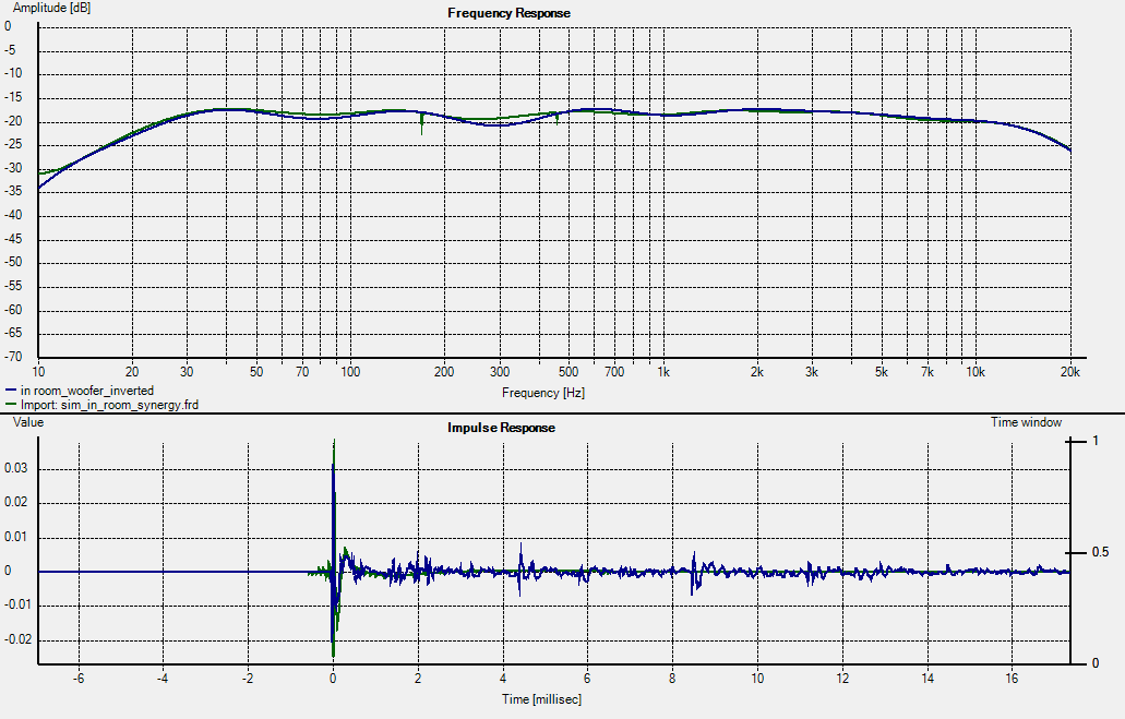

SO I remembered that the sim was done with 1 octave smoothing. I exported the sim and imported into holm impulse. The correlation is better than I thought. Slightly more dip around 300Hz. No doubt due to not summing as well as in the sim. If I use this approach, it looks like I need to try the high smoothing to get an initial solution and then go to perhaps 1/8th octave measurements to so the final tweaking.
Still I think I shall do some more outside measurements. Blue is the actual in room measurement.
Tony.

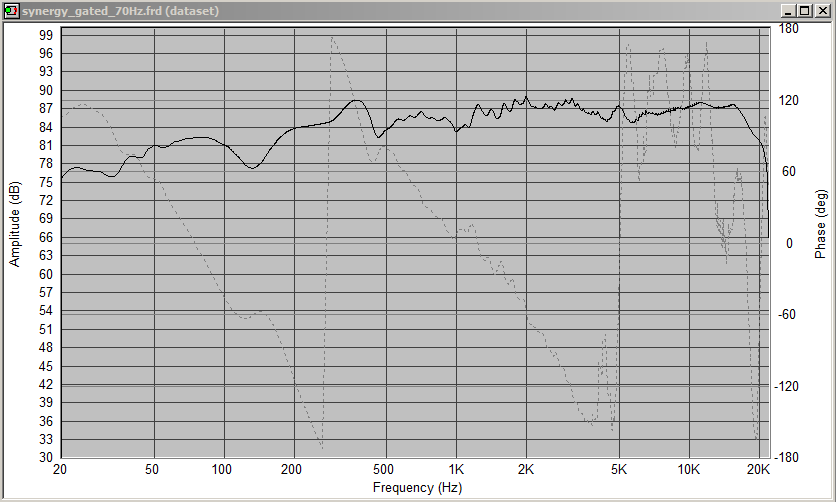

I did some measurements outside this morning. Attached is 1/8th octave smoothed. I can't get good data below 200Hz unfortunately. I'm pretty sure the mess around 100Hz is reflection related, probably ground bounce.
Blue trace is the woofer, Bright green is the MTM, and dark green is the two playing through the synergy.
It looks like a little bit of attenuation of the high pass would be good. I'll see if I can use these measurements in the sim to get a good correlation. Overall not too bad a result I guess.
It is interesting that I need to invert the woofer, or the MTM to get the best response, as in the sim no inversion was necessary... me thinks my in room measurements were a bit suspect! ;)
I gated the whole thing at 70Hz which included some reflections which mostly affected the upper frequencies, then I loaded this into speaker workshop and 1/8th octave smoothed it. This seems to give a reasonable representation of the frequency response down to 70Hz. This is the second attachment.
I now reaslise why I had problems with the outside measurements. The baffle step is really obvious for the woofer, however in room the room gain makes the woofer pretty much at the same level as the MTM's.
Tony.

I see you've been putting some time into this project, Tony!
I think you're trying to do 2 things at once here and you initially need to check the phase of the signal response at the Xover point for each driver and then check for correct alignment (voice coils/dustcaps/etc) - one thing at a time - the MTM comes first and maybe need some 'packers' under the tweeter for correct time alignment - MTMs can be quite tricky here and often easier to do it 'by ear' rather than rely totally on response/phase measurements
Then do the same with the bass driver, assuming the phase of the signal to the amps is in phase, or 180* inverted, and the amps themselves don't add some arbitrary varying amount too - it does happen, unfortunately.
How do you get a baffle step effect with the bass driver?
You have to set the filters in the measurements to cutoff the reflected signals if doing the driver response measurements as a single peak/dip of about 10dB will throw everything out - room response is a separate thing after the xover/speakers are done

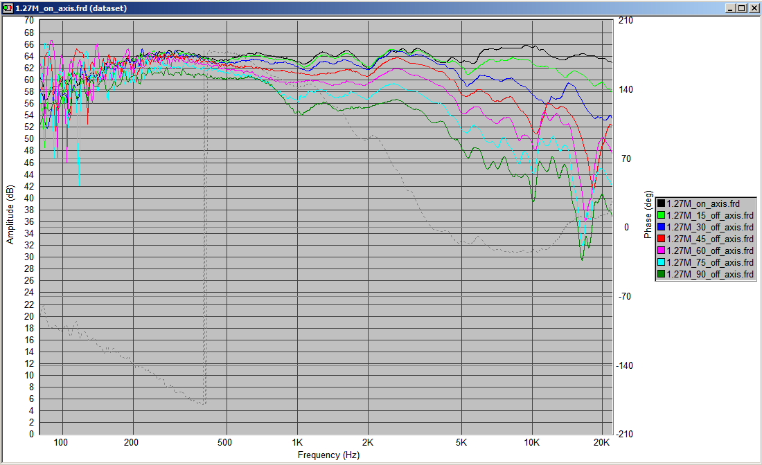

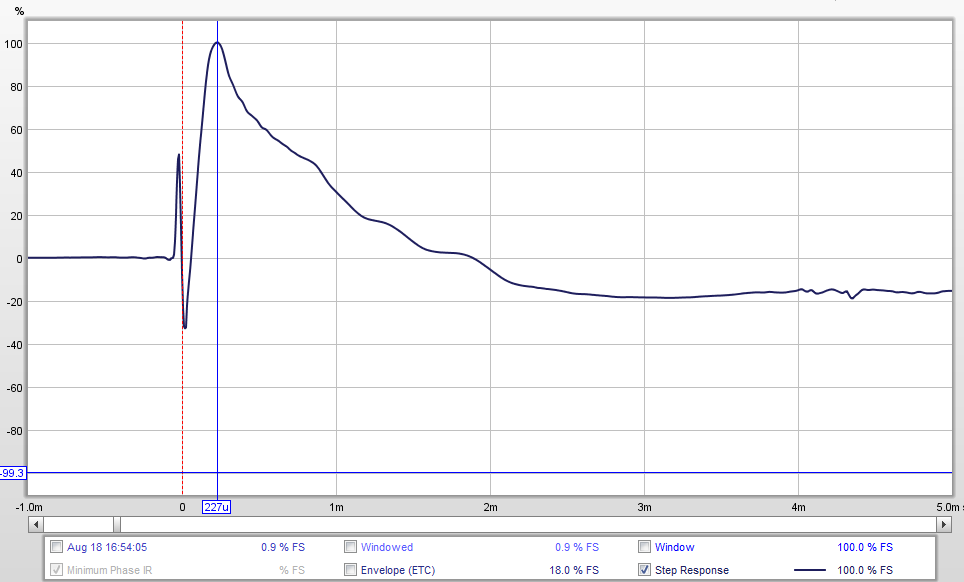

The MTM is pretty well sorted. attached are measurements I did a while ago. SPL and step response. I've only just become aware that I can get the step response in REW, and I think I have some idea how to interpret it. From it I would say that I have close to, but not quite time alignmemt between my tweeter and woofers.
The FR on axis is really quite flat, and the off-axis performance is good too (third pic, measurement done in a completely different, and less ideal location).
BUT I really am struggling with the measurements for doing this LP crossover. I'm starting to think I may have to accept my outside measurements gated at 200Hz and used nearfield measurements, baffle step corrected and spliced in using Jeff Bagbies response blender spreadsheet.
But that is the other thing that is bugging me... the baffle step.... The woofers are very close to the floor so get some boost because of that. That is not reflected in the measurements done outside.
4th pic shows in-room dark green, vs outside, blue... note the significantly higher levels in the bass in the in room measurement... if I try and model based on the outside measurements I will end up with too much bass!
I did put the scope on it before. I DID have an oscillation at 1Mhz but only when using the opa2604. with the 2134 it is quite happy.. However I did get what appears to be AM signals, also around the 1Mhz mark, but these were present when the synergy was powered off, and the scope probes were just hanging in the air.. what I did find was that they were bigger in amplitude in some parts of the fndr around the opamp... so it can pick up AM, but I figure once it is properly shielded in a box this will probably be less of a problem. Also the level is very low, at around the 5 - 10 mV level.
Tony.

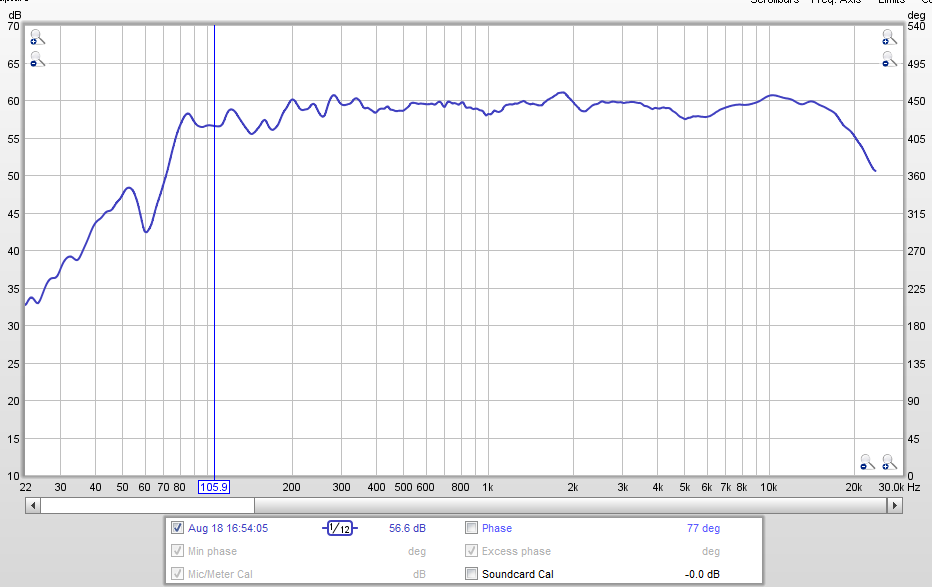

The response that you've got going here is pretty impressive for an indoor/room response
- not sure about the 56.6dB level - a mis-label?
Is the second graph the step response of the MTM? What's it actually indicating?

Hi James, the measurements above are gated measurements taken outside, not in room. If they were in room I would be Very happy (the response is basically about +- 2.5db from 90 hz to about 18K) considering it is only intended to go down to around 250Hz I think that is pretty good). The only in room is the dark red trace in the fourth graph.
The step response shows the impulses from the mids and the tweeter in the MTM. I'm not sure which is which but I think that the fact that the first upward spike and the next downward spike are so close to the time zero that the two drivers are almost perfectly time aligned. basically within a few microseconds of each other. I zoomed in and it is actually about 37 microseconds, which is about 1.2cm

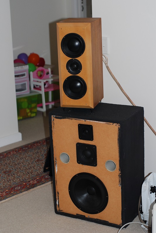

With respect to the bass driver being close to the floor, that is the current box design. I'm getting this going, with existing boxes, new boxes come later. The woofers act as the stand for the MTM's. to get the tweeter at listening height.
A picture is worth a thousand words, so here is what the current situation is. Only the woofer in use. Basically my old faithful threeways re purposed as dedicated woofers. The project to build some decent cabinets for the vifa's will come later (and a new round of crossover tuning when that happens).
Tony.

Looks like the MTM is pretty well sorted - when everything's working well, small alignment distances become quite audible but something for another day ...
Bass driver - yes, having the driver this close to the floor is asking for trouble - just turn the damn thing upside down and get the bass driver closer to the MTM and away from the floor - might sound a bit thin tho - perhaps on it's side with a couple of spacers allowing free air flow below the box ...
