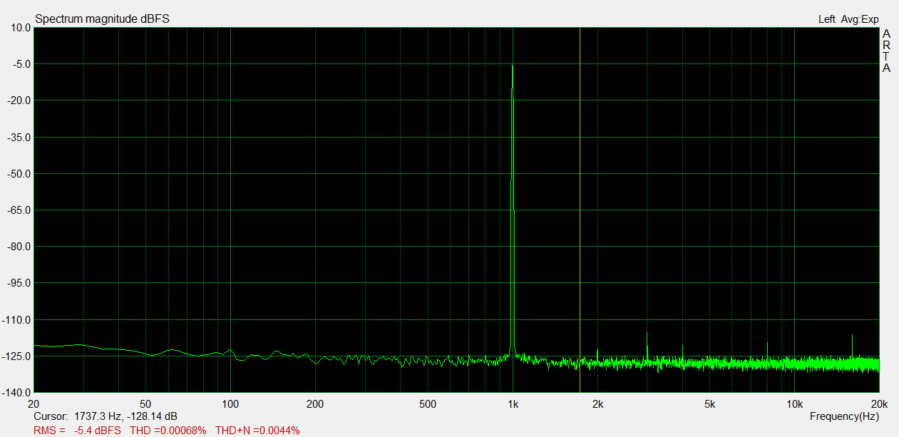

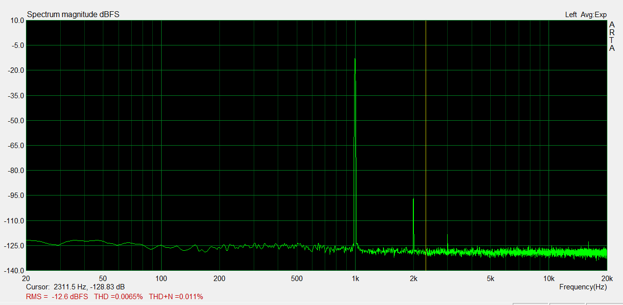

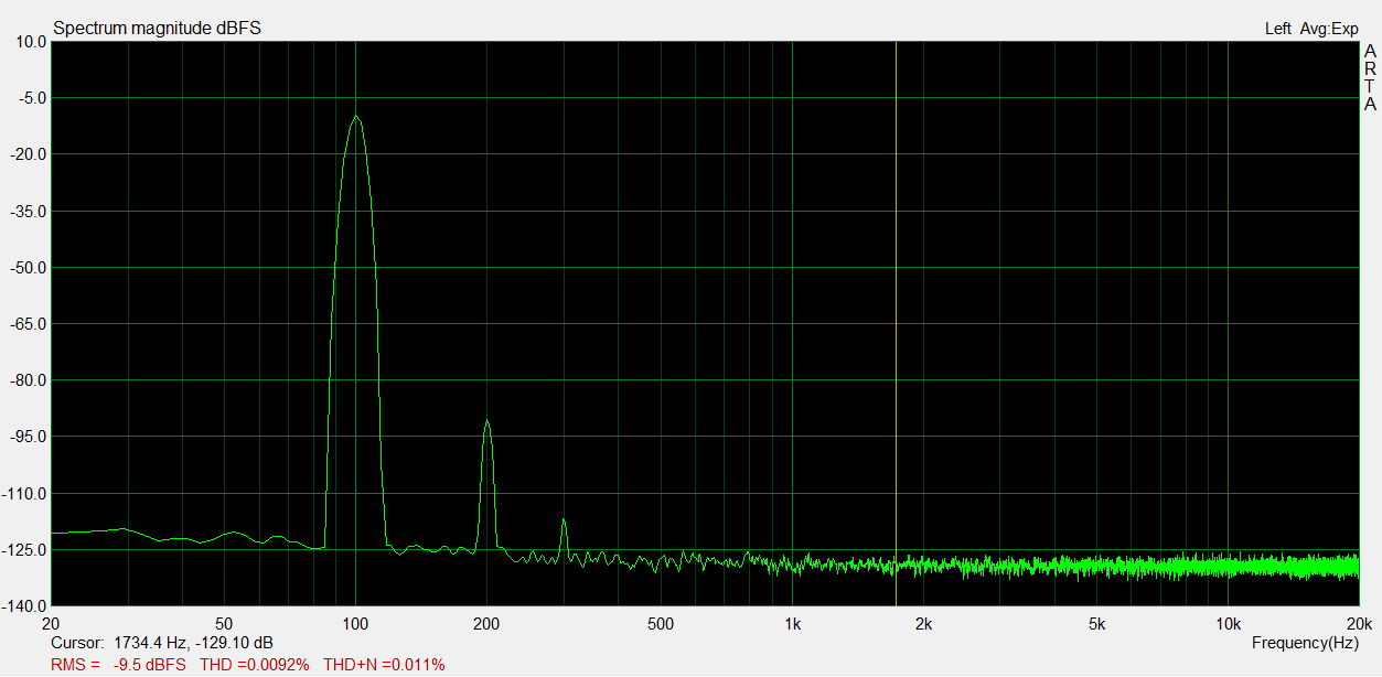

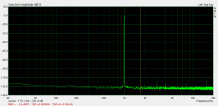

I made a small balanced to single ended converter on my breadboard to squeeze a bit more out of my focusrite 2i2 for measurements. Attached are 1K (hp) distortion test and 100Hz (lp) distortion test. predominantly 2nd harmonic as predicted by the sims. Not fantastic figures but not bad either.
I tested the hp at 9K as well and result was the same as for 1K
First pic is the loopback. 2nd high pass and 3rd low pass. Note that the HP has approx 6.5db attenuation.
Tony.
