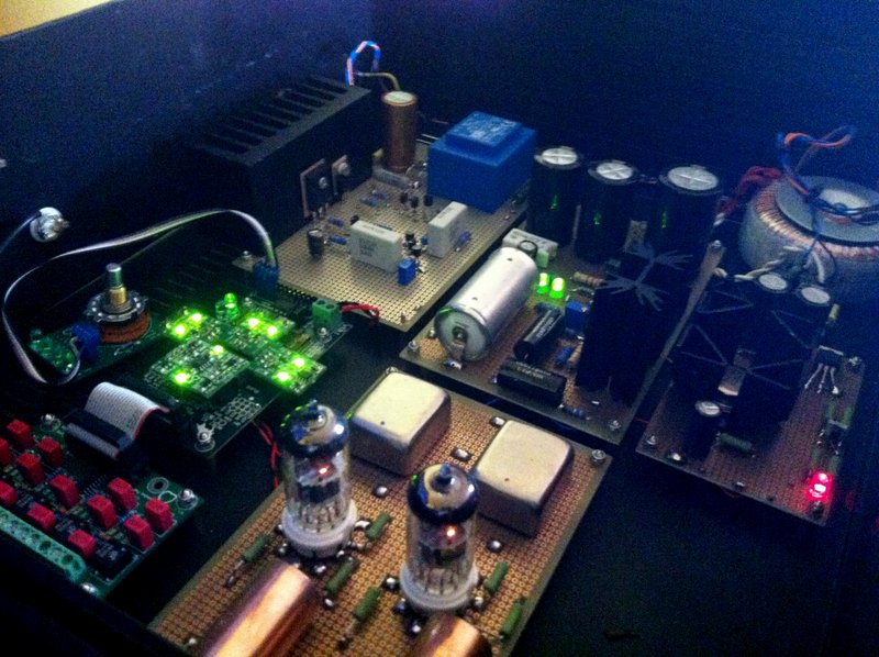

as promised... here my buffalo III dac with mixed xformer (i/v conversion and unbalancing)/tube output (srpp buffer), both HV and LV Salas shunt and heaters psu made with a lm317 and a 2n3055 as current driver
