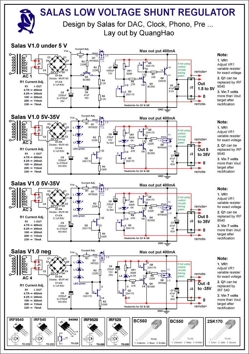

I built the 5 to 15V version. I will be feeding 5 volts. The problem is that I'm not sure for my exact target current. The shunt will be used for supplying the DAC analog part. The chip is AK4396. On the datasheet it's said 32mA typical and 47mA max current. So how to make as constant voltage as possible? Increase output current using the load resistor?
built the same reg for same chip. Just to confirm, if I'm aiming at 100mA output and have 9.5v after rectification, R1 should be 9.5 Ohm, right? I wonder how it was calculated in other cases (att.)?

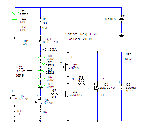

Hi Salas.
I'd love to build one of your single-rail positive Salas Shunt Regs to power my (original version, not DCB1) Pass Labs B1 buffer. So I guess around 22-24V required.
There's a bewildering amount of schematics in this (nearly!) 500 page thread. I'd be greatful if you could point me towards the latest/best schematic to use for my B1.
Many thanks :)
- John

Hi Salas.
Many thanks :)
- John
John, hi!
Fellow Briton KatieandDad had shown a combination like the one you have in mind rather recently and reported favorably. He had used a normal B1 fed from the DCB1's PSU section only. Since its a beaten path I am tempted to suggest you repeat that combo.
Here is the business end you need. Just use 10 leds for the shown row of 5. Feed it >7V than its output. R4 & R5 are check points for local currents that you may skip or not. We will be happy to learn about your progress and result.
Cheers
diyAudio Chief Moderator
Joined 2002
Use 15R 2W R1 and 9-12VAC Tx. 10R R1 will make it a bit lower impedance if your heat sinking is still happy. Talking about the 3 Leds input sections on that schematic and IRF9520. Both settings should cover 100mA load and leave enough spare for the reg to feed.

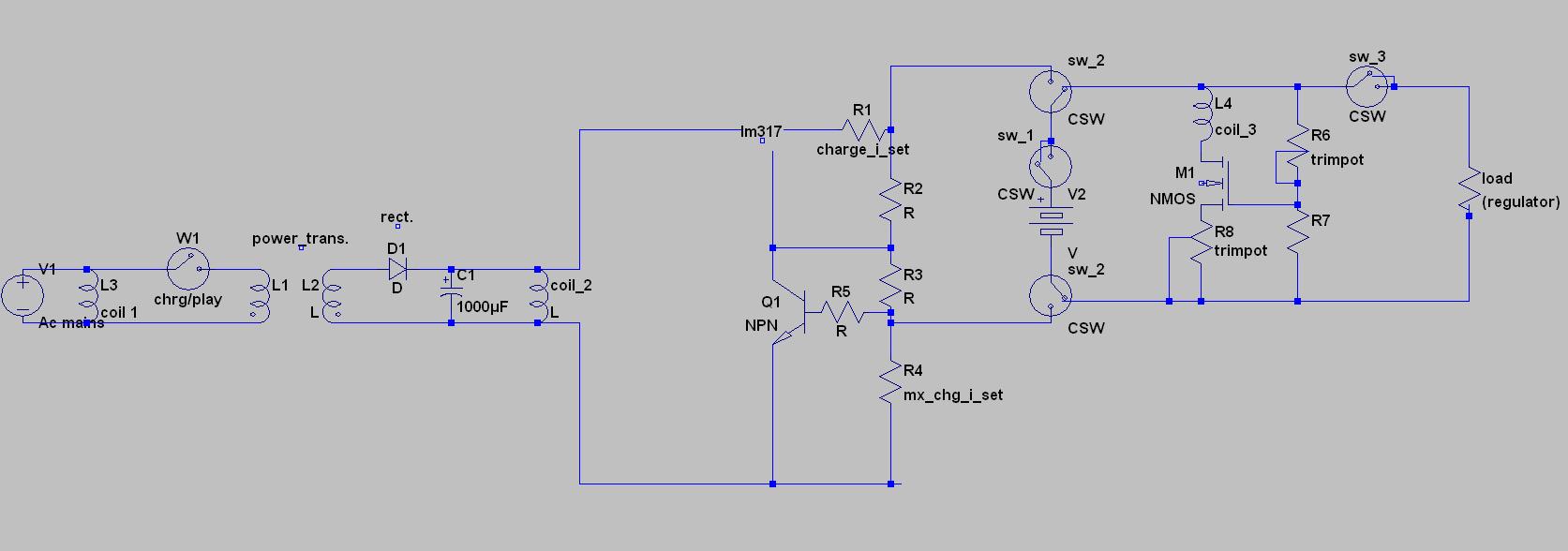

hello all,
i drew a minimalist battery charger while waiting for parts for the jfet CCS SSLV3.3V i am playing with.i m also trying to find P mosfet to allow the use of 1 battery pack for several regs.
please consider that this is merely an attempt to create a charger. i am not an EE.
the charger section was design taking bits from the lm317 datasheet and the rest is my creation.
it can accept any battery type.
there is an optional protection circuit for lithium types. if the battery voltage falls below a certain voltage set by R6, M1 shuts down and only a tiny current runs through the divider. r8 sets the relay coil_3 current. for around 6V-7V battery operation, use a high Vgs high Yfs fet like irf540, r6=1M r8 =100R and a 3Vdc (or so) relay.
as drawn, the circuit is playing music. if you close the power switch, it turns to charge state. some circuit parts are to be determine because they depend on the charge voltage and charger can be found if you look at the datasheet. the charger has a current limiter and the current diminishes until the battery reaches the desired voltage where no current will flow.
personally, i m a bit concern that coil_1 may induce noise in the circuit. maybe a separate dc coil with own small main trafo and rectifier always on is a good alternative?
notes:
-coil_1 is there relay coil to sw_1, etc.
-capacitor better be a high endurance type like nichicon HE
- you can parallel charge circuit to charge batteries individually and the protection circuit can be adapted to ''monitor'' lithium cells individually.
if you have any suggestion, comments, questions or concerns, please express yourself.
if you see any nonsense, just tell me :)
