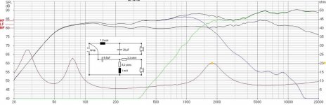

one of these
though , I tend to prefer System 15 , at least for HF part

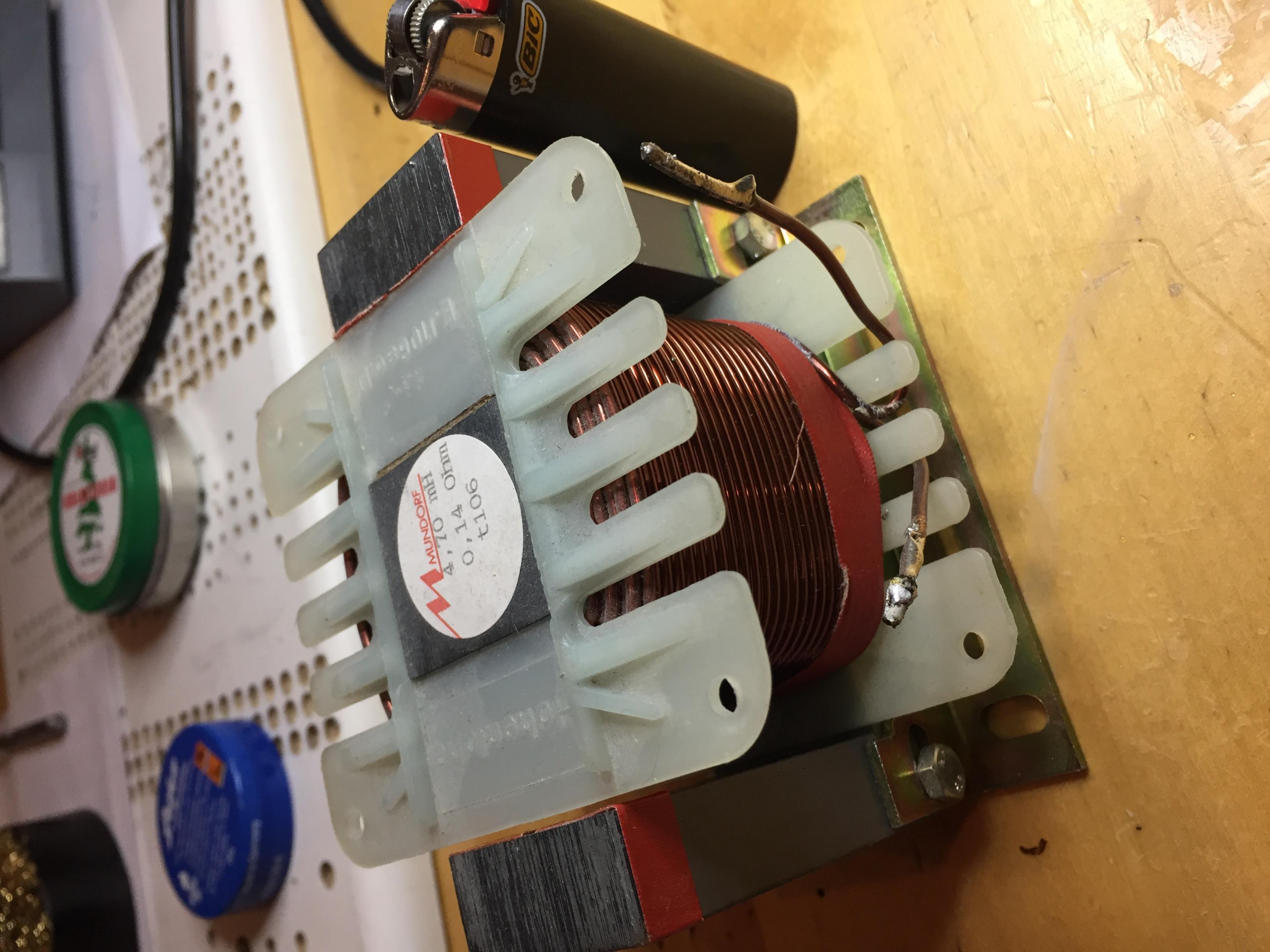

what's relevant for ya is - find proper choke in range of 6-9mH and put in series with bass helper , irrelevant what type of enclosure for it you're going to use
Torobar is having good ones , 8.2mH , tried and blessed in my Sonido speakers construction
very good price/value ratio

of entire xover , made for my Absolute WAF Tann OB , you can use just bass helper part
as you can see - my Tanns are Pepperpot ones , while yours are Tulip equipped ones , so HF part of xover is mucho different
yes , go for System 15 xover as start , later you can fine tune what's needed - most probably just value of series attenuation of squawker and , depending what solution you choose for bass helper , maybe some series resistance for bass helper driver
