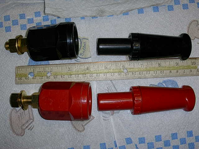

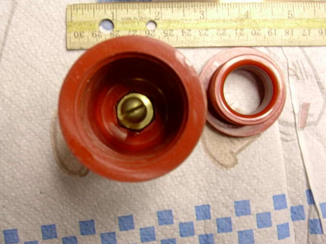

Speaker terminals for the monster.
Gentlemen, I would like to offer the following Superior Electric connectors for the speaker connections on the monster. If you think they will work, tell me where to send them. I was saving them for a large power supply but have decided to do something different. Just thought they would look great on the chassis being oversize and all. Regards, Steve

Thylantyr: Nice looking tweets! Those Madisound connectors look like something I’d like to use on a mildly insane amplifier, but I think they lack the Frankenstein appeal this monster kinda has going.
Gearheaddruid: I hope this generous offering of yours doesn’t mean you’ve given up hope of putting all those huge toroidal trafos and caps you have to good use! Do you have six sets of those puppies? What gauge wire do they accept?
