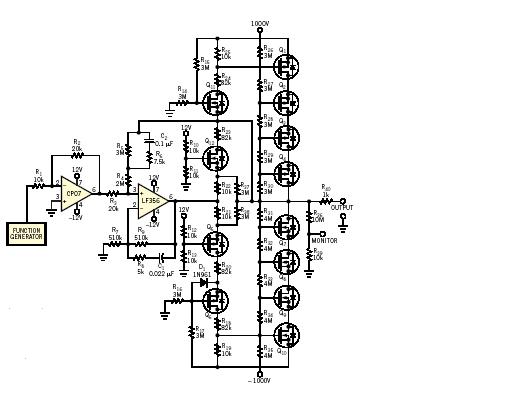

This is from this month's EDN.
Anti-gravity, at least in principle, isn't all that difficult. All you need to do is generate anti-phase gravity waves and you'll create a null.

OK here goes... this is not a practicle schematic, but just an idea, an zenish version of the X1000.... a BOSOZ, cascode, complementair 75Volt folower... 1KW in to 8 ohm, allmost 4KW into 2 Ohm for short durations? I trust you guys get the idea...
  • complete.zip
Hmmm thats an interesting design, I would have added constant current sources and i dont see a way to adjust bias, but....nice!
