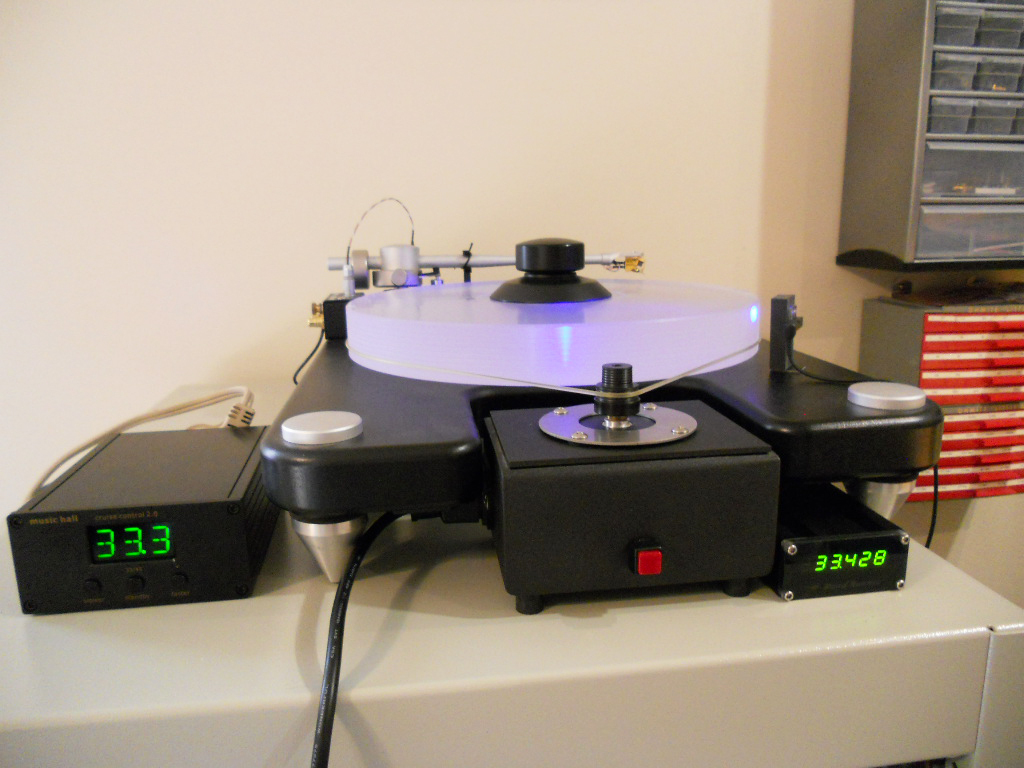

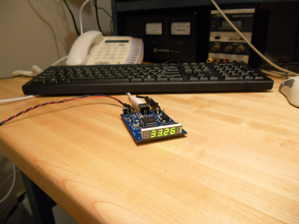

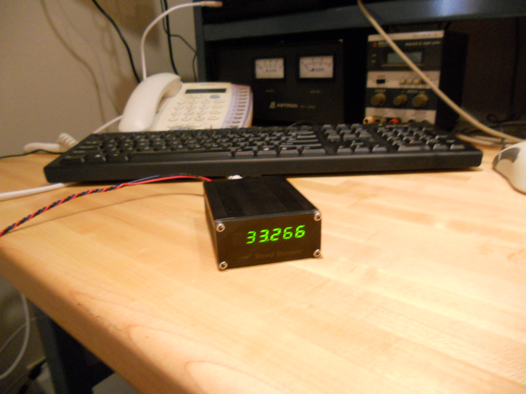

I've been working on designing a better PSU for TT motor control, but was confronted with the problem of how to accurately measure the platter speed to test the utility of the PSU. Strobe discs and the Sutherland Timeline were too awkward or inaccurate (not to mention over priced) and the handheld digital tachs don't provide enough resolution or accuracy to be useful. I decided to design a digital tach more suited to the needs of high accuracy and ease of use. Just build up the first PCBs with very good results.
The first photo is the PCB without housing. The turntable is connected to a Music Hall Cruise Control 2.0 with 0.1 RPM adjustments. 33.266 RPM is the closest I could get the platter to track with the Cruise Control set to 33.1 RPM. This is one of the problems I noticed when working with the PSU's available out there: The speed adjust is WAY too coarse and there are too many variables that affect speed such as belt position and tension. I think my PSU will have much finer speed adjustment, something like 0.01 RPM (I can adjust the frequecy of the AC out in 1/1800 Hz steps.)
The second photo is the PCB in its housing. The third photo is the tachometer tucked under the turntable and the Cruise Control set to 33.3 RPM. Note the actual speed of the platter is 33.428 RPM which is +0.28%, not exactly impressive for a $300 PSU.
Another thing I noticed about the platter speed, is it slowly increased over time as the motor warmed up. So no matter how closely you get the speed initially by changing the belt tension (or the PSU frequency), it is due to drift over time or if you happen to change the belt location. Since the tach has a USB output for computer logging, I think it would be a natural addition to the PSU to have a USB input so the two could be synched. The mass of the platter should take care of minute changes in speed that occur within one rev and the PSU should be able to supply short term stability with a clean accurate AC signal, but the tach could correct long term accuracy by constantly monitoring the RPM and suppling a well damped feedback to the PSU and compensating for drift due to motor warming, belt tension etc.

I've never seen thermal drift on an AC motor controller before. Have you tried a different motor choice to eliminate that as being the variable? It might also be enlightening to use a much heavier weight oil in the TT bearing so that viscous drag swamps any slight variation in load from the needle.
I run a Kuzma deck with silicon diff oil in the bearing and it gives rock solid speed stability due to the added drag swamping cogging effects.
Might be worth a try...
I suppose it's possible if it uses an "analog" oscillator rather than a digitally-based output derived from a crystal oscillator.I've never seen thermal drift on an AC motor controller before.
Likewise, the motor itself is almost surely synchronous, and should never "lose" a cycle unless the voltage into it is marginal, or an excessively distorted sine wave.
To convince yourself of this, you could use the device tracking the platter speed on the motor pully, and satisfy yourself that its speed doesn't change over time.
I can see where this could help, though one of my thoughts as to why it speeds up longterm is that the bearing and oil warm up slightly, thus the oil has lower viscosity and is easier to turn. Likewise the belt "loosening up" or warming up in operation could have an effect. From the description, changing belt tension definitely affects the speed, and it's reasonable to think that as the belt operates and wears, its length and thus tension changes on its own.Have you tried a different motor choice to eliminate that as being the variable? It might also be enlightening to use a much heavier weight oil in the TT bearing so that viscous drag swamps any slight variation in load from the needle.
And to me this points to using a different or better belt.

In order to get .001 RPM resolution requires the ability to resolove precession or recession of the platter rotation within 0.628 MILs per rev.
The tach triggers once per rev and the stability of that trigger point is very important for accuracy (the clock is xtal controlled using a temp comp TCXO with trimmer for absolute accuracy). The trigger width is 10's of mS, so the uP outputs a shorter pulse (300uS) that I use to fire a high brightness LED to use as a strobe. I have a 40 AWG wire at a fixed position and a piece of a machinists scale taped to the top of the platter; the strobe fires when the scale passes below the wire pointer. Examining it under an Edmund stereo microscope, I can not detect any ambiguity in the trigger point, so the reading should be correct within at least one count. The bobble of the last digit can be a bit distracting (if not concerning), so one of the solder jumpers on the PCB blanks the last digit and produces a more pleasing (stable) display. I can always unblank the last digit for more precise measurements, but the effect of a stable display has some merit.
Using a tone from a disc is an easy way to measure rotational accuracy, but with a 3kHz tone, you need to be accurate to ±0.1 Hz which can require a long gate period. If you measure the frequency across several revs, you loose important information about stability as the reading will be averaged.
I'm using 30K counts/Sec to acheive that accuracy and you can use the tach while listening to music.
