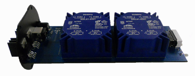

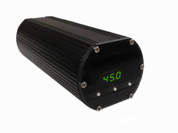

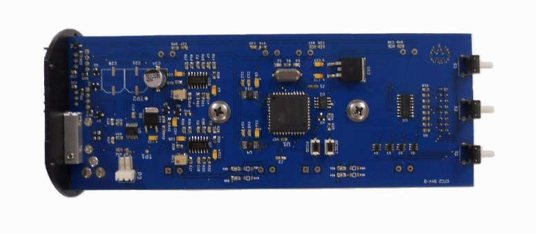

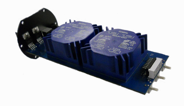

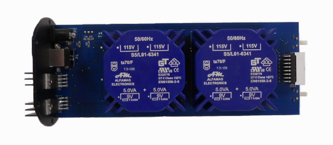

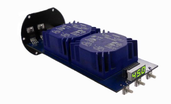

The thing to do is to build your system, measure it by all means possible and then present the results to confound your critics and move the knowledge base onwards for those parties who are interested enough and open minded enough not to worry about having their views tested.
I'm very happy with my set-up with high viscous drag fronted by a large transformer and a simple phase shift capacitor who's value has been selected for least vibration on my specific motor, rather than just running a nominal value. It works for me. But I can't help wondering if it could be improved, so I've just finished building Meldano's TT-PSU and I'll investigate how will this works with it's voltage, frequency and phase shift being adjustable in the digital domain. if I can get it to work as well as my current solution then i'll start looking at how it can be improved by feeding in a signal other than a perfect sine wave.
Don't worry about the lack of positive response, this is one area of audio design where there really are very few people doing any serious investigation beyond rehashing old solutions in less expensive packages.
Stick a fork in me, I'm done.

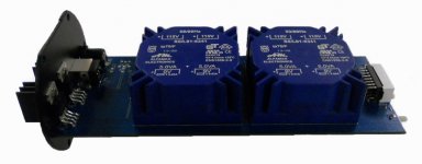

I appreciate your comments. I think to some extent, I have been attempting to do just what you recommeded. The problem is, I really don't need the frustration. I retired from successfully running my business for 20+ years and I think my time would be better spent on the golf course or with my family. I think I'd be happier just designing and building my projects for myself and keeping my mouth shut. I guess that makes this my final post.
I had a look at the Meldano design, looks very well built. I don't read German, but I think I got the gist of it. I hadn't thought of making the AC level adjustable from the front panel, but it wouldn't take much to add digital pots to both outputs (currently have 10T pots). Everything else looks similar in capabilities to my design: Dual DDS chips, 0.01 RPM adjustable freq, 1° adjustable phase, etc. I found an off the shelf extrusion to house it, 2.5"H x 3"W x 7" long.
Good luck with your project.:D
