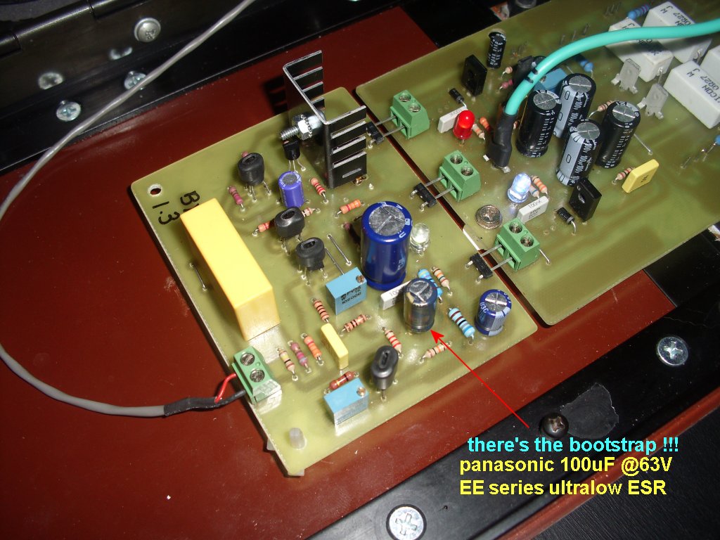

Just curious, since when R21,R22 & C9 as current booststrapping network is better solution than regular current source with one or double BJT's. Is this only a fancy result of simulator measurings or really better choice by listening tests. :confused:
Simpler and better sounding , ask DX (destroyer X). People make fun of the primitive bootstrapped current source but it is more musical. Combine that with the PPM blameless w/ TMC and you have utter perfection.

I like bootstrappes , they are simple. it really is almost a dead tie in the listenability of the 2 amps. the current sourced one just is able to outperform the bootstrapped one by it's physics. This is equates to better highs .. that's what I hear in the "real world".
The 2 amps and the power output boards are the exact same , what better A/B comparison. I am listening to the bootstrap again. to answer your ??? :confused:
(BELOW ! ) there's the bootstrap ... :D

... and they sound better than any symasym or even the luxman clone. All these VB's sound better than my discrete OEM receiver (I still have one :eek: ) , but the bootstrap restricts slew , (amp is slower by design). A strange thing about the bootstrap , it sounded better after it was ran hard ( bedding down ?? :confused: )
