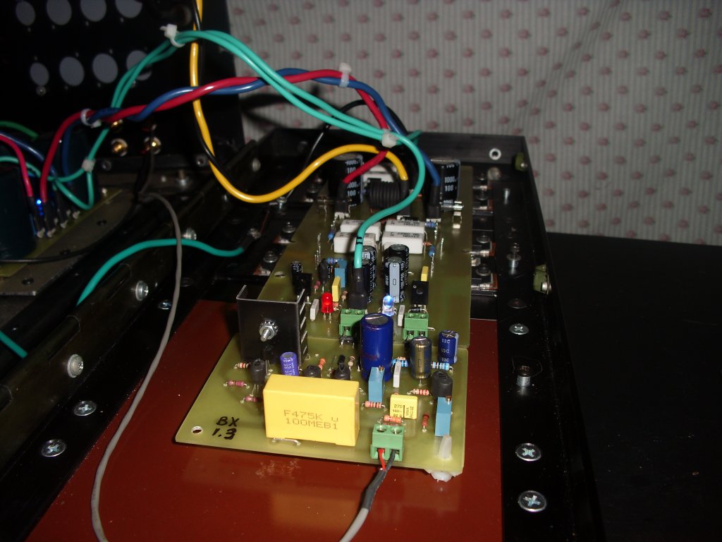

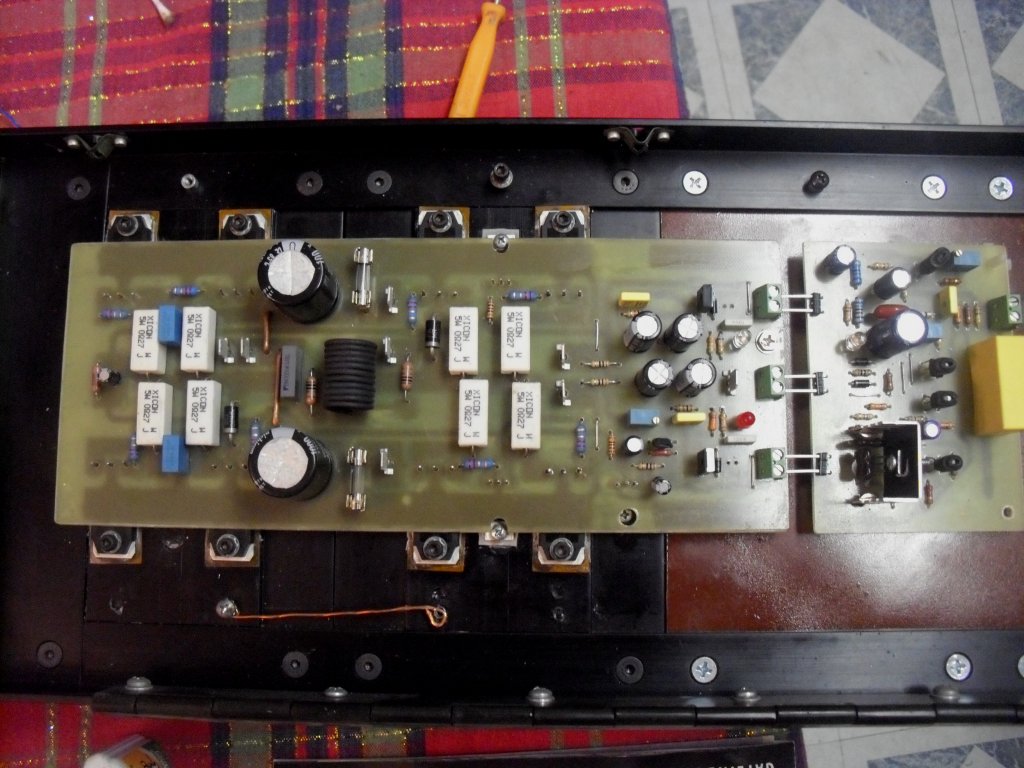

BX1.3 and CX1.3 comparison
Hi OS,
Congratulations on your excellent modular project. Sorry to hear you blew up your CX1.3. Did you manage to compare it with the BX1.3 before that happened and, if so, what did you conclude during your listening tests? Re your post #888.

Artu , If you have a LT (what do you use for simulation??) file. Post it (base .ASC and a .inc text of any models exclusive to the sim).
I did get the CX to work after it fried a few devices by removing the beta enhancement. At this point it was essentially my "supersym w/ cascode. It sounded "nice" but is not in the same league with the 2 blameless's (AX/BX).
The blameless's w/ tmc are TRULY blameless...
Yes , you are correct. Especially on a standard (NO t-trak)OPS , a dynamic mistracking of Vbe occurs on transients because the Vbe can't keep up with the millisecond to millisecond thermal peaks and valley's of the OP. With TMC , this is why I noticed it's effect at moderate to higher volumes. TMC will totally cancel out any switching distortion right down to class B operation (0 bias - confirmed static bias on CRO) ,so any dynamic mistracking is a "walk in the park" for this compensation method.
At lower volumes (first watt) , especially with 4 pair outputs @ 80ma ea. ,you are essentially in class A most of the time anyways.

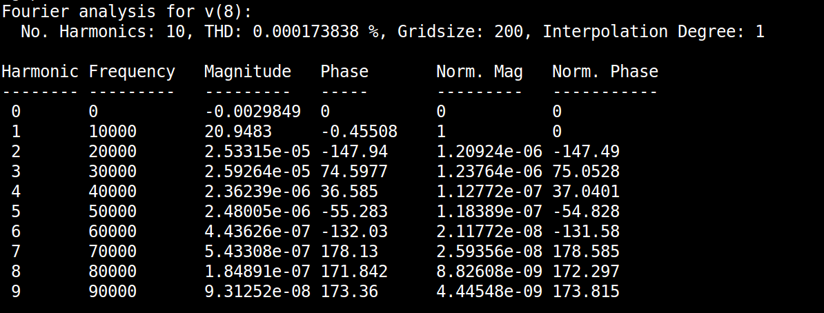

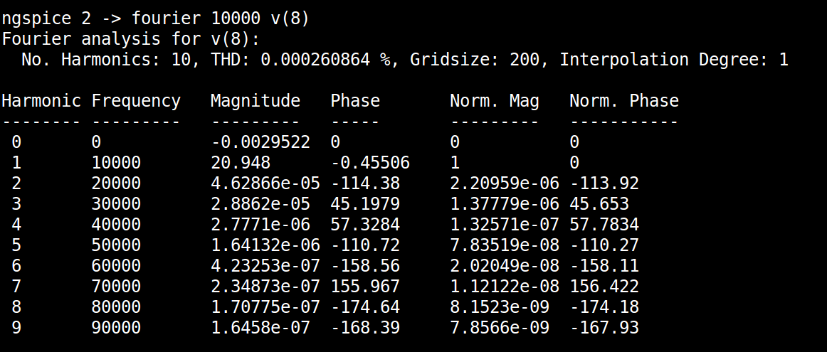

The circuit and models
Os I use ngspice in Linux and Spicef3 version 5 on FreeBSD (no Windows). Both simulators shows same result. This simulator does not use the BJT NK (flicker noise) parameter. All the models I beleive are from reliable sources ON Semi, Fairchild, Zetex. As I explained I only have a text file (.cir), so to use it with LTSPICE or other graphic front end you'll need to generate your own .asc file, but you can cut and paste the models I use, and also check the schematic I've posted wit the .cir file (I am an old man form the unix days). Inside the .cir file there are lots of models not used, and there are replicas of the same model (different sources) with slight differences to add more reality and imbalance. The file attached amp4.txt is what you need to simulate. Ahh to simulate slew rate you must bypass the input capacitor and connect the servo out to GND, to disable it (because it with mess the bias as the output signal integral =/= 0.)

Stunning results, Artu, very nice circuit, like it a lot.....
Very high OLG, too, congratulations!
Hugh

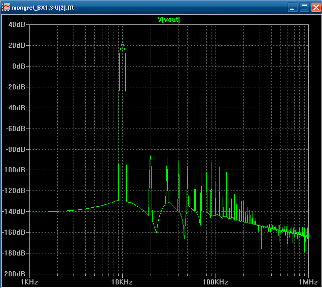

Looking a bit deeper, these results are better than most think. Normally at
10kHz, Xover artifacts show up as higher order components - and here
there are virtually none.
It is a textbook perfect spectrum which normally very uncommon at HF.
How much class A bias is this amp running?

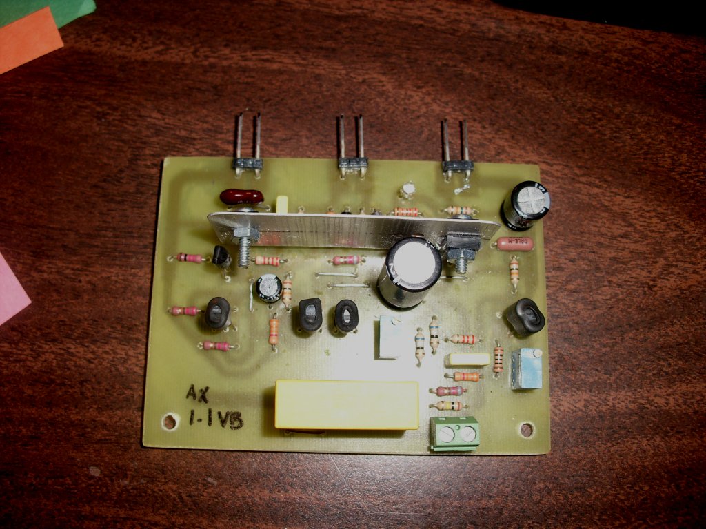

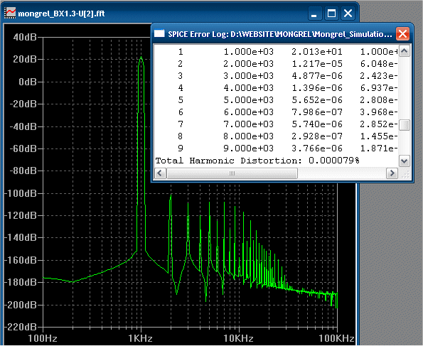

It's just a simulation. Look (below 1/2) , I can get this without tmc.. (more advanced "carlos Blame ES" - bootstrapped cs) .7ppm @1k
With just a little "magic" - (below 3 - but with a current sourced blameless).
Under 120db you can't really hear any harmonics ,maybe.. just input pair noise.
Now , in the REAL world .... (pix 4) can you really hear the differences between 2 amps that flirt with PPM ??? With brushes , cymbals , and vocals .. it is a close call ... 2 perfect amps. The bootstrap has a tiny bit more authority in the bass (that amp Below can bottom out my peerless's - easily).
The AX and its TMC (which , by the way.. works much better with a CCS'ed VAS)
can exceed ANY AMP I EVER HEARD >> ABSOLUTELY !!! in the soundstage and detail at the 200 watt level. Send stinkin' shivers up your spine and there is no fatigue ... you are waiting to hear the next note like a fiendish drug addict.
I was even running the un tmc'ed BX on the left and the TMC'ed AX on the right (listening to them now - can't stop)... These are on a new level. Carlo's blame with better parts and design (matched/cascoded LTP) is a real winner to be able to come close to the mighty AX - unmatched clarity !!
Such simple circuits , who would believe ... Goldmund can go to hell. (8$ AX VB and $30 output board / below - last)

The current bias details.
Terry, to be little more illustrative: at mid power ~ 30 Watts the first fourier analysis shows weak Class A (underbiased near AB) lower THD but the 3rd harmonic as high as the 2nd. The second analysis at the correct bias shows higher THD but the optimal harmonic distribution for musicality (as tubes do).
