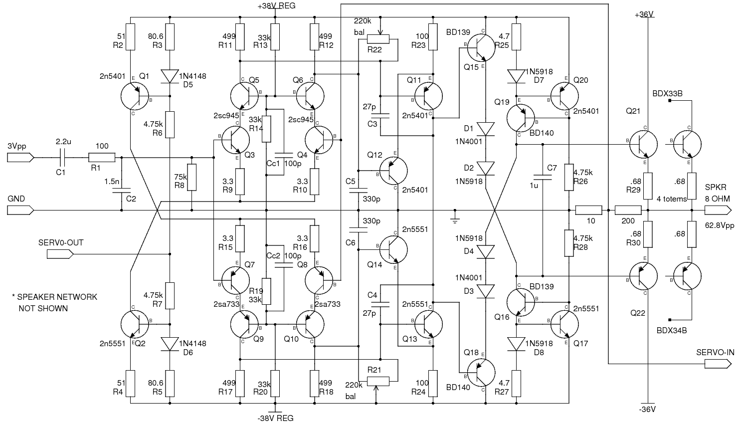

Hi all, Sorry Os for the intrusion. Here is my take for the Goldmund killer:
Note that the modest components choosed are what I have on hand here in Chile.
output power :60W (8 OHM load with a SPEAKER model)
output impedance: 0.001 OHM
Voltage Gain: 21 (3vpp in, 60,8Vpp out)
Slew Rate: ~ 200V/usec (rising & falling edge at full power)

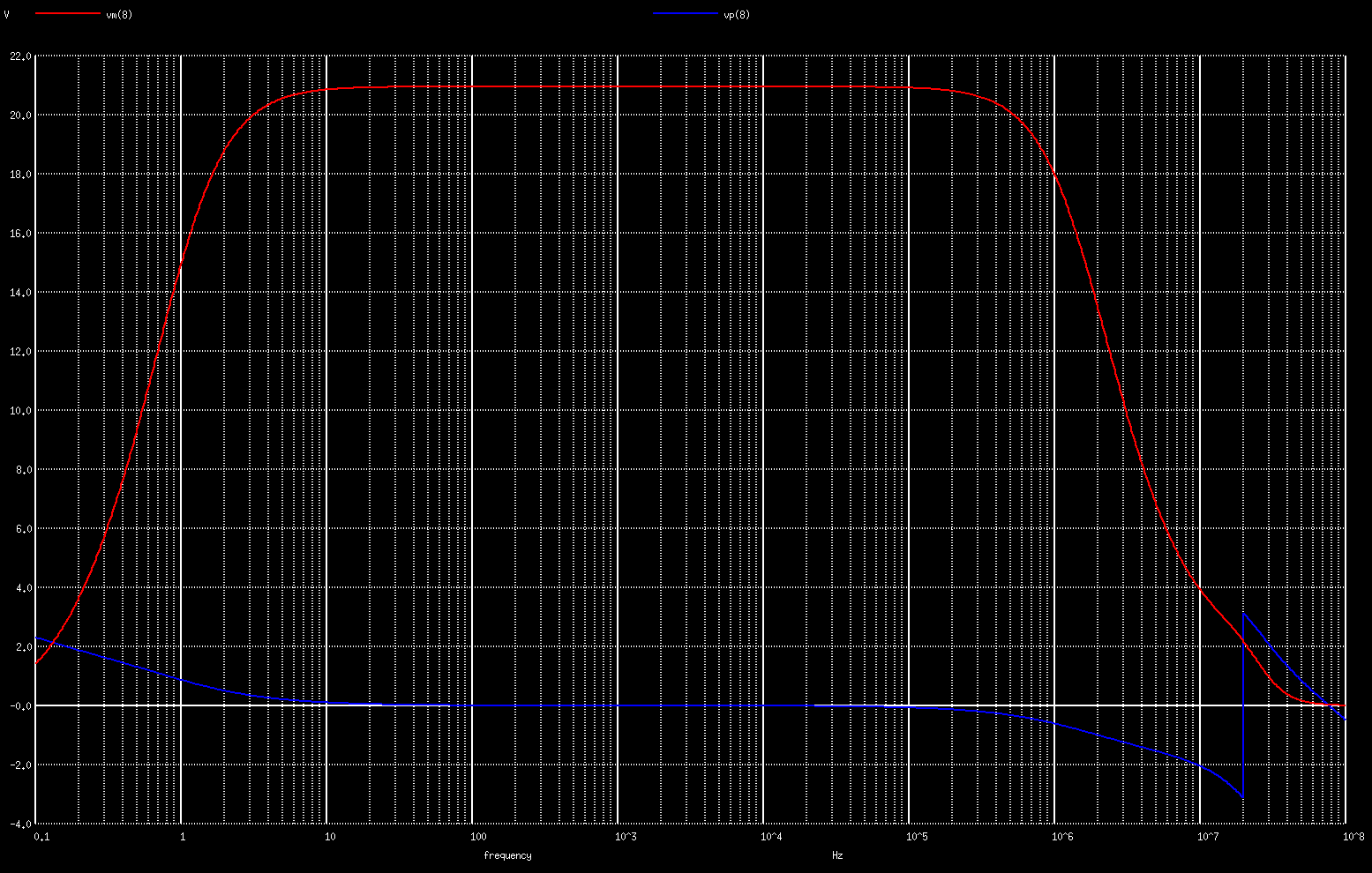

THD's at full power
Frec. THD(%) Amplitude Group delay (nanosec)
400KHZ 0.02638 29.48 5.7
200KHZ 0.01185 30.89 5.4
100KHZ 0.00559 31.29 5.1
40KHZ 0.00211 31.39 5.0
20KHZ 0.00096 31.41 5.0
10KHZ 0.00056 31.42 5.0
4KHZ 0.00045 31.42 5.0

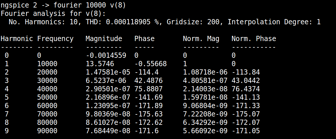

Attached the circuit and a fourier analysis at 10KHZ 13,57 Volts out, see the nice fade out of high harmonics content. I am sorry but I have only a .cir (text) file as I use a text mode simulator (ngsipce). DC servo not shown.

Thank you guys for the comments, this encourage me to take the next step, bring to life this little monster. The cascoded CLTP pairs, CVAS and the CB (complementary buffer) do the trick in simple and direct way, ... symmetry has it's goods. I totally agree with AKSA that the most important feature for human 'music quality' (lurking in his web site), is indeed how high order harmonics combine and fade out.

Much less than it seems ... 20 signal transistors transistor ..., 2 dependent current sources for 2 cascoded LTP, 1 complementary diff. VAS 2 complementary buffers with it's current sources and the output power follower, and that's all, no mystery. D. Self in his excellent book argues that a few more signal transistors and PCB area only represents a small percentage of the total cost, so it worth for a DIY project if it helps to achieve a blameless amp.

Complicated circuit ??.... That is simplicity city !!!:D This or something similar will be the LX1.0 (designing and building now) hope I don't run out of devices first.
I like your circuit, Artu. Perhaps a joint venture on the LX ??
I can go from your schema to a voltage board in hours.... do you mind ??? My only changes will be RED led CCS's , and what do Q12/14 do ??

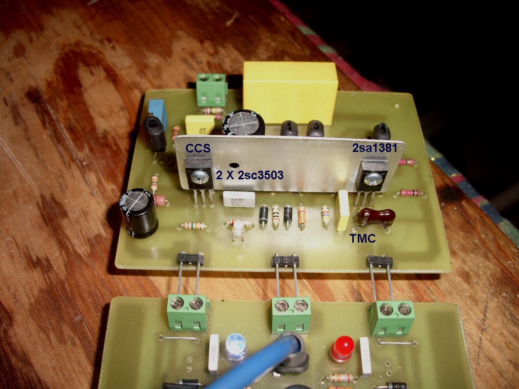

AX1.1 all done ... works great (with TMC)
I went the route of D. self... a "real blameless". Sounds nearly identical to the "blame ES" clone , just a little less bass "slam" at high volumes. I took a DPDT switch , using 1 pole to short out the big TMC cap and the other pole to open the FB resistor (Rtmc). (pix 1-2 - AX1.1 closeups)
TMC/no TMC sounded about the same at normal volumes , at moderate to high volumes , TMC had more clarity, depth ... the image deepened.. So , I don't know why the other "Camp" had issues with it . Actually , I do know why ... the ES has much less open loop gain than my AX/ BX.. (pix 3)
The BX , overall is the winner ... I went from 330-680R and 100/270 to 430p ,
I settled on 470R / 100 - 430p for all 4 amps. TMC was noticeable at high volume , and if I reduced the output stage bias. In NO WAY did the extra cap and FB resistor degrade the sound at ANY volume or in any of the combinations that I tried. Doug Self has essentially my AX on his desk and says he is excited :eek::eek: ... WHO YOU GONNA BELIEVE !!!

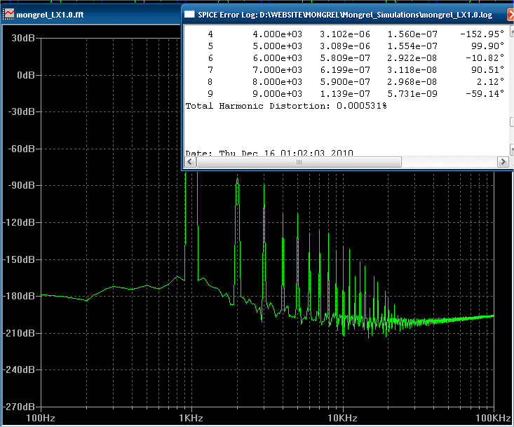

On to my next creation , The LX (leech clone) ... Artu , I really like your design besides the IC servo :sad: .... no cheeps here , all BJT :D yours beat mine :eek: (close to original leech ) by a factor of 7 (.0007 to .0001% - pix 4/5)
Mine is in the last attachment (pix6) ... let combine designs... I will build it (voltage stage). :)
