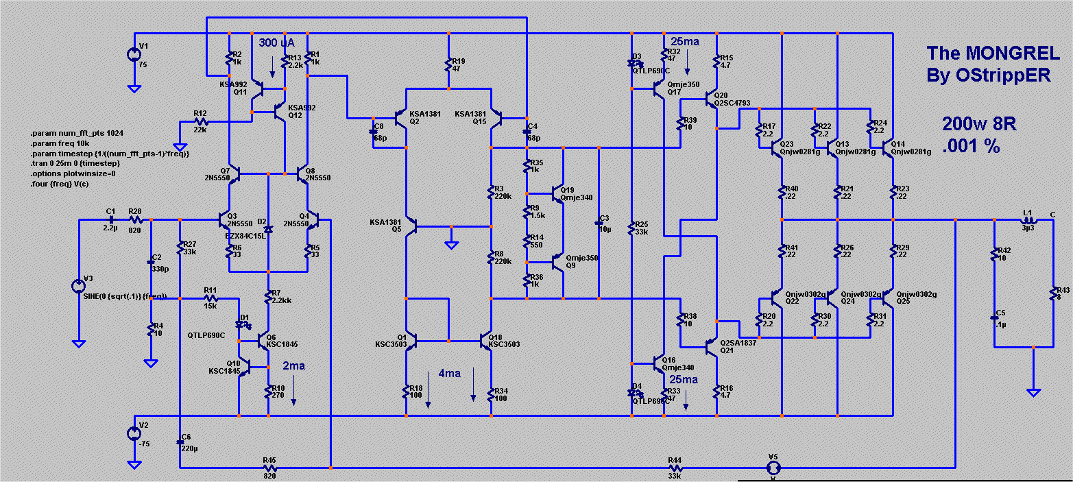

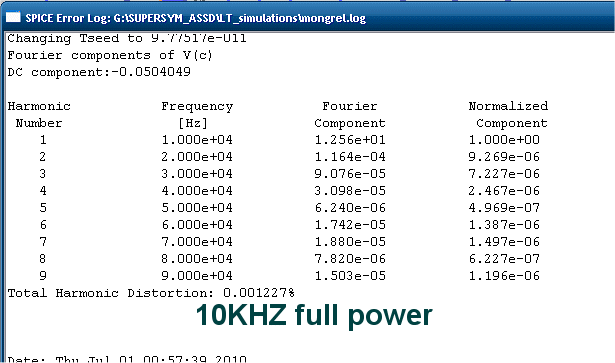

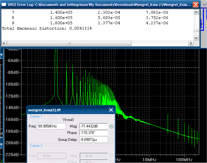

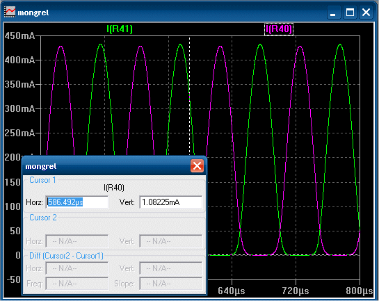

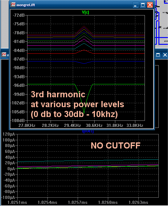

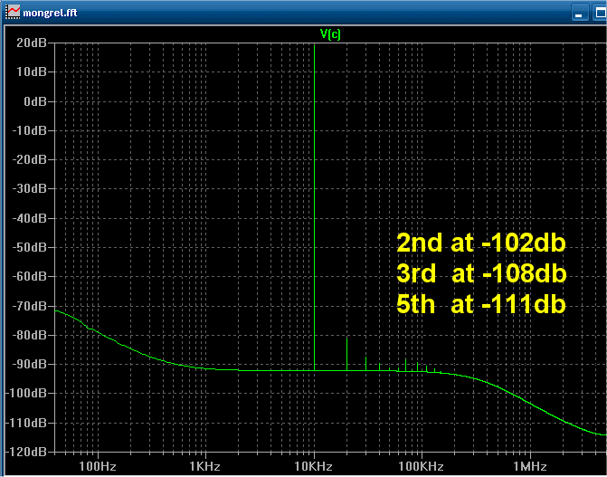

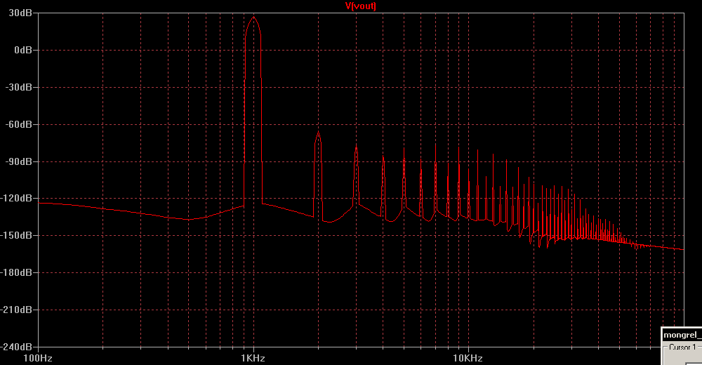

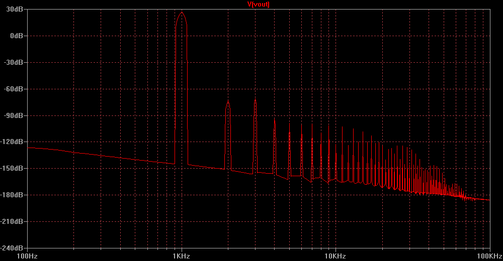

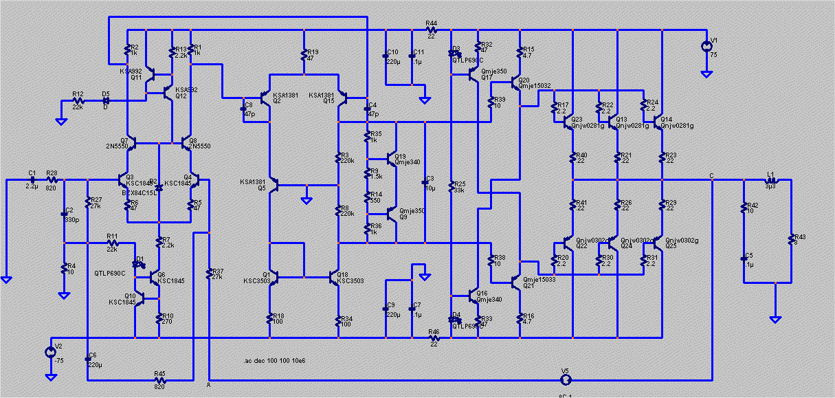

thanks Ostripper, I was curios is good to know that I can use Wolverine, and I made a "quick simulation" with the multisim 14 of the MONGREL CX 1.2 VB - "U" just to see how much power I can get with 4 pairs I be like omg dude ! "with all my respect of course" and it can deliver lot of power with just 890mV amplitude 1KHz sine wave to 8 ohms load about 310W impressive ! :bulb: wow !
yes with 85V DC supply I mean this is only to see how much power I can get before clipping and the THD is really low example with 10mV input sine wave I do not see on the THD prove noting but just 0.000% cool, on the simulation I just use traditional bias adjusted to have about 20mV on one of the emitter resistors, one note:
maybe I'm wrong, but R77 on the Mongrel PB250N/H Power Board R77 value is 680 ohms but I was not able to adjusted the bias on simulation correctly so for the simulation I change R77 to 220R and I get the simulation to work I'm thinking that multisim 14 might not behave correctly is probably that :) but any way I'm glad I fund this post about Mongrel PB250N/H Power Board
Regards
Juan
