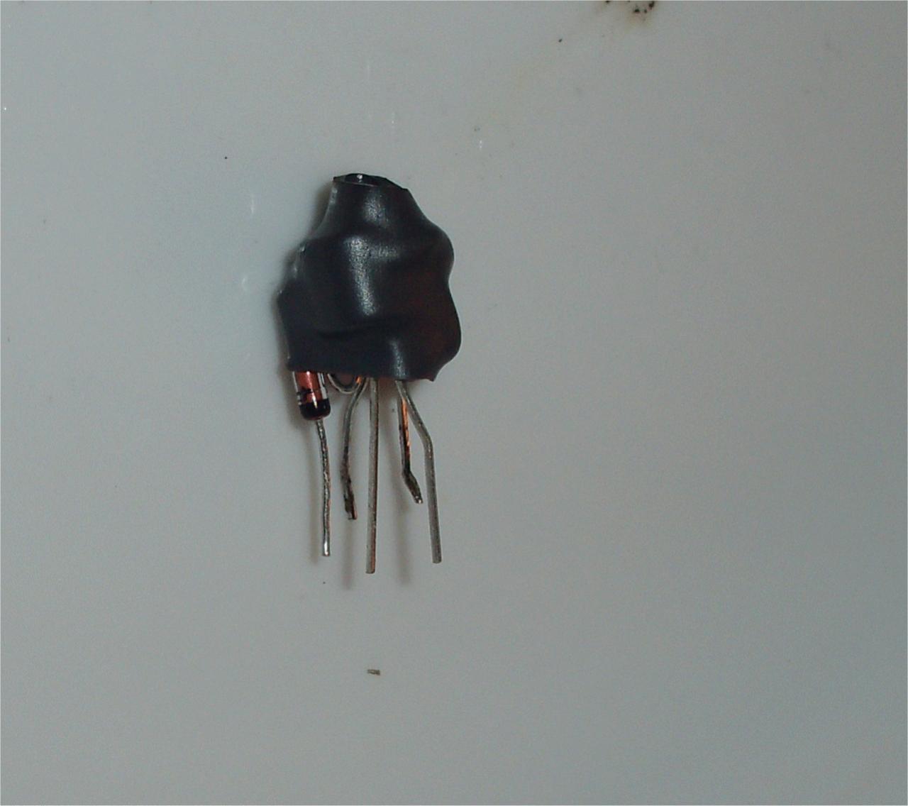

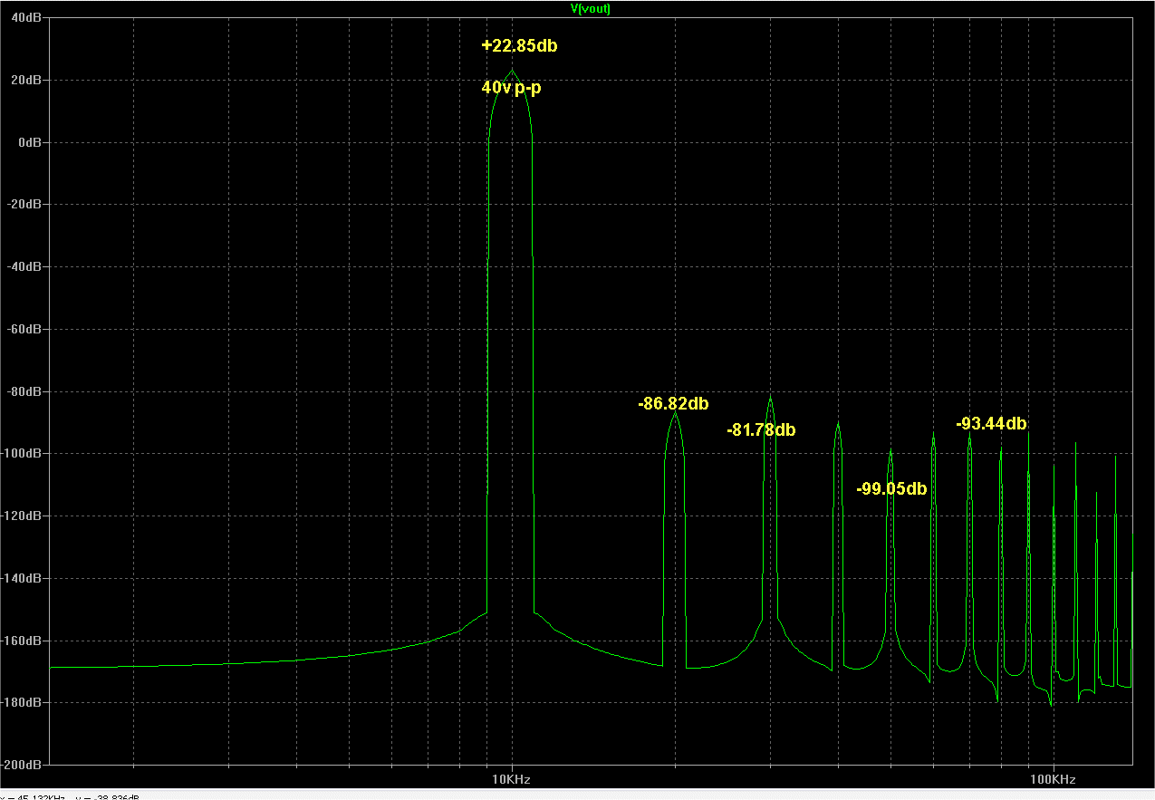

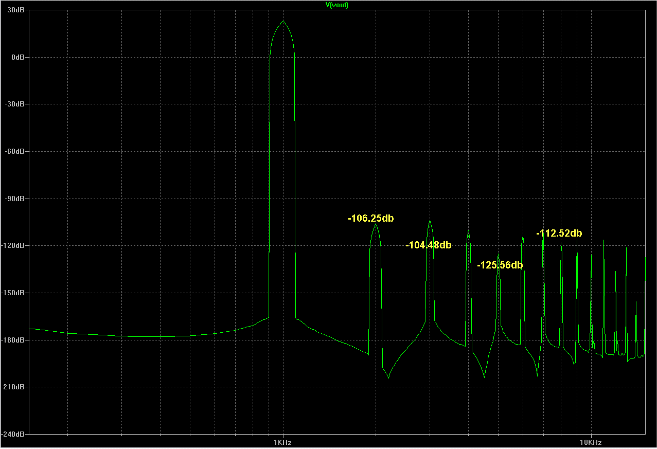

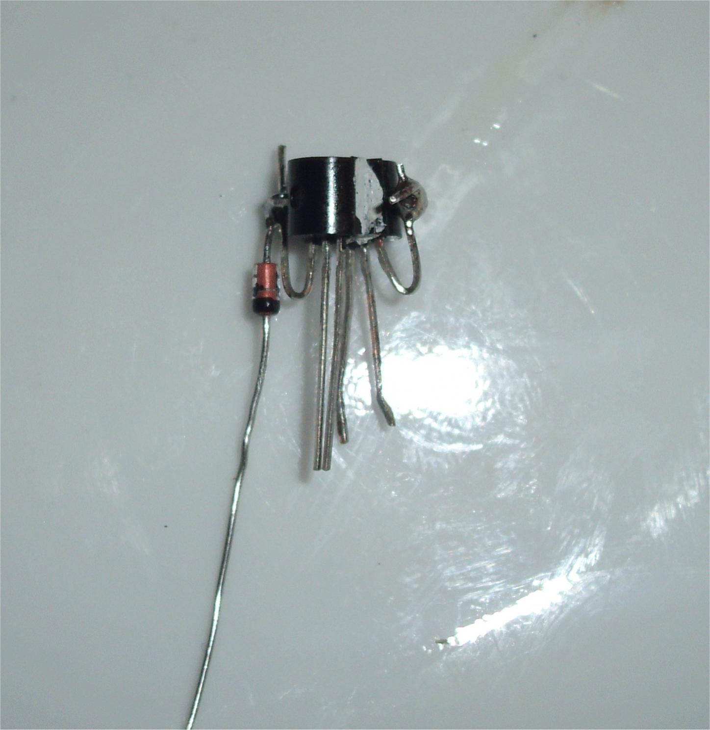

First 4 attachments show what LT says about the diode mod ( I don't 100% agree with LT - BTW). To be "action oriented" the last few attachments show a magic current mirror in the making...
last attachments are the real "magic diode" ...
I will give it a go.. enough small, subtle improvements add up.
OS

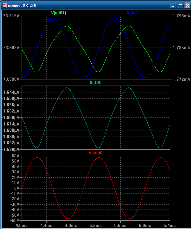

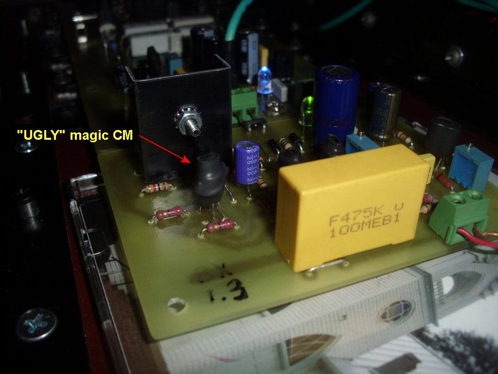

I have listened ... for hours (below - ugly CM's) .... can not note any audible changes with the diode/ CM. I did not let any non-objective statements or opinions sway my decision. Same music , 2 pairs voltage stages (w/diode - no diode BX1.3's) , same power supply/output stage and bias. NO change.
The only real changes were in the static tests , the diode forced current balance down to 1 microamp vs. no-diode 20-30uA. As seen in the LT FFT's , the distortion components were within db's and at the -100db level ... even "mountain ears" could not discern these subtle soundstage changes. Tried the headphones hooked to 220R resistors tied to the OPS ... NO change.
Tolerances of the current mirror degeneration resistors would offset the "micro" improvement of the CM current balance. And , I forgot to mention that the diode made the LTP LESS balanced in LT (slightly level shifted it). So ... thumbs down. :sad:
Edit: where this "diode trick" DOES seem to have major effects, is in a non-beta enhanced VAS where the CM/LTP sees more load (also according to LT).
OS

Thanks Pete,
Much appreciated. It seems that for most purposes the diode is a waste of time. That's good; it eliminates one more component, and one less part is less time and expense to make and more reliability as well.

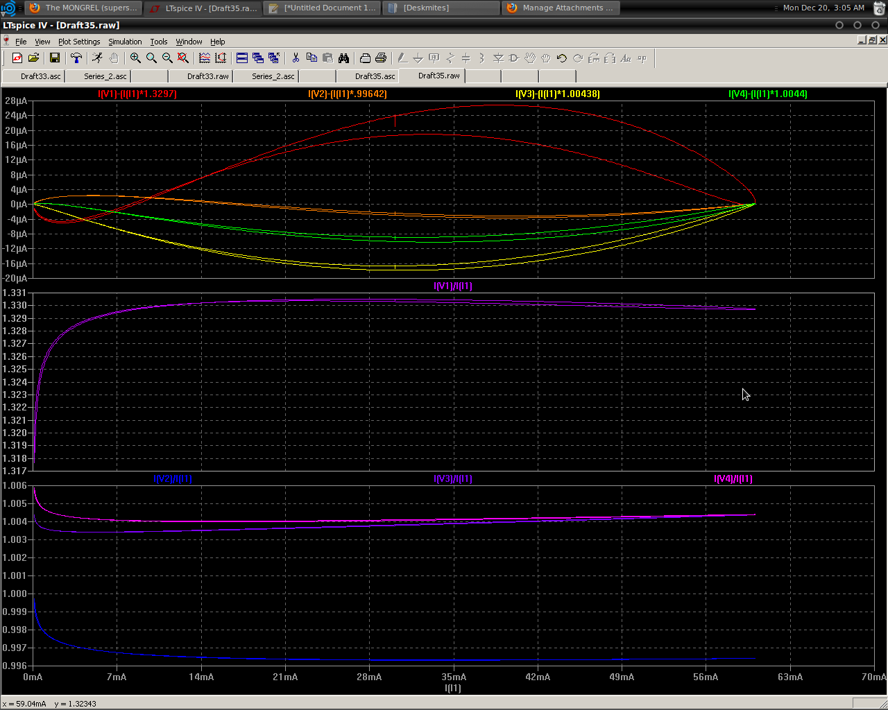

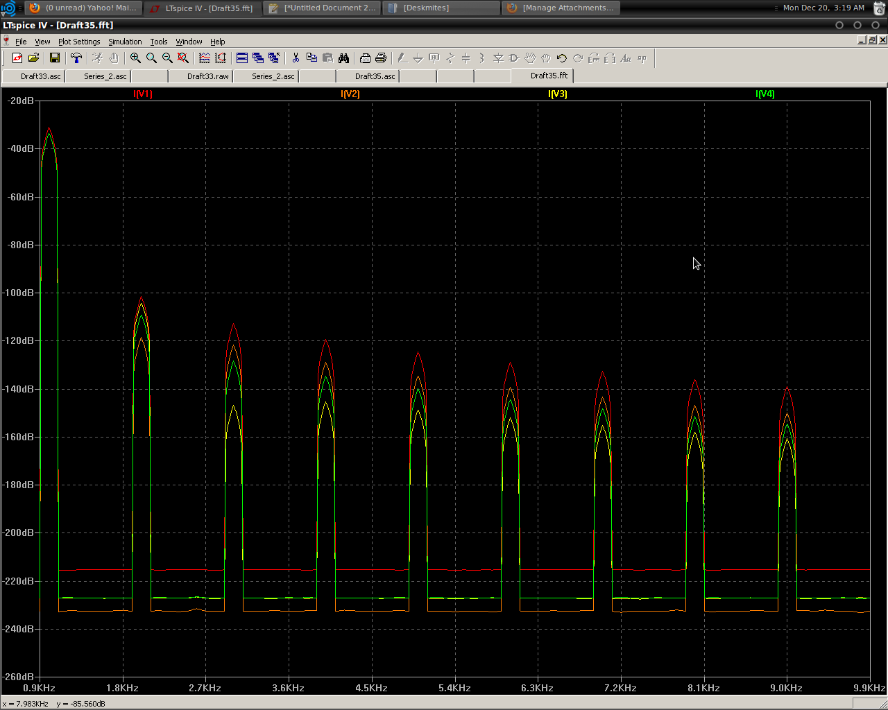

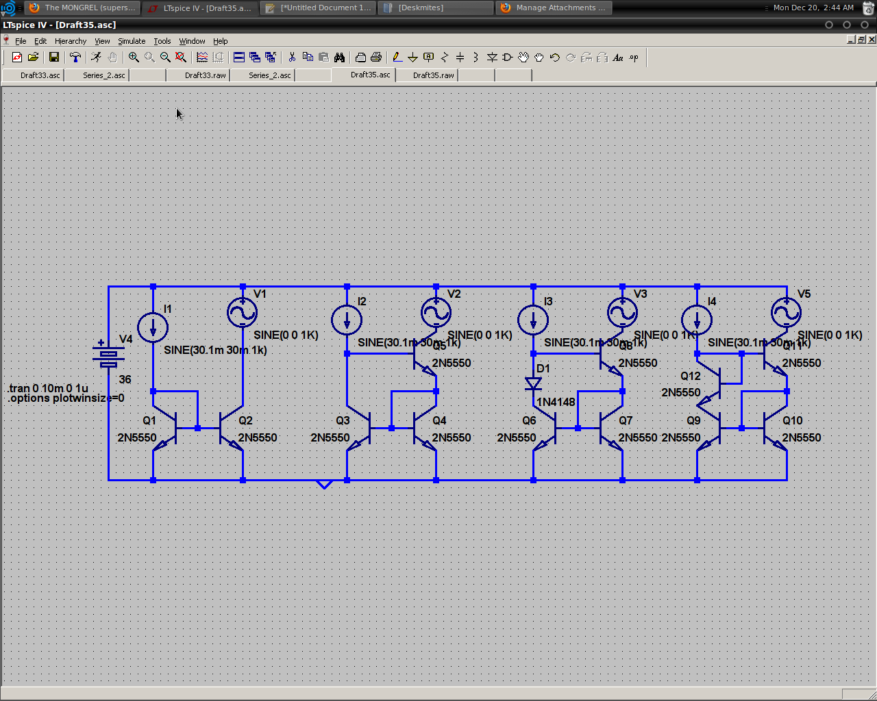

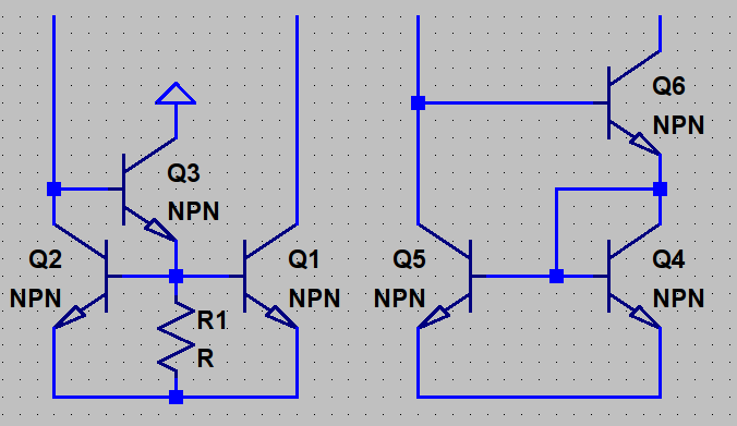

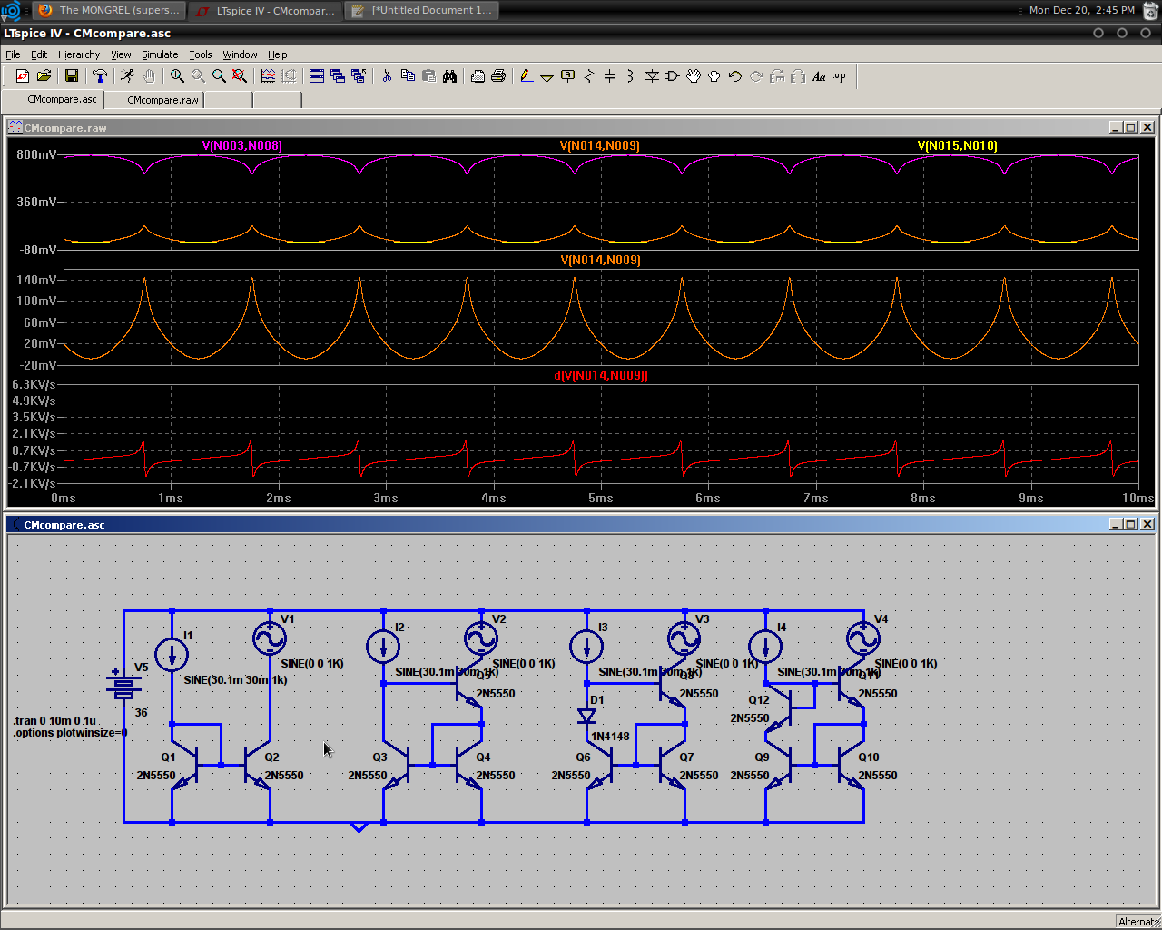

Perhaps the idea has merit, but the diode has only several uA flowing through it. Wouldn't this keep its voltage drop fairly low too? And how about trying a more capacitive, beefy diode? One could also use a third transistor, as per below. I also added a second variant for thought experiment - now the second transistor is the one with shorted C-B, the opposite extreme.
- keantoken
After some sims...

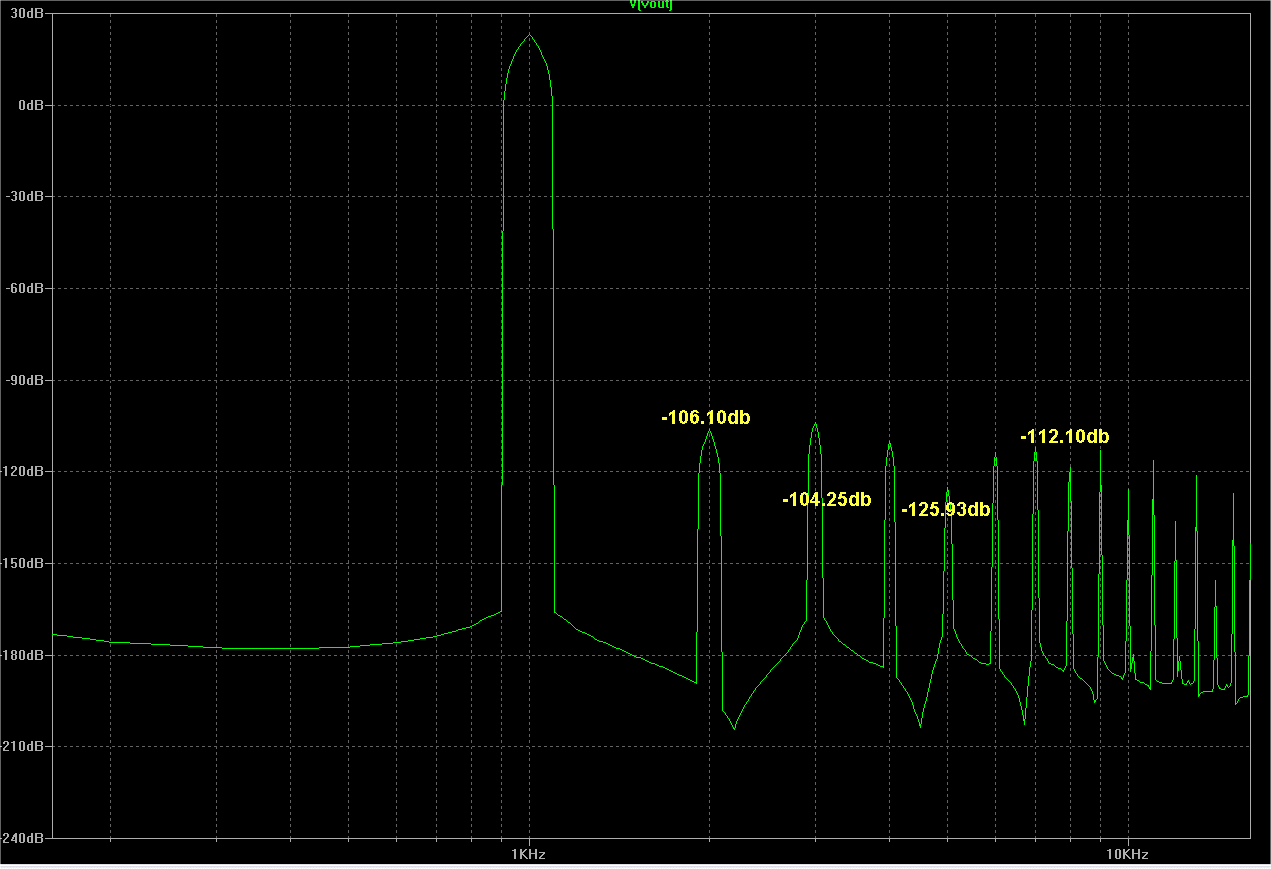

I tried to equalize Vcb for both transistors in the third example. Top graph is gain error. Bottom graphs are gain of the different mirrors.
Seemingly, Mirror 2 would give the lowest blanket THD, but Mirror 3 would give the lowest high-order harmonics. In fact, Some odd harmonics are even canceled in mirror 3. FFT last attachment.
So it appears that the performance of the CM will depend on what you put at the first transistor's collector.
- keantoken

Thanks for that , KT. It looks like the wilson will be in the AX1.2/BX1.4 CM, one more $.11 device will add to the other "micro-improvements". The other factor is that Nico'e ELD also successfully incorporates the wilson. :cool:
"GK" .. way back ... used the widlar enhanced CM. I tried it and did not like the results.
OS
Let me explain something I found about current mirrors. At low current excursions, the waveform peaks sharply because of the nonlinear diode characteristic (transconductance is low thus Dv/Dt is higher at the time input current changes direction). This peak induces pulse-like currents into the parasitics surrounding the device and can be the cause for some W_T_F moments (such as a "blip" that's always at the top of the output waveform). Interestingly, the simple two-transistor mirror is immune to this effect, unless you choose transistors with large Cbe (which should be avoided any high-performance mirror anyways).
For experiment, I tried adding degeneration to third transistor of the Wilson mirror. It still doesn't work quite as well as the diode variation. So it still stands that the harmonic profile and THD of the Wilson current mirror will depend on what you put at the first transistor's collector. In this case, a diode works better than anything else in simulation. See the attached plots for why. The orange trace is the one for the Vcb of Q6. As you can see, the diode distortion is curved the opposite direction... So apparently there is cancellation going on.
The lowest plot is the time derivative of the Vcb of Q6. This is representative of the current through any parasitic capacitor that sees this voltage. At 100KHz, full power, this can be a problem. :cool:
- keantoken

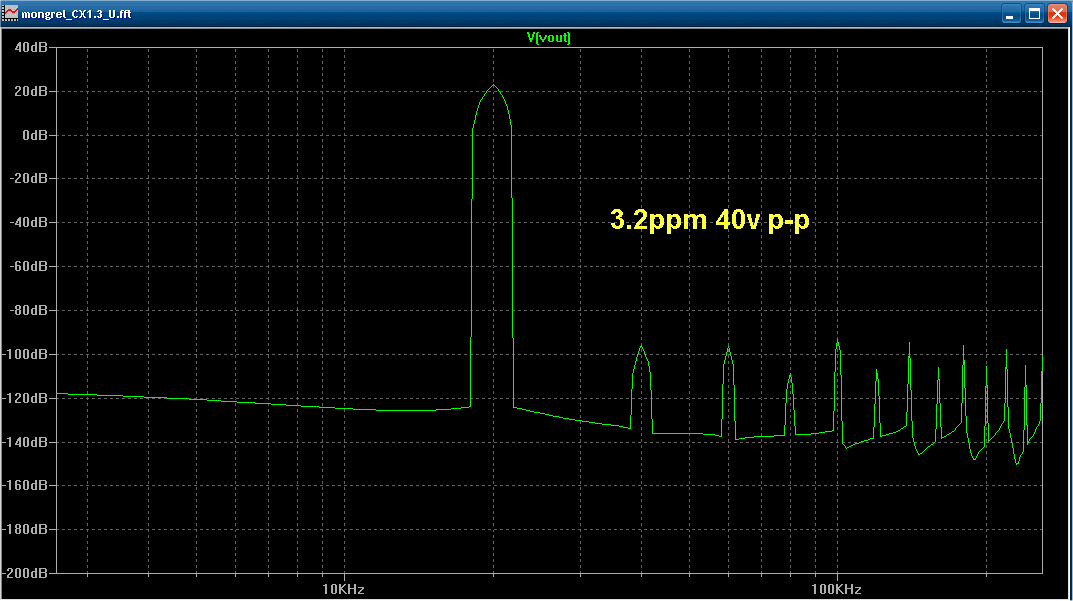

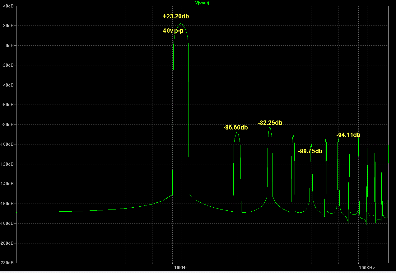

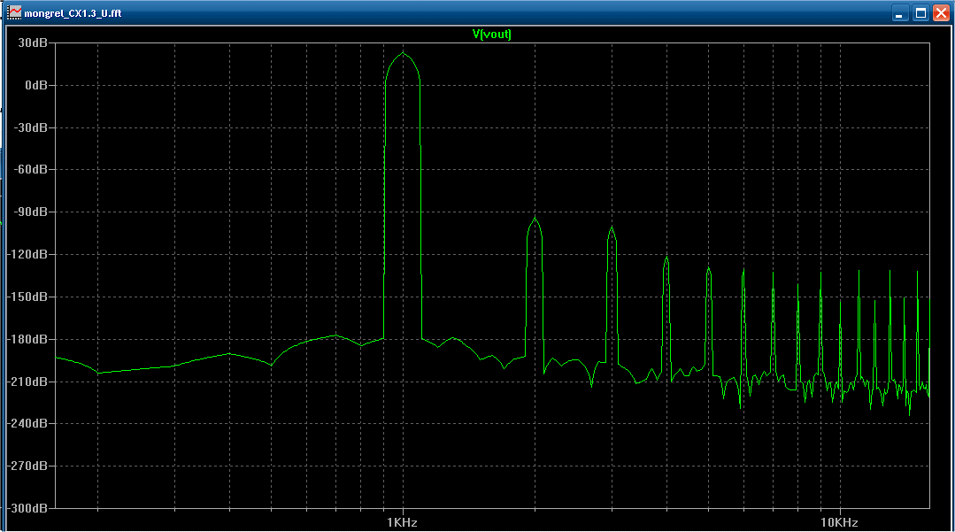

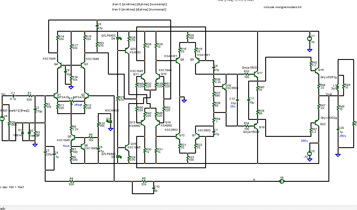

On to my recent FAILURE , I already have something better than the "goldmund killer" I just blew up (the cx) :eek::eek::eek: . Below is the best non-tmc'ed topology I have simulated. It is composed of a standard single ended LTP/cascode w/ current source. It THEN drives a full complimentary (leech) style differential set (like electrocompianet does) which drives a symmetrical dual differential.
WOW!! :eek: a lot of freakin' transistors. BUT , the performance matches a FULL TMC blameless and even exceeds it above 20K . over 100db loop gain and 125v slew. (below 1-3) PS , distortion is so low because BOTH even and odd are cancelled out in this one !
Stability is rock solid by either compensating the first differential or lead compensation from the VAS. I'm a gonna build it. A 100 x 100 mm VB (a little bigger). :)
OS
You don't understand , I stated why. single ended (first stage) cancels out even harmonics, 2nd stage (complimentary) cancels out odds. except for the vas , it is also mostly 14 cent transistors , just 4 to-126's , not much harder than a goldman/symasym. Why not ??, :confused: it's a hobby of mine . :D
