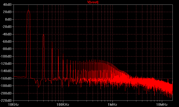

Homemodder, how do you like this? 60V pk-pk into 8 ohms, 68db GNFB. Perhaps with some more mods...
The output bias setting will largely factor in to the harmonic profile. I still don't know exactly how I should choose a bias setting. Slightly overbiasing decreases ultrasonic trash at the expense of H7 and co. "correct" biasing the way I figure it, decreases H7 and thereabouts at the expense of ultrasonics.

I changed compensation at the expense of low order harmonics, but everything above 5th harmonic is below 100db.
How does your amp perform into 10n and 100n loads?

Wow , this amp has ridiculous low 5th and 7th devilr: the evil harmonics ) Too bad everyone is too stuckup to build this amp. They would rather build schoolboy 30 year old designs and discuss blackgate caps and other esoteric B_S.
A shame , it is still simple , 25 components and a cheap $9 OPS (njw0281/0302) which can overwhelm any speaker out there.
Edit : 20k is impressive , too ... for a simple amp.

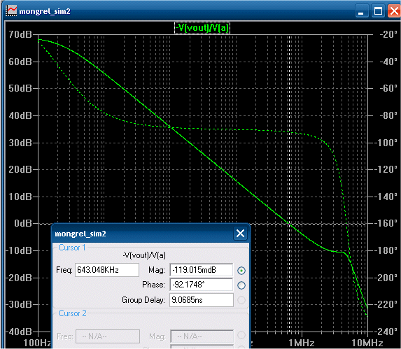

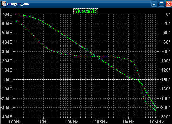

On my second sim , I tried to see if lower distortion could be achieved ... nope , BUT at very high power levels (120v p/p) , I did get better THD and lower odd harmonics.
At NO TIME was there any instability with BJT's like was mentioned in the thread. The improvements were slightly better performance and stability at high power and freq.

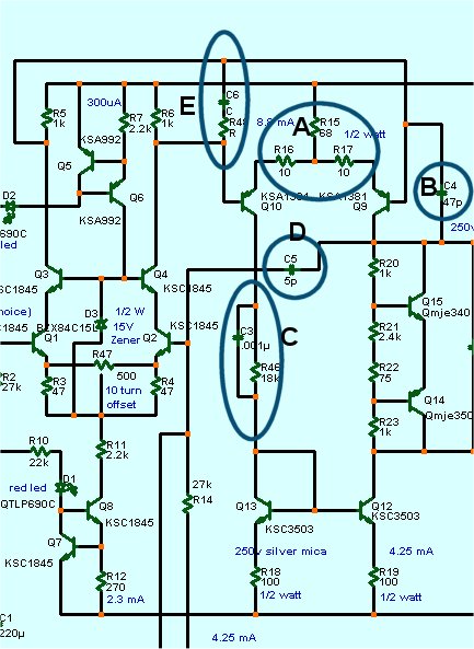

I'm not sure whether TMC is fully compatible with the Mongrel. The point is that TMC needs a high gain VAS (see the 'beta enhancement trannie' in one of my schematics), otherwise TMC is almost ineffective. Furthermore, as you already mentioned, it's indeed important (not to say mandatory) to use suitable trannies like KSA1381/KSC3503 instead of the totally obsolete MJE340/350.

Since differential VAS has no emitter degeneration resistors it's gain is high enough to try to use TMC.
Are you sure ? what are R15-17?(attachment 1 - A) A little change in OLG , big change in VAS current. TMC definitely worked , I just wonder whether it is really needed.
On to compensation , I now use just one Cdom (B - C4) , this works better than the original 2. What was odd was that the original 2 Cdom's seemed to sum together (unity gain "UG" was my benchmark). Removing the grounded base cascode from the VAS dropped my UG from 3mhz to 1.6mhz. At 1.6mhz I had the classic bode plot (attachment 2). Is 1.6 too high ?? , I simulated most of the classics (pioneer , sansui ) , they were under 1 MHZ UG. I saw they used either (E - attachment 1) , an R - C in the diff. ,or some form of (D - att. 1) , lead compensation either from the OPS or directly from the VAS.
On the mongrel , these techniques essentially did the same thing , as seen in [attachment 3] , dropping unity gain to 600-700khz and extending phase margin to higher frequencies. I just wonder which is best ?? .. compensating before (differential) or after (lead comp). various manufacturers seem to do it both ways.

Also, the d(x) plot function is a MUST! Use it! It will show you the higher order components in a trace. Use it on the compensation capacitors to see which ones carry the largest error currents.
