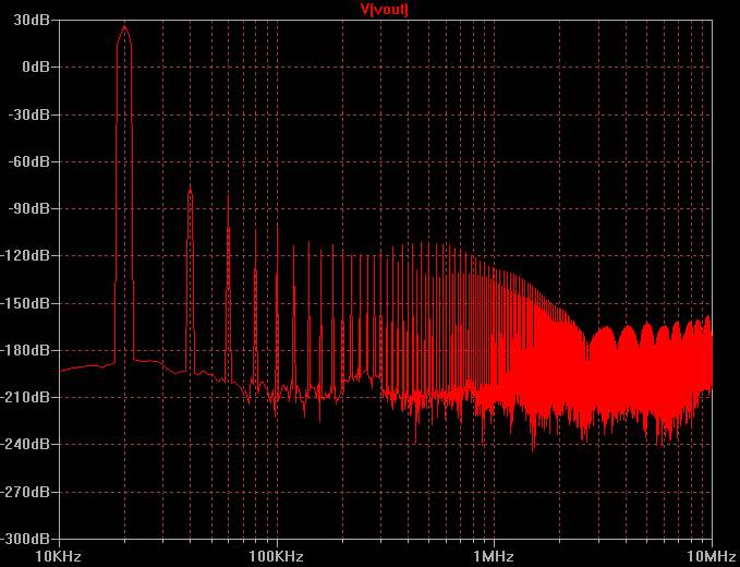

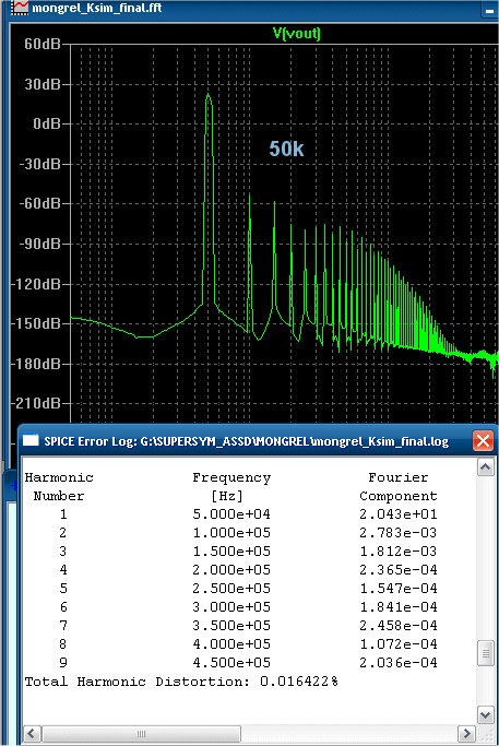

We are not dang BATS ! But anyway , what the heck , this thing has a bandwidth of over 120KHZ.
At 50K ... ohhhh .01%thd (below)
At 100k - .1% :eek: drop cdom 56p to 47p , .06% .. same as DX amp at 1k. :p

You right were not bats, it was just to show whats it capable of. Please dont call DX here, he doesnt believe in THD numbers or any other for that matter, I believe in the numbers as well as the sound of the circuit, and when the numbers are better the sound is just a little bit better too.
Ill rather leave the 50khz plots too, you are not going to like but any ideas how I can resize the captions from ltspice so that I can attach them here because of size restrictions.

Another member recommends plotting the lissajou between input and output (differential between input and output, output attenuated for cancelation of the fundamental) at 100khz.

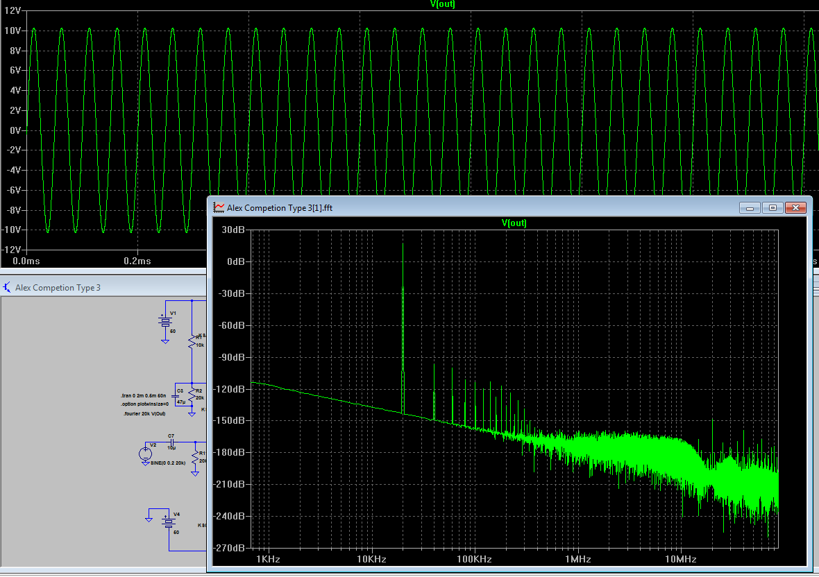

Anyway here are the plots, hope they come out.
Do, you think you can tell us the amount of NFB? In both db and the actual number please... Also, I would like to see the spectrum taken before the output inductor, since this attenuates the HF components.

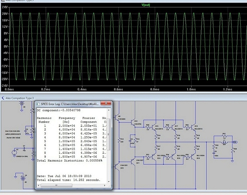

Ill tell you what Ill leave out the coil completly, thats how this amp gets used in car setup using 4 ohm subwoofers sometimes. It doesnt require any coil for stability, I put it on the sims so I dont have to hear wheres the coil from 10 30 members. How about 80v p-p, just 4v shy off clipping, so keep it mind. THD20 is now 0.0032.
Keantoken if you sim circuits with triples youll quickly understand how dificult it is to do, in most cases it always shows oscilation, just ask ostripper, he knows. The easiest way to avoid this is very high speed frontends. If you sim most commercial circuits using triples they will show that they oscilating but in real life they work just perfectly.

Actually I have to revoke my earlier comment about that FFT. It looked bad to me since the higher order stuff was near the level of the low harmonics. Actually I see that the higher order stuff is on the same level as your amp, but the low order harmonics are very low. That's the funny thing about OLG, no matter how much of it you have, you seem to get the same level of ultrasonic harmonics.
I'm not sure, it may have appeared that I was making a malevolent comment but that is not the case.

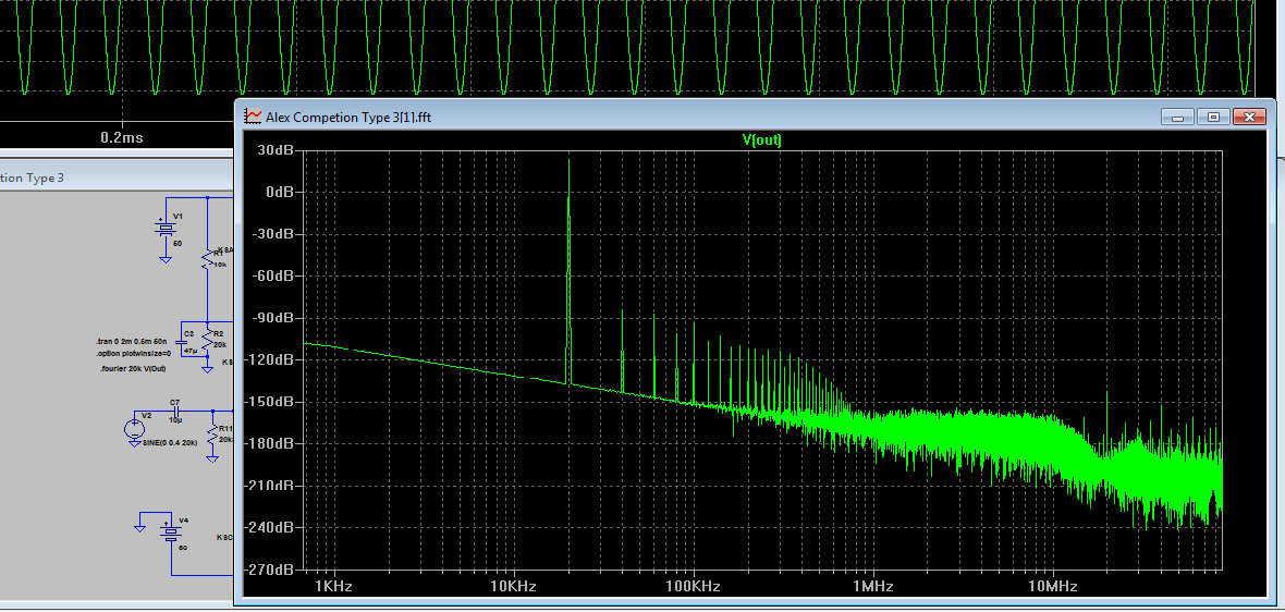

Thats just it, the harmonic spectrum barely changes from low power to full power, even upto 50KHZ full power, Ill show you a 20v p-p plot, Here THD is 0.00024 at 20KHZ, as you can see the amp has extremely low noisefloor, so it can show these levels easily.

Homemodder, the noise floor in LTSPice has nothing to do with the circuit's noise. It depends entirely on DC drift and and bit accuracy, etc. That is why for almost any amp, I can get the noise floor in LTSpice down to -240db.
Gimme the .asc file and I can do it to yours too. ;)
