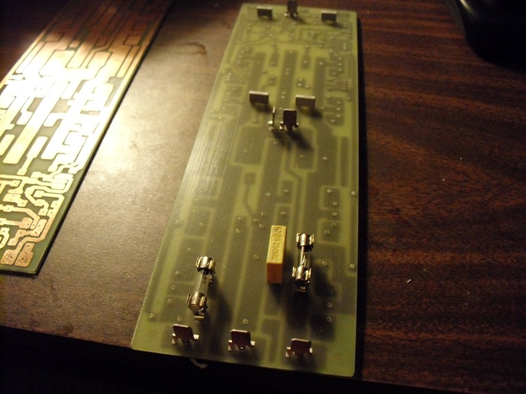

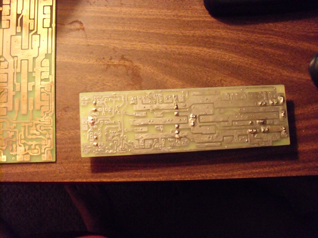

Thanx , Jkeny ... Fab in a box is alright. It lacks specifics in its instructions. To make a long story short , I bought a $60 laminator for 15$ .. it heated up to 120-130C this was not hot enough for my HP toner (read that it melts at 160-170C). I disabled the T-stat on my laminator (GBC115) it got above 150C and the toner transfer paper worked VERY well ...when fused, the paper floated right off PCB after 10 sec. The green foil is real cool , if your toner is sparse or pitted it welds a green layer just to the existing toner... the bad thing , it melts at 120-130. SO , to use their stuff , you need a REAL good laminator , adjustable t-stat and all. BTW, I fried my laminator. The stupid internal frame was PLASTIC... dang chinese junk. I need an iron or something.
The good news is that the 2 PB250's are done and getting stuffed BUT no GX's before I get an iron. PIX below..

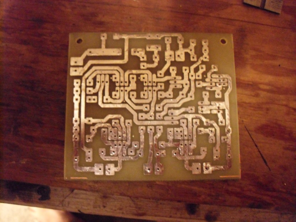

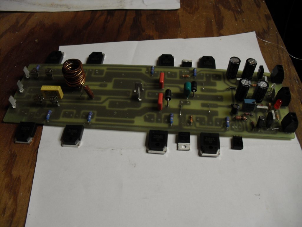

The winner of the toner transfer test is........ THE MAGAZINE PAGE !! A high clay content page from a playboy book :) or "southern living" brings out the best quality to cost ratio. Below is the best I have done to date , the GX and AX , all tinned and ready to stuff. Better quality than photopaper and about the same as the uber expensive "fab in the box".
The PB250's came out beautiful , they will be very durable and musical power stages. (below ).

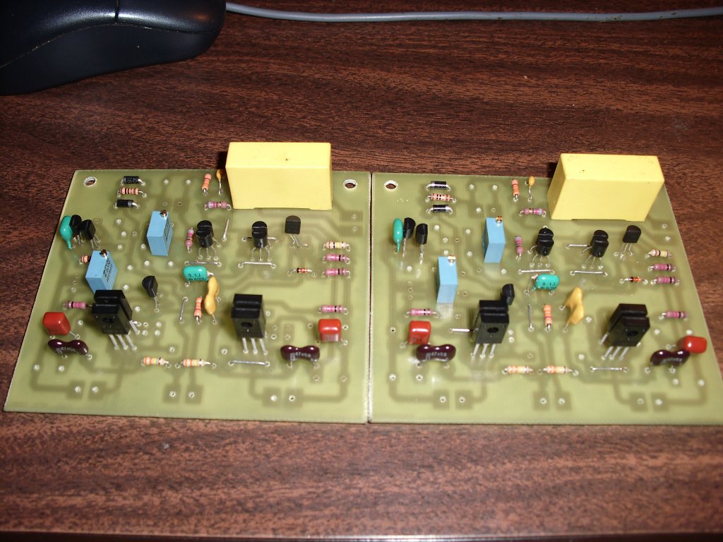

GX1.2VB is born !!
Enough stuffing for tonight. One thing I have to say ,is this sure beats hand drawn projects. Every part fits perfect , boards are more compact and you can really fine tune the layout. (pix below)
REAL SOON I will be a "crankin' this baby. :) I do want to run these boards in isolation on a test PS first.

ANY clay based glossy publication works , like soldering .. there are a few "tricks" ...
1. after lining artwork up , place iron directly down and press to make it stick to the FR-4 (will smudge if you dont).
2. Then place a piece of plain white paper on top of artwork to slide iron around on.
3. after board heats up and re-fusing is almost done , place iron direct to the glossy magazine page.. you will see the relief of the artwork come "up through" the page.
4 .soak in soapy water for 1 minute , start peeling any paper that is already soft and even peel the first layer of paper off the whole board. rub the rest off with your fingers .. remaining paper will form small balls as it is rubbed.
5. board cleanliness is paramount. Lightly sand with 220-300 grit paper , then clean with pure isopropal alcohol or acetone.
6 . for tinning , I actually use the higher temp. Cu/Sn solder after coating the foil side with a light coating of plumbers flux.
Those boards above have NO , not even one.. jagged line or pit. Perfection.
