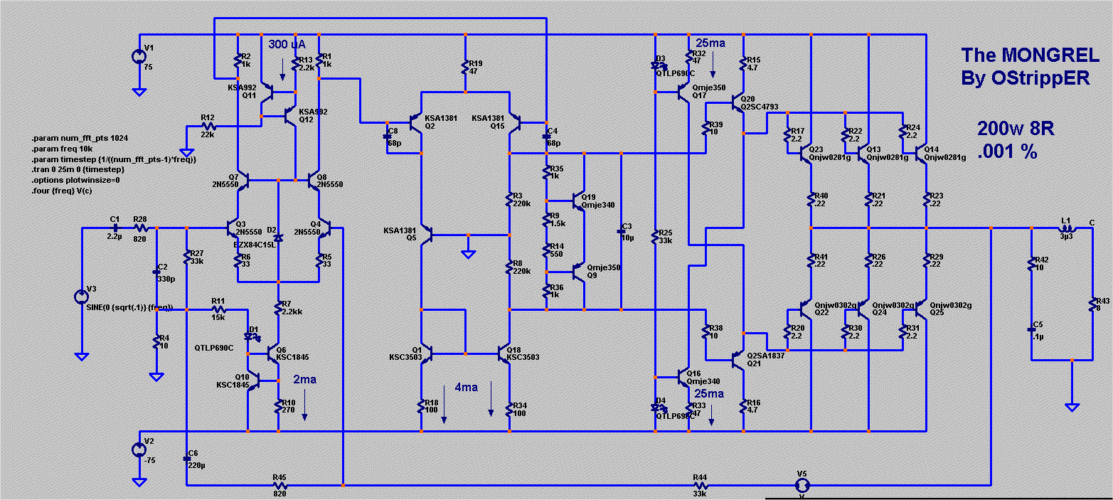

Hello Ostripper.
I have great confidence in your amplifier design knowledge.
I find it a bit hard to find out what schematic/amplifier is discussed.
Visiting your Mongrel website did not make easier.
There are AX, BX, CX, GX and god knows what ....
But the current complete schematic of Mongrel I did not find out.
So I comment the schematic in the Topic.
Which was set in first post, as usual.
After looking some minute, there is nothing strange.
What differs from many other is 2 things:
1. The cascoding arragement in input.
2. The bias of drivers using CCS.

Lineup , my man... if you read further, I decided to go modular. This can be good for the environment and for the DIY'er. AX,BX, CX , and GX are done. In Fact , I have enough FR-4 and parts to build them all. Then I can do a subjective/objective "shootout" to see what is better/best. (I think GX will win) Mongrel means "mutt" , you can add any of the 4 voltage stages to the 2 power boards to get a custom amp.
Edit , the "CX" is the original "mongrel" , you can take that one (it is in my living room now) and make a little 60watter or go nuclear and make a 8 OP device kickbutt amp.
Below is the madness... you can "plugin" any amp you like!!
OS
What's wrong with the cascoding arangement?
(I'm thinking about connecting the casodes Zener anode to ground insted connecting it to the tail CCS. Still not sure about this... )
