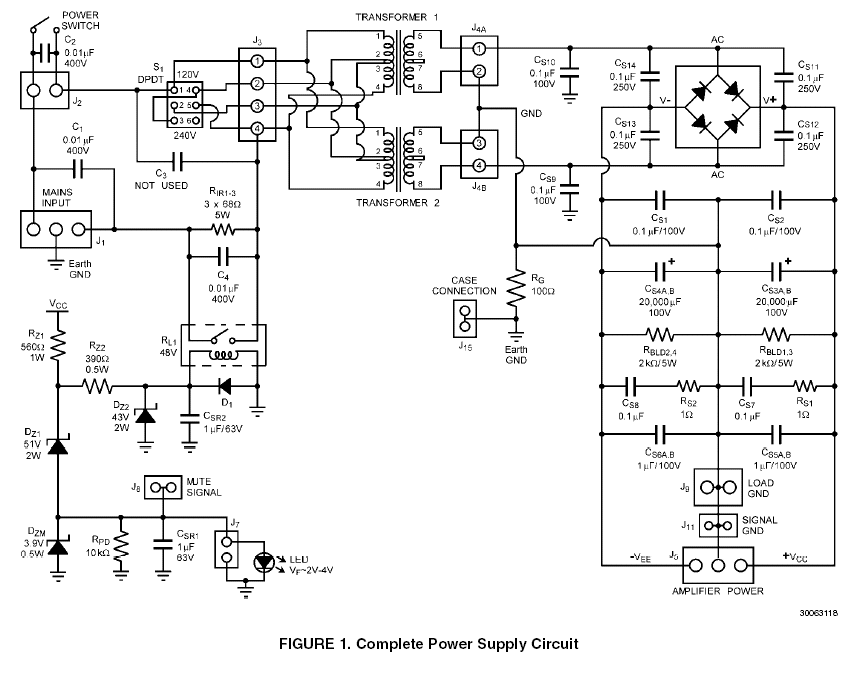

Here is what national semi says about it : http://www.national.com/an/AN/AN-1849.pdf
(also attachment below)
They seem to do it like the quasi with signal , load (speaker) and amp grounds going right to a main PCB star. the only connection to the chassis is Rg , a little 100R component. CT goes right to the capacitor bank. I think I will leave all options open and allow 2 extra fastons between A and B.
This is the PS that national uses to make for the best reference of it's LME line , so I can assume the research is already done.

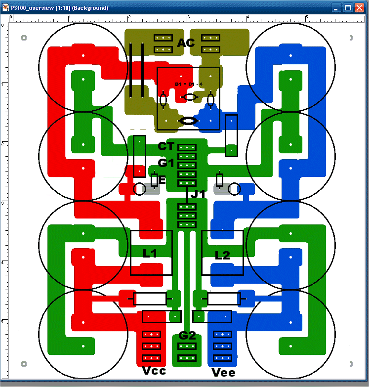

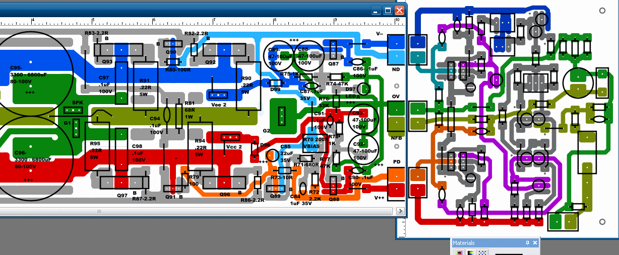

Taking that advice , which "jives" with chapter 14 (D.self audio amp handbook) , I redesigned the ps100 (1st below). Knowing that the "dirtiest"
pulses are where the 1st set of reservoir caps meet the bridge rectifier , G1 from the amp boards (output transistor decoupling) is the only connect here.
G2 , which is the cap multipliers and voltage/signal board are tee'ed off the 2'nd half of the main star which is split by a wire jumper as suggested by Andrew T.
This arrangement also coincides with the national semi app note:
Used the general layout rules of the app note.
It is even better with the split star , leds (so you don't die) , CLC and more robust construction. For a maximum rating , this board will do ..

Hi ostripper,
Even though I haven't done this myself, I'd be tempted to put your on-board star earth on the output side. Allow for a connection between A and B either via a link or use quick connectors so you can experiment. I'd also allow for an off-board star earth. In short, allow it to be configurable. While you are at it, move the LEDs to the diode side and allow for a cap between AC1 and AC2. When having a takeoff point between 2 caps make sure it is from the middle of the caps.
I plan to do something very similar to prove to myself that all this actually makes a difference. I'm planning for a resistor after the diodes, so RCLC. I have a feeling it won't make much difference. ;)
regards
As you see , your suggestions as well as the others are implemented. A real "mongrel" power supply. :D
OS

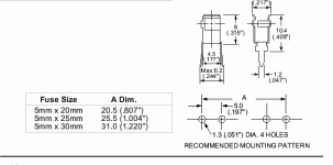

Hi OS
It looks like you've completed the revised PB60LPV1.1. This new form-factor and layout is much improved!
Taking a closer look, the fuse length of 25mm seems unusual. 5x20mm or 6x32mm (3AG) is more common.
Also, the overlay drawing implies the output inductor/resistor assembly is being done differently?
Hi OS
All for the people .. cheap power to the people!! Thanks for the "closer look",CSY. I added 1 -40 pixel hole to use either the 20mm or 25mm spacings, the extra trace space is there. They do make 1 " (25mm) fuses. 20 and 25mm are most common at Mouser. I use the datasheets (below-1st attachment)
to determine lead spacing and even add holes for the most common TWO components that mouser stocks in great numbers.
00300210N Littelfuse Fuseholders, Clips, & Hardware
These boards are made for what is out there..man.

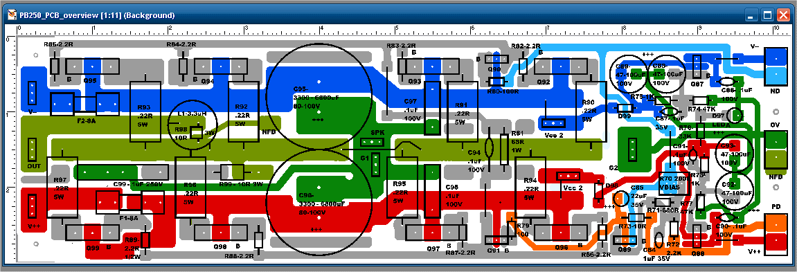

I also reworked my "BABY" , the PB250 (2nd attachment). Shorter traces , ability to use second PS for voltage board/cap mult. (Vee2/Vcc2 connections).

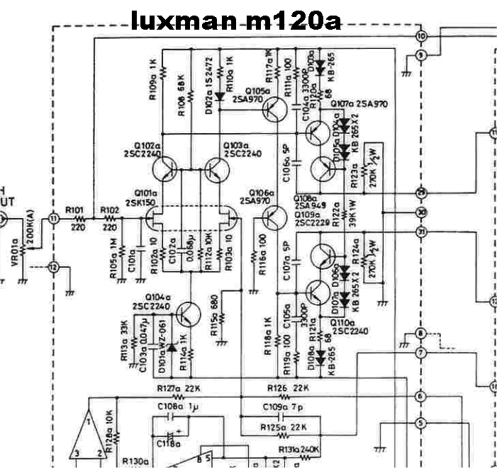

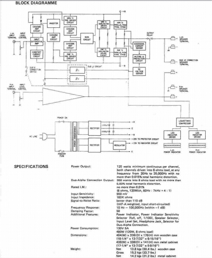

Luxman M120 - very highly regarded.
Very strange , while working on my APT1 , I came across the schematic for the Luxman M120a. Very similar to the APT(attachment 1) , but more refined. I liked the use of the FET's at the input and simulated for both the bipolar and some J201 FET's.
There are plenty of VERY good reviews of this group of amps - M-117, M-03, M-05, MX-100 ..
Luxman C120A/M120A how good? - AudioKarma.org Home Audio Stereo Discussion Forums
and many , many more..
They say it has killer bass , smooth airy soundstage. The best thing I can see is that they use the 2sa970/2sc2240, which is a dead match for my a992/ksc1845's. Upon my first simulation it worked very good , in fact , it matched the spec (attachment 2) at .013-.015% all the way from 20hz - 30khz. I tried the simulation with both 2sj201 FET's and the BJT's. With the BJT's the THD dropped to .005% even @ 30khz/200w.

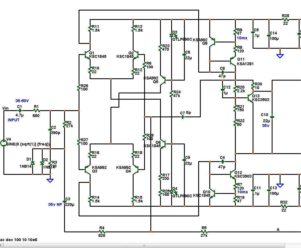

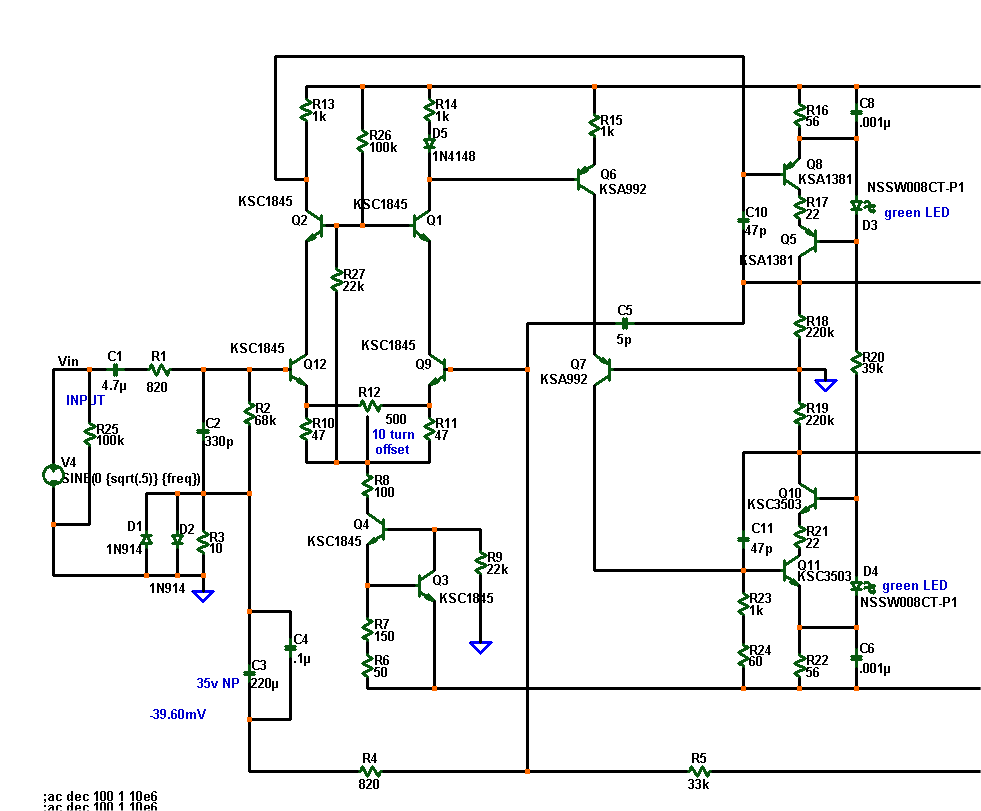

I could not leave well enough alone , so I added a better CCS , 2 real compensation capacitors (2X 47pF). Another little addition:
http://peufeu.free.fr/audio/memory/memory-5-vas.html
The "magic" resistor (another one!!) This halved the 5th and 7th harmonics which correlated with the French audiophiles listening tests here:
Memory Distortion Philosophies - Part 6 : Moment of Truth
Also in (attachment 3) R6 is the adjustable CCS and R24 is the gain adjust for the level shifter. 50R for R6 gives 1.3ma per input device and 60R for R24 balances the LTP at low freq. (attachment 5). Once you do this at 100hz the input stage only get more balanced as you increase in frequency...finally getting within 3uA at 20Khz.
I like the symasym and the DX style topology but for my first voltage board to use with the PB250 , I have decided on the GX (attachment 3/4). You can't go wrong with something so simple that has the strange tendency to have rock solid THD all across the audio band and even into the ultrasonics. Mr. Holman (APT1 designer) said that he found the most linear voltage stage and THEN applied negative feedback to it. I think the Luxman beats his amp hands down even as they are essentially the same.
This amp is not PPM (who gives a poop? :D) , but has the strangest THD characteristics and a lovely harmonic structure (better than the symasym).

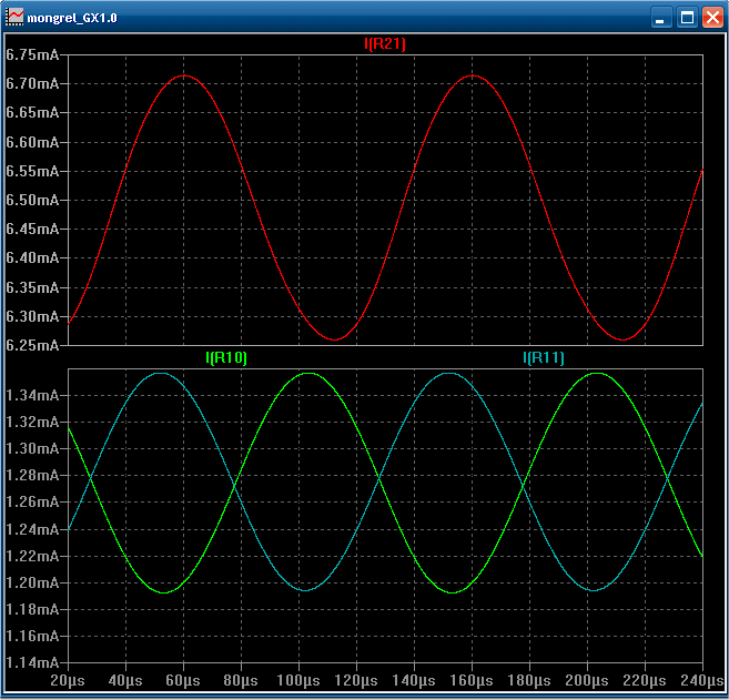

OS, be bold. Nothing wrong with going out on a limb... There was apprehension about my headphone amp but it's stable and playing beautifully into my 8inchers! It has not blown up despite being abused with 4 ohm speakers.
I was nearly sure the funky compensation would not work... But it does. Try getting 46db OLG at 100KHz! (on that note, look at C104a and R111a, and notice Cdoms are only 5pF... This is very much like what I use in my headphone amp and have simulated on power amps before)
With the bold approach however, you've got to go the whole hog. Be thorough. If there's a way to make it work, be sure to find it. It may be demanding, but so are most things worthwhile in life.

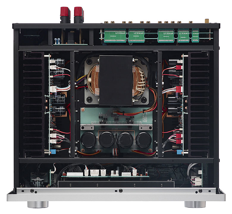

Salas , the L-590A looks just like the L507u (attachment) the power supply , amp boards everything. I have the schema for the 505u and it is a 100w class AB with the same topology as the M120a. It seems Luxman stuck with what worked ... and sounded good.
Since the amps boards look EXACTLY the same , I wouldn't be surprised if luxman just use the same board with lateral mosfets and Bias them into class A. I did this in my simulation with IRFP240/9240's outputs and matched that .03/.005% spec exactly.
I am going to have 2 X the new luxman 509u in my PB250/GX combo powered by my 1KVA+ 30lb. toriod. So for 1/20 the price of the real thing I get twice the OHMMPH!! :D

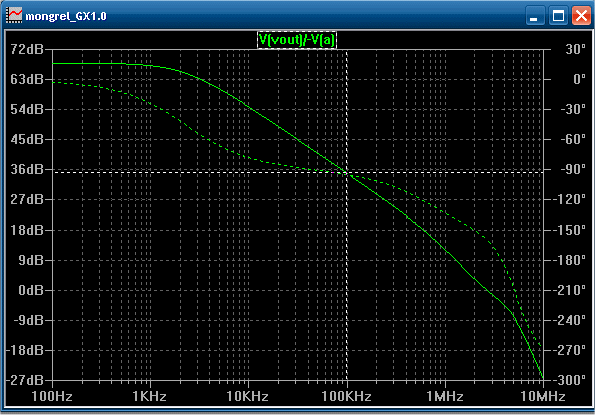

I was going through your pictures, OS. I think I went through several hundred files, just looking at thumbnails on the HTML's. I noticed someone downloaded your entire PDF folder. Sheesh! At least make an appointment!
- keantoken
I got 36 db at 100k with 5pF. This is the only simulation I can go that low with except for Roenders RMI folded cascode amp.
The main reason it's discouraged I think is that if you screw up, there aren't many around that can help you, few people go down the rabbit hole. That's not really a problem on DIYAudio, right?
