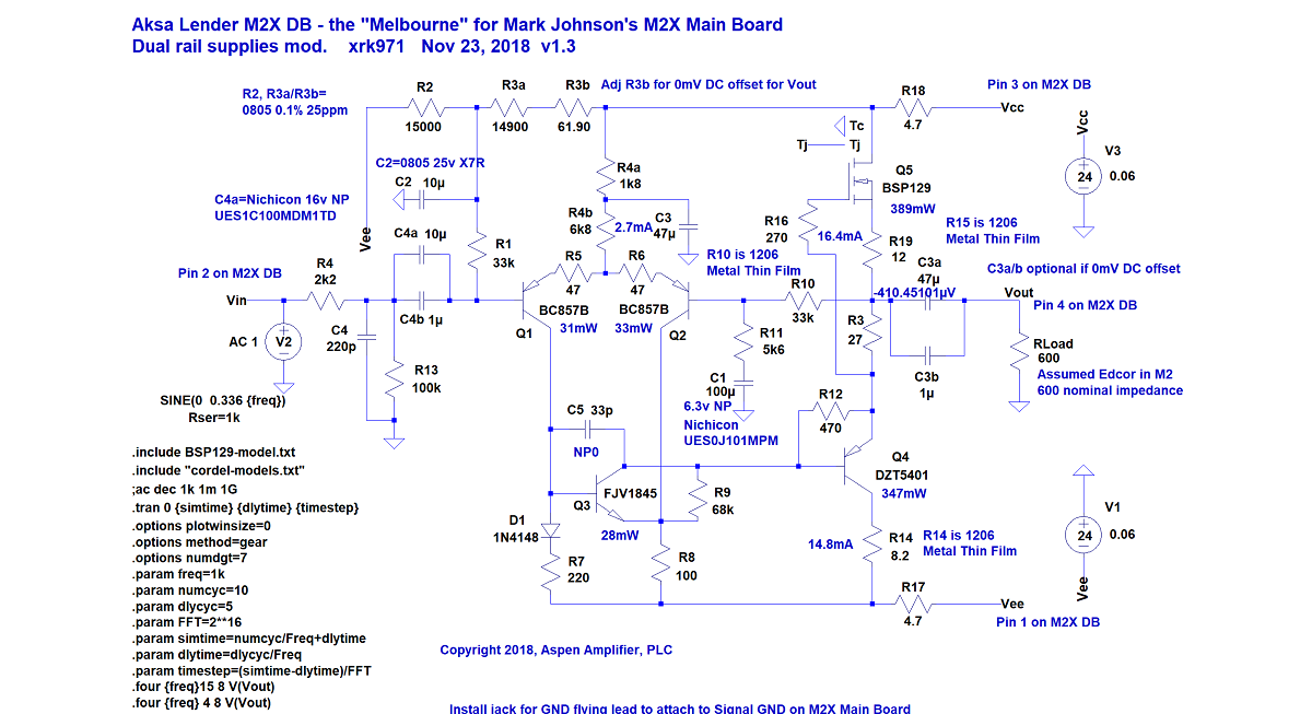

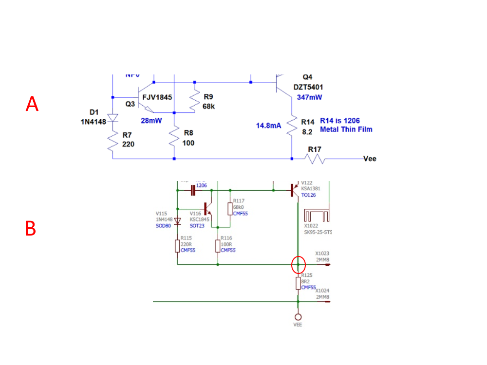

Thanks. I take it then that it's not critical whether it connects like "A," as in your first schematic, or like "B," as in the "JPS" schematic? Of course, beyond sensing a different current.
