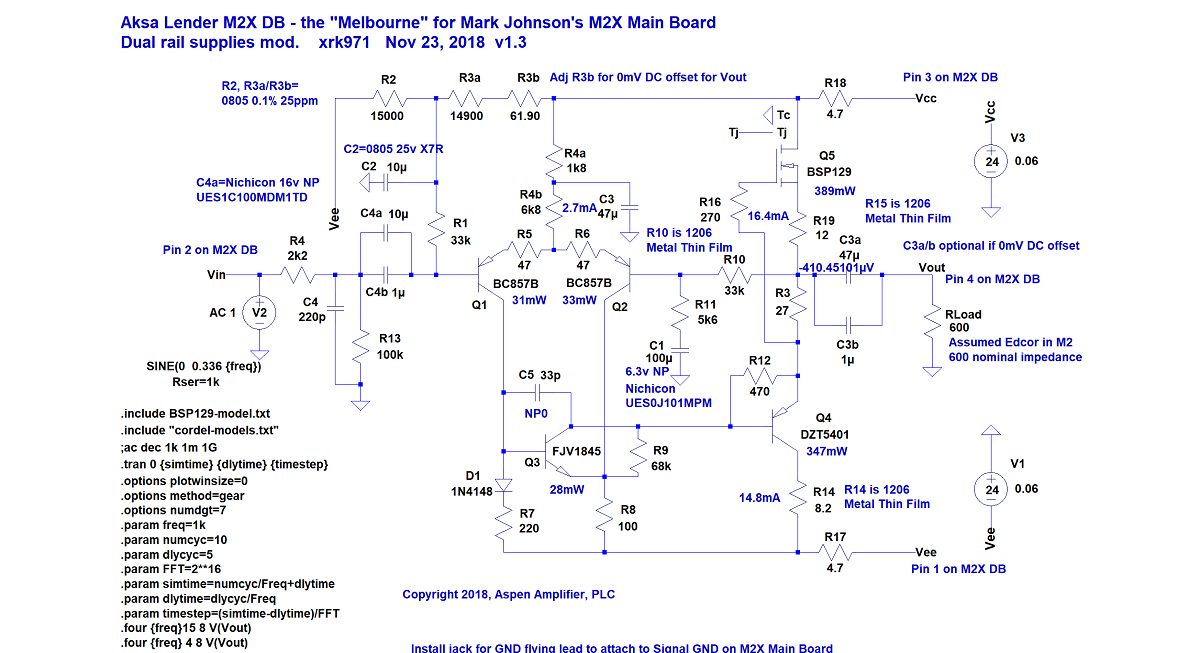

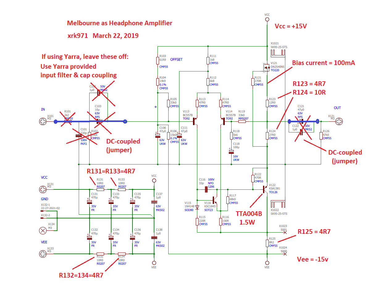

Been looking up parts to build it up as a HPA as per the HPA schematic on the Yarra thread. I just wanted to check a few things ....
1) On the input which parts should be removed for DC coupling (I won't be building with the Yarra board) - should all the crossed out components on the input be omitted? (R101, R102, C 101, C102, C103). Or is it just C102 and C103 which should be omitted?
2) Which resistors need to be carbon/thin film/a specific type? From what I gather R119 - carbon/thin film, R104, R106, R114 & R116 thin film 0.1%, any others? (the schematic which is in blue adds R14 & R15 as thin film.. R14 is R125 in the production schematic but I can't find R15 on the diagram)
Will any need to be higher power resistors or will the usual 1/4W all round be fine?
3) Just saw the melbourne X american beauty...any benefits? If I'm building the melbournes with the revised resistors/mosfet as per the HPA, would the american beauty output stage in the schematic good to go as drawn?(The Melbourne Class A Headphone Amp and Pre-amp)

YOB,
If using Melbourne board standalone, leave all the input stage parts - the input needs a cap coupled input. The drawing is to show that you can do it on the Yarra.
Change the others as shown in the drawing above. You can still use 1/4w axial resistors on everything. Power dissipated is i^2 x R. So 0.1A squared x 10ohms is 100mW. Not too much for 250mW rated part.
Only the feedback resistor needs to be CF.

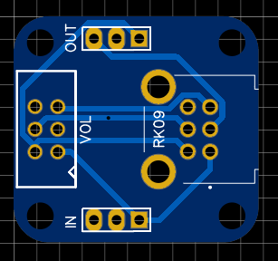

x: I spent an inordinate amount of time on easyeda making small breakout boards for the volume pot, the switchcraft jacks and the DC socket. I ordered a bunch of the jacks way back when for the PCA build. The jack pcbs were $5 for 20 from jlcpcb. can share the gerbers when I get back to the computer if anyone's interested.
A case would be nice but no immediate plans - in the future perhaps.

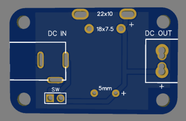

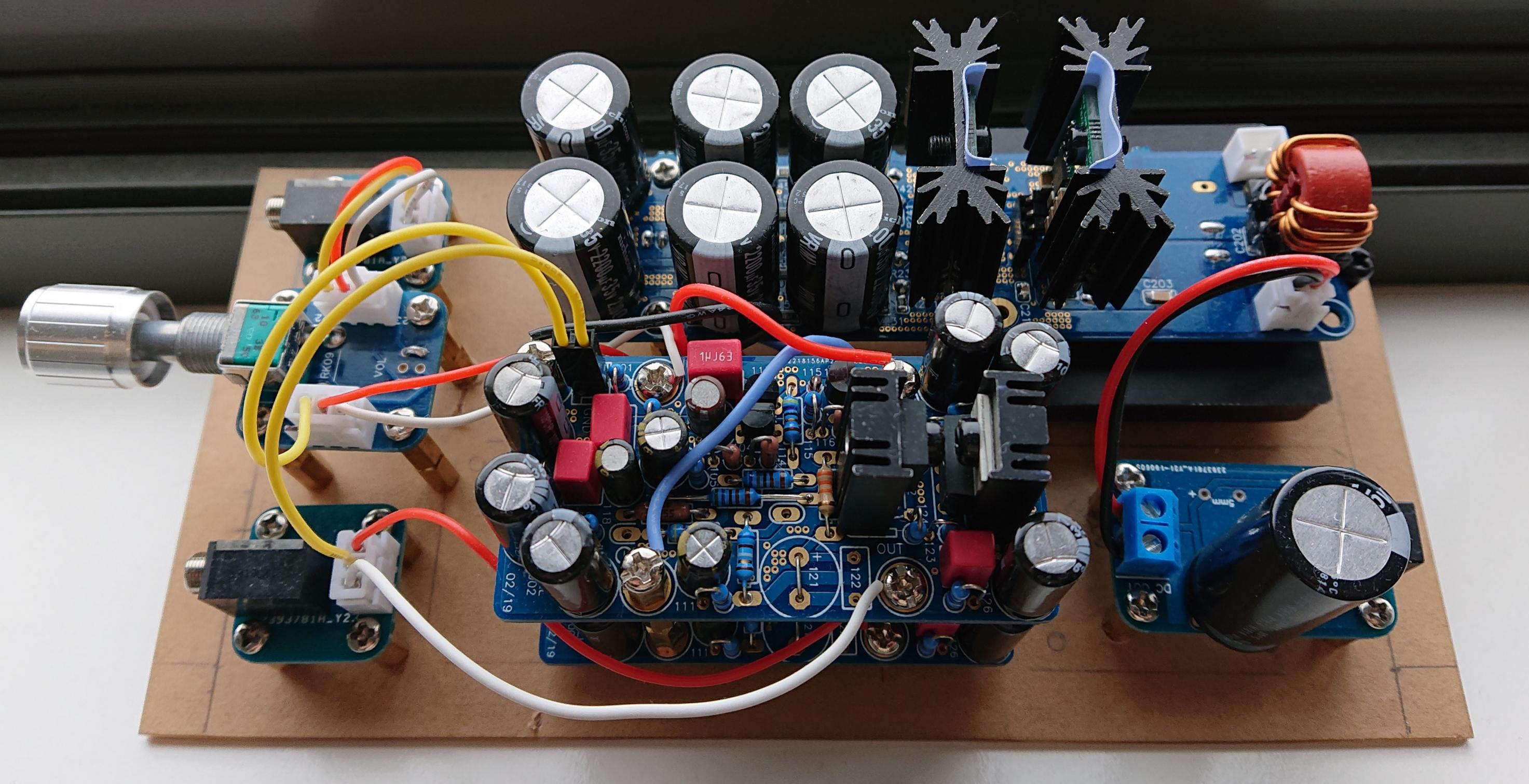

Yep I made another volume board.. figured it will come in handy for other projects as well. Here's the easyEDA pictures of the 3 boards and gerbers for them.
I don't think the DC in board is that interesting, its just 5.5 2.5 jack to a terminal block / 0.1" spaced holes, with space for an electro and film/1206 (on the underside) smoothing caps, and connection point for a switch. One thing I forgot was to add an LED power indicator...not that its necessary for it to function.

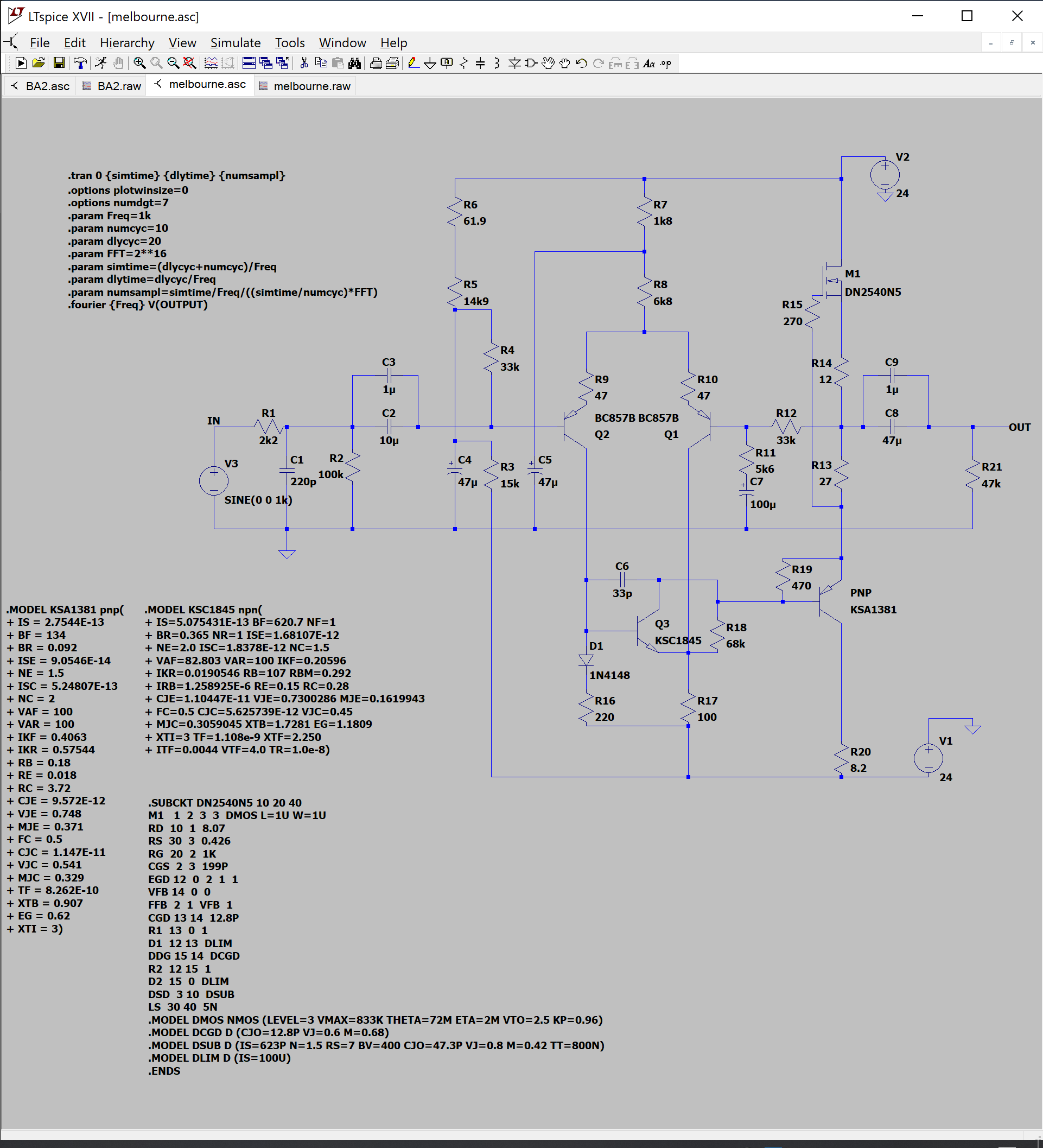

Here is the schematic on LTspice
I'm trying to simulate the circuit in LTspice but it won't even bias. I think I have the component values correct as per the schematic in post #1, and I found the models for the various actives on the internet. Is there something I'm failing to include in the model (attached) besides the base schematic? Or did I miss something obvious?
Additionally, the connection of the 8.2R resistor differs in your LTspice schematic and the later JPS64 schematic (it's labeled R14 and R125, respectively, in the two original schematics) - which is correct?

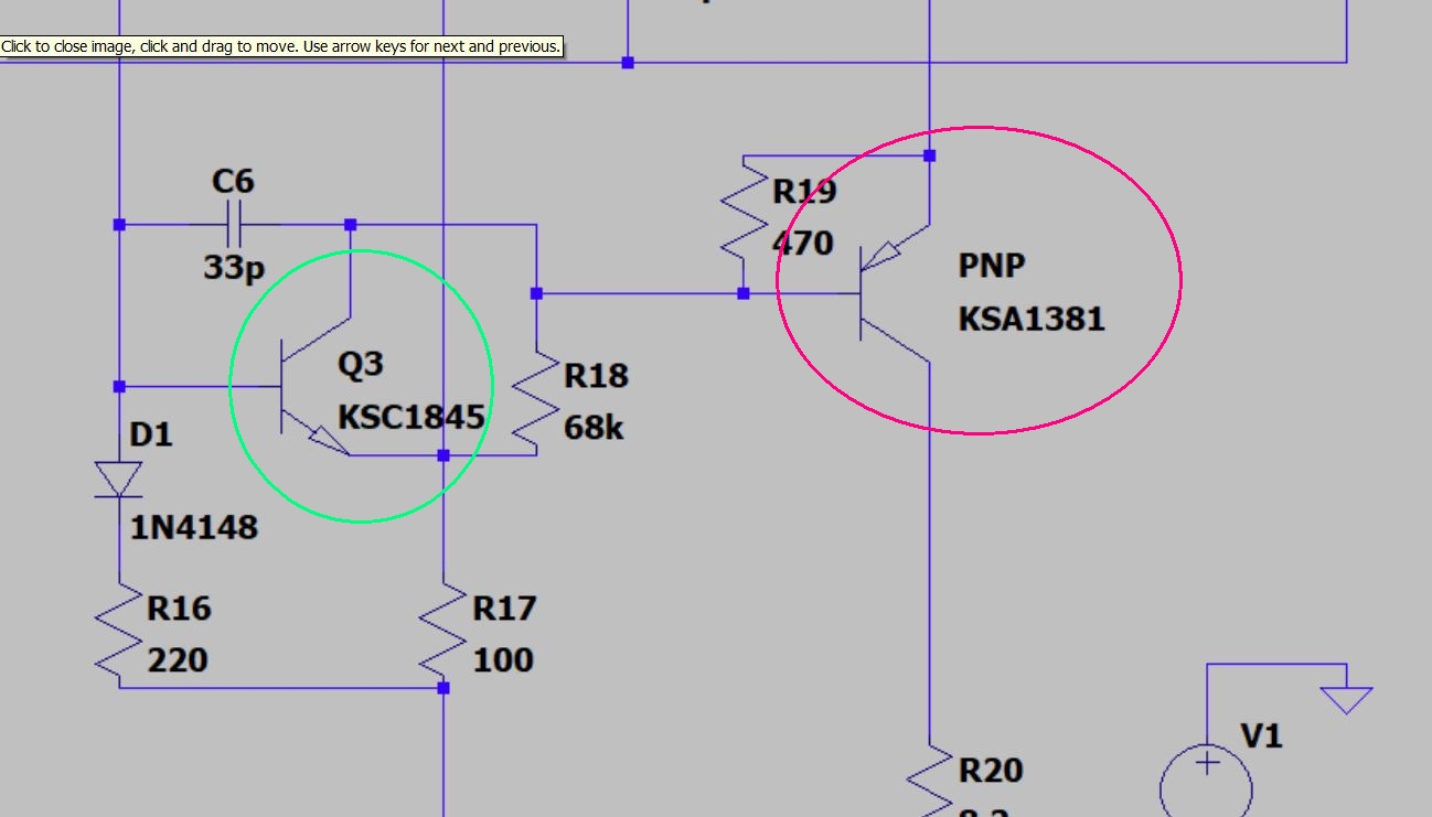

spice error
The error is in the definition of the labelled `PNP' - it should show Q4.
Look at how you've defined the Q3 npn, and alter the pnp to be similar. The rest looks ok.
see attached diagram - error is in red circle.
Paul Bysouth
Thanks! This appears to be an artifact of my own debugging attempts. After making this change, it still didn't work.* However, I found a different "DN2540" model directly from Microchip - and it now appears to be working!
*I did subsequently try Q4 labeled both ways, and it works both ways - I'm not what functional change the labeling makes, but for future debugging, I don't think it caused Q4 to completely fail to function.
  • melbourne.asc
I deleted all of the ".model" and ".subckt" operators and just right click edited the PNP and NMOS to the stock models.
Set an input voltage greater than 0, corrected the FFT command (V(OUT) not (V(OUTPUT)) and it seems to run fine.
