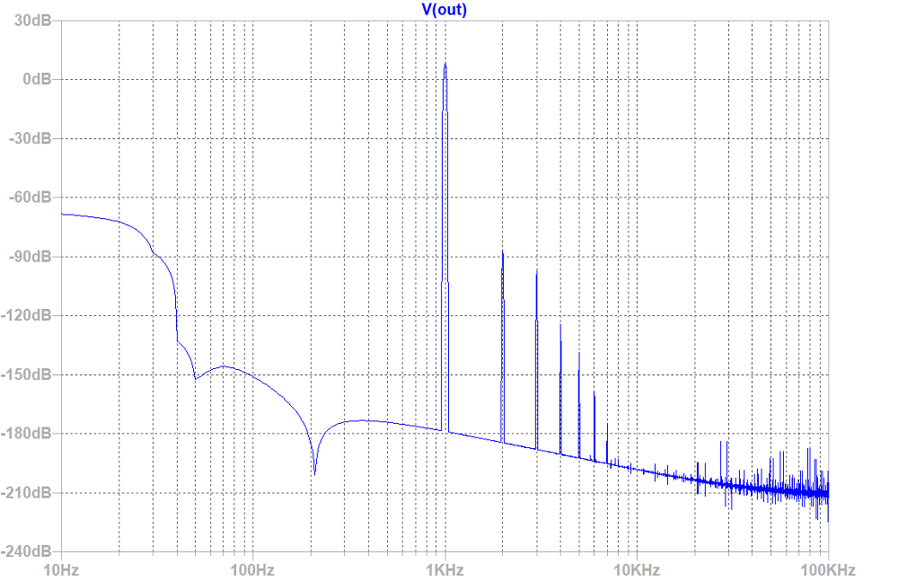

I made a SE Class A CFP Preamp / headphone amp that has adjuster H2.
The DLH amp has adjustable H2 and I made a small HPA/preamp version here:
634772d1505124147-dlh-amplifier-trilogy-plh-jlh-amps-quasi69-build-01-jpg
Here was study of varying H2/H3 for bigger DLH power amp.
DLH Amplifier: The trilogy with PLH and JLH amps

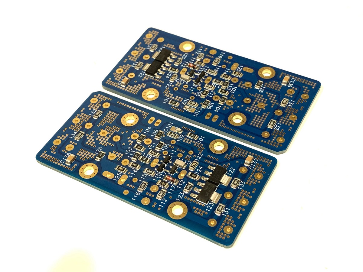

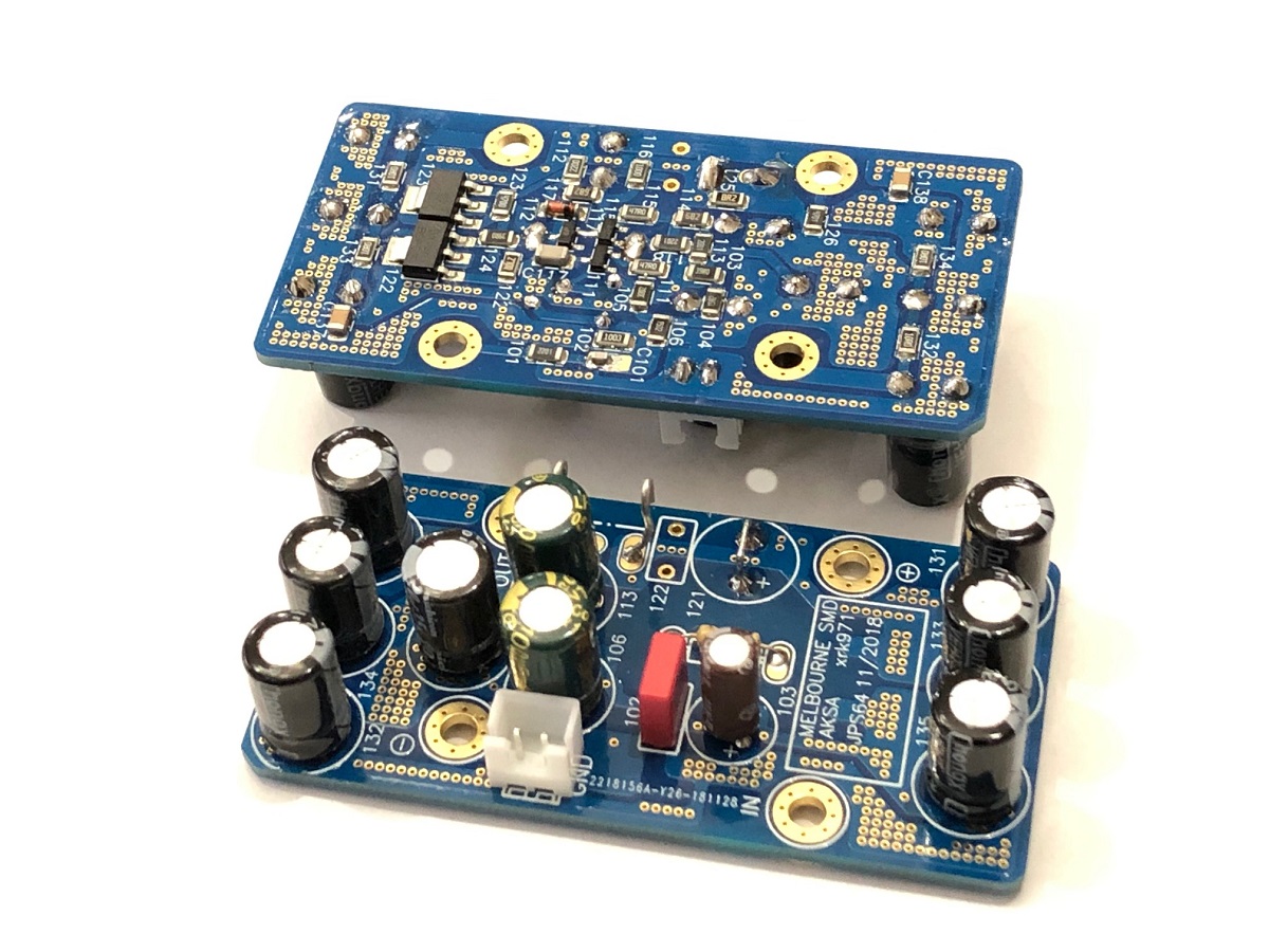

Building up the SMT version of the Melbourne. Using Pb/Sn solder paste from syringe and hot plate at 120C from the bottom and a 300C hot air pencil from the top.
attachment.php
The top side is all through hole and easy soldering. Here, I am choosing to jumper the output cap for the DC-coupled option. Two test probe leads are added to check output bias current.
attachment.php

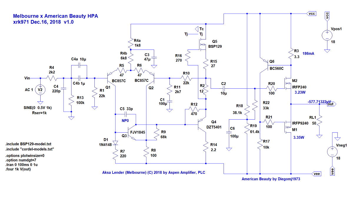

Works like a charm on my MoFo, as you can see in the above photo. You may want a higher gain than default value in schematic if you need more volume. The gain can be adjusted by changing the R118 resistor between the -ve input transistor base and the shunt capacitor.
Gain is (R118+R118)/R118, currently (33k+5.6k)/5.6k=16.8dB. If you make R118 1k5 for example, you can get 27dB which, for most applications will get you to be able to clip the amp with most sources. Don’t change R119 though as that needs to match the input impedance setting resistor.
719786d1543880473-diyaudio-watt-m2x-melbourne-th-v1-schematic-jpg
