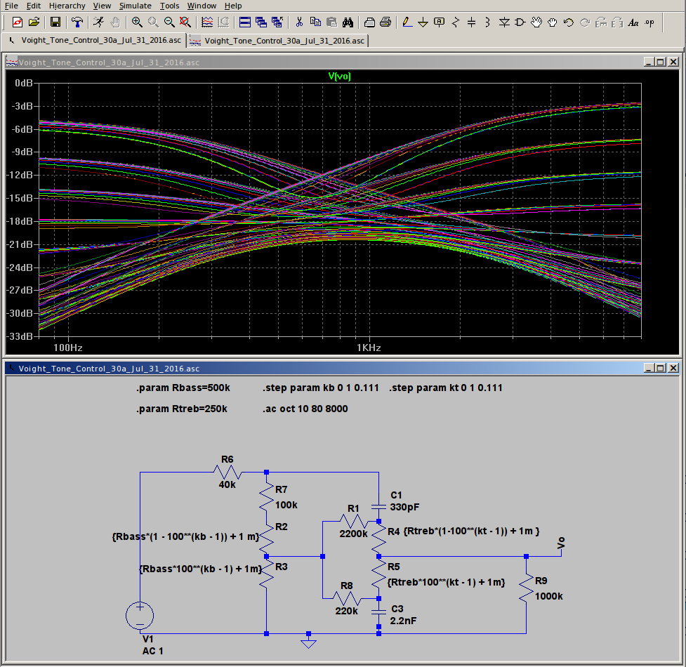

As mentioned before, of the ones I've tried so far, my favourite guitar tone control is a heavily tweaked version of the Voight tone control circuit in Merlin Blencowe's book.
I have been tinkering with the circuit in LTSpice for some time, trying both to improve it, and to visualize the effects of the two separate controls (bass and treble pots).
I think I succeeded pretty well at the first of those goals, but not the second. In a nutshell, I had LTSpice stepping both (virtual) pots through equal angles at the same time, then taking a frequency response measurement. That meant you could not see the effect of one control alone, or the results of turning the two pots in opposite directions at the same time (bass boost and treble cut at the same time, for example.)
After some tinkering today, I found a way to help visualize what each control (bass and treble) does, both individually, and together. LTSpice is now stepping each pot through ten positions individually. Since there are two pots and ten positions each, that means there are one hundred different combinations, so there are one hundred lines on the resulting frequency response graph!
Luckily for us, the shapes and spacings of the lines tell us something about the way the control operates. Take a look at the attached screenshot.
We can see, for instance, that the curves cluster together at the lower edge of the graph. In other words, both tone control knobs become ineffective near their full-cut positions.
But the big picture is a good one - lots of cut and boost are available, there is a pretty flat frequency response available with both pots centered, and interaction between the pots is pretty weak - the bass curves are not yanked all over the map when the treble pot is turned, for example. (We see rather tightly grouped clusters of curves.)
As before, R6 represents the 40k source impedance of the valve feeding the tone control; this is typical for a 100k/half-a-12AX7 common-cathode gain stage. R9 is the 1M grid bias resistance of the next stage, loading the output of the tone control. A 1M pot could be used here, too, as a master volume.
This circuit is the best I can do (so far) with a purely passive approach. IMO it's better than the TMB, passive James, passive Baxandall, and the two-knob Bandmaster tone control.
I should add that this version is tweaked for an overdriven guitar sound. Center frequency is up around 700 Hz, in the expectation that there will be lots of treble harmonics present (due to overdrive). For a clean channel, it would probably be better to drop the center frequency to the 400 Hz range.
-Gnobuddy

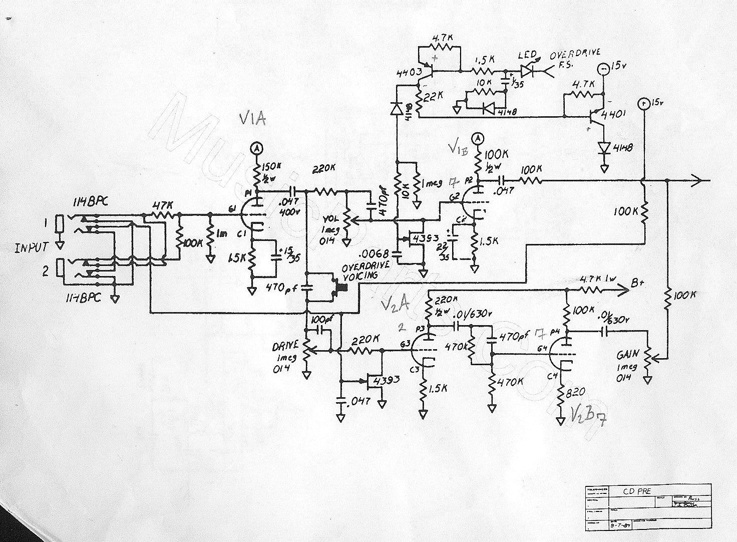

Yesterday, reminded of the Dean Markley CD series of guitar amps by an earlier post on this thread, I hunted online for schematics of those amps. It turns out the engineer behind the CD120/CD60/CD40/CD30 series of amps had exactly the same idea I had - and he came up with it at least thirty years before I did.
I think these Dean Markley amp schematics are well worth a look for anyone into DIY guitar amp building. The approach is quite different from, say, the classic Fender and Marshall designs. To me, it also shows a more engineering knowledge and sophistication - perhaps not surprising, since these were designed in the mid 1980s, a good twenty or thirty years later than the early Fenders and Marshalls.
Anyway, for anyone interested, here's the relevant bit of the schematic.
Note the mix resistors at the output of each channel; the mixed signal runs into the shared tone controls for both channels. It looks as though you can mix together the clean and overdriven signal in any ratio of your choice. It also looks as though you can use the channel footswitch to mute the clean channel - but not the drive channel!
Also note the JFET wired to mute the drive channel unless there's a guitar plugged into the amp. I guess the designer didn't want audible hiss from the amp, if you powered it on, but didn't plug in a guitar.
-Gnobuddy

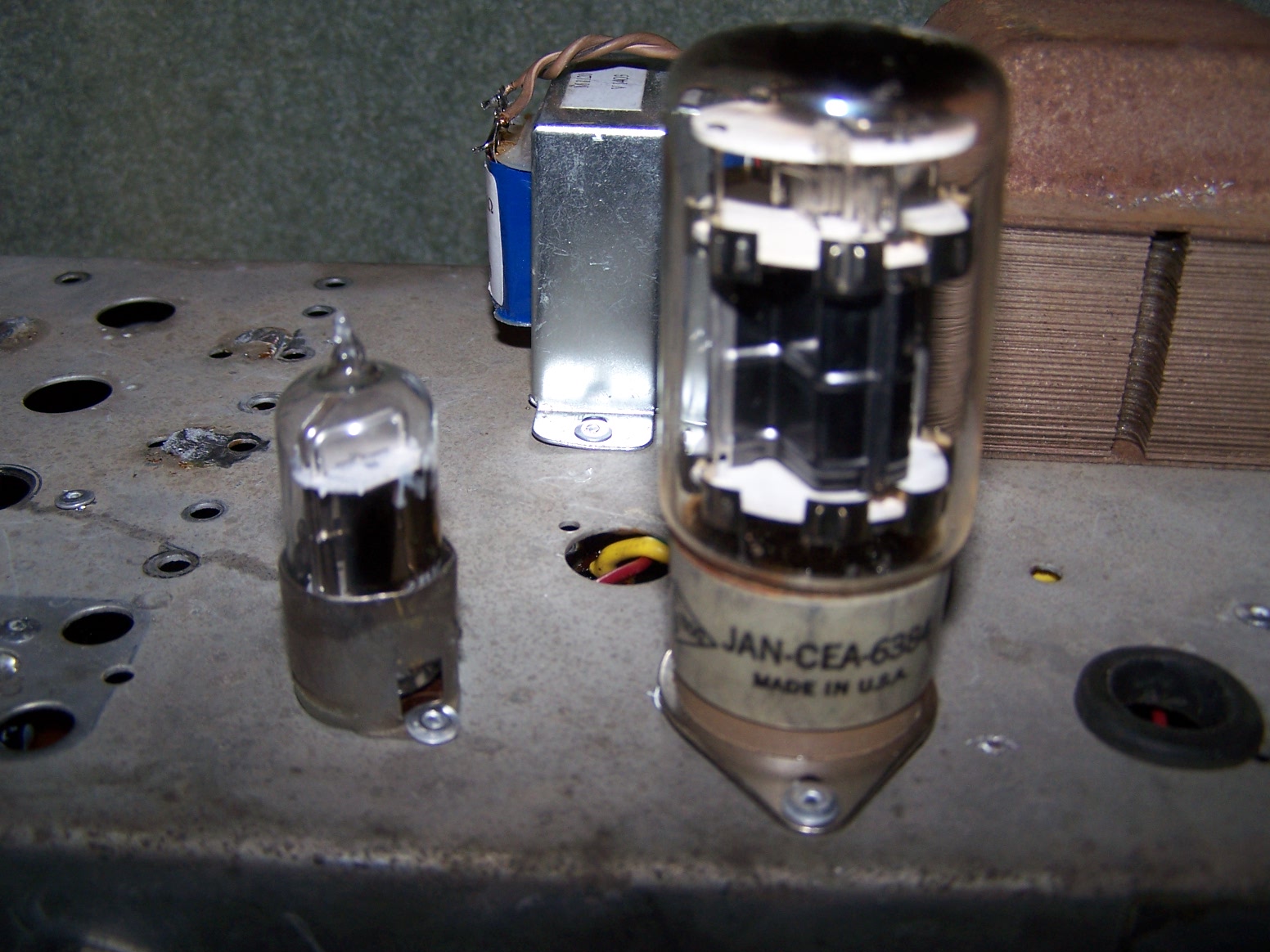

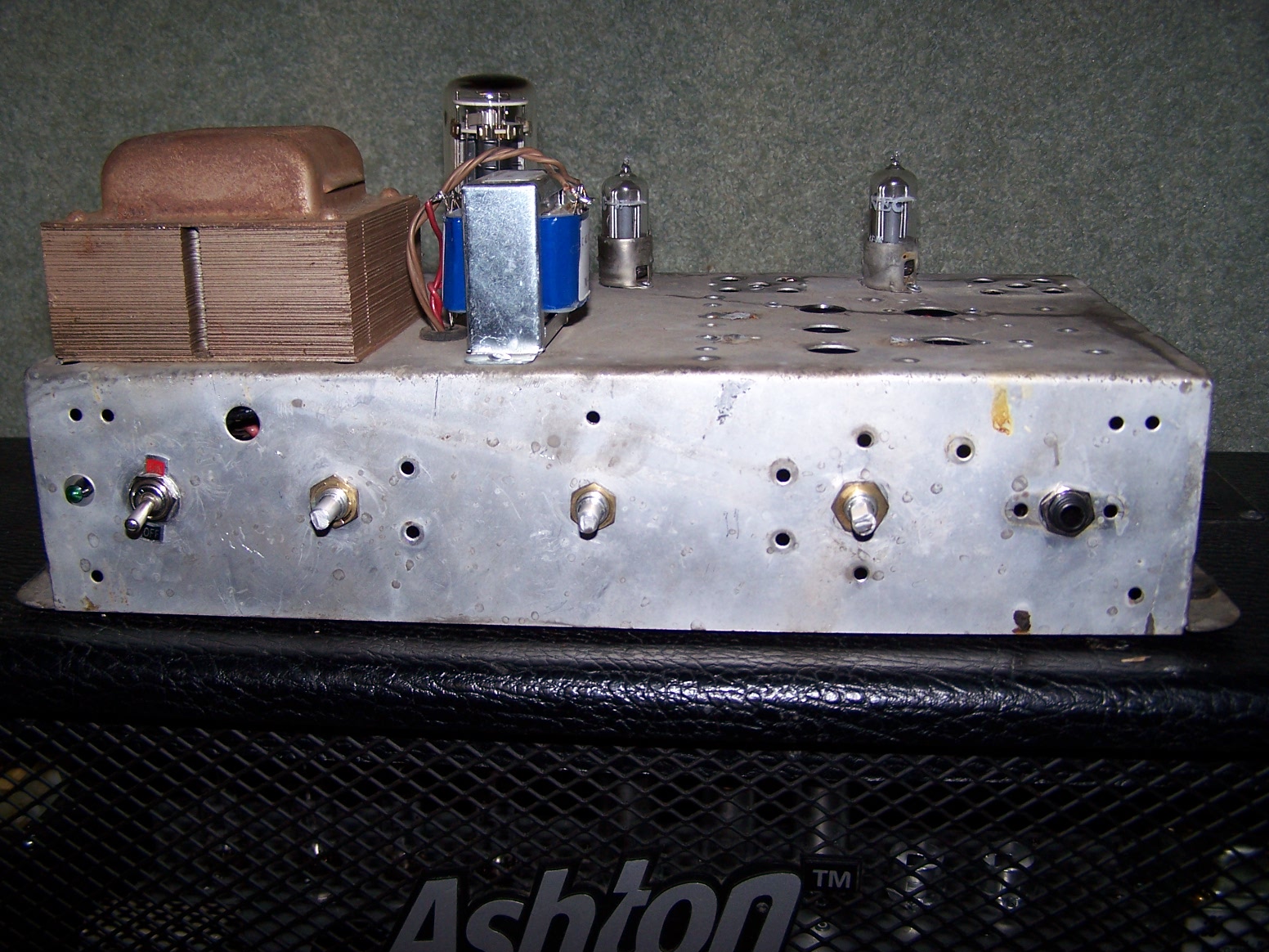

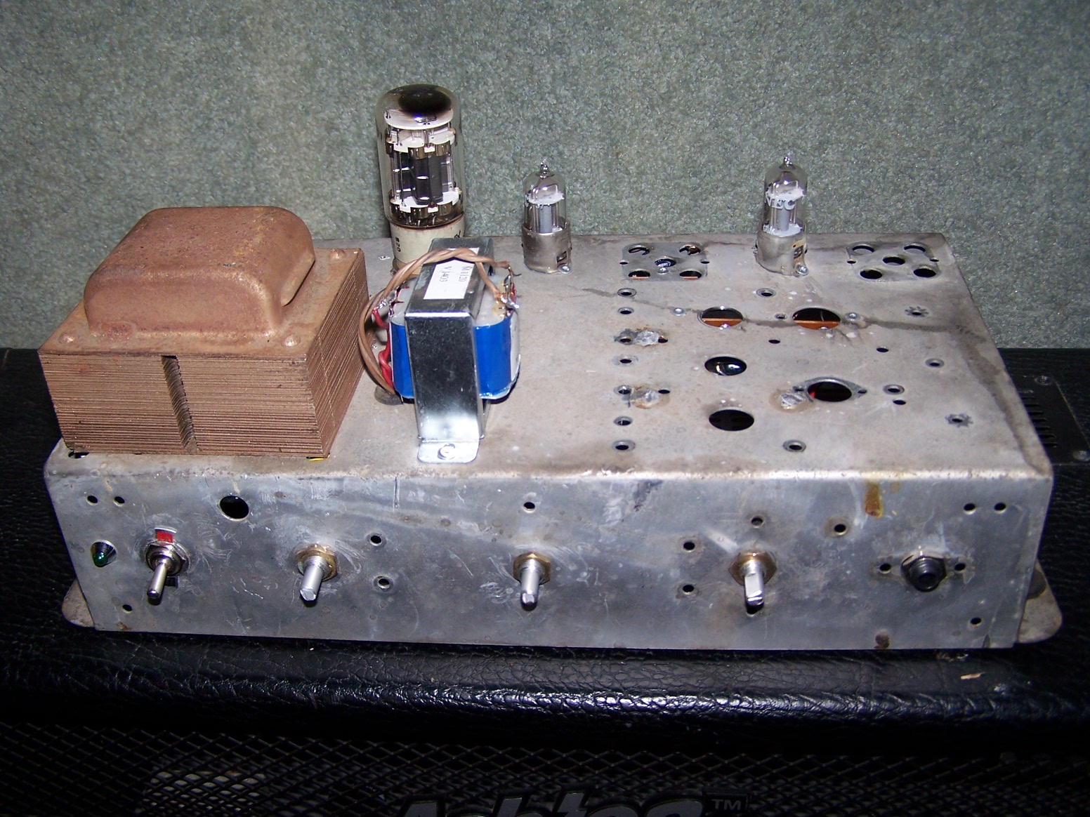

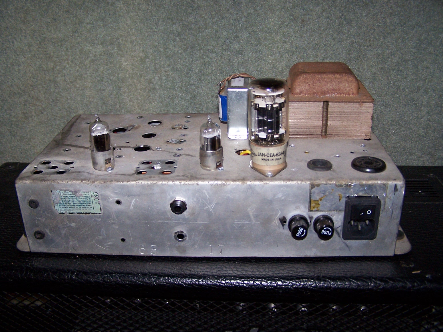

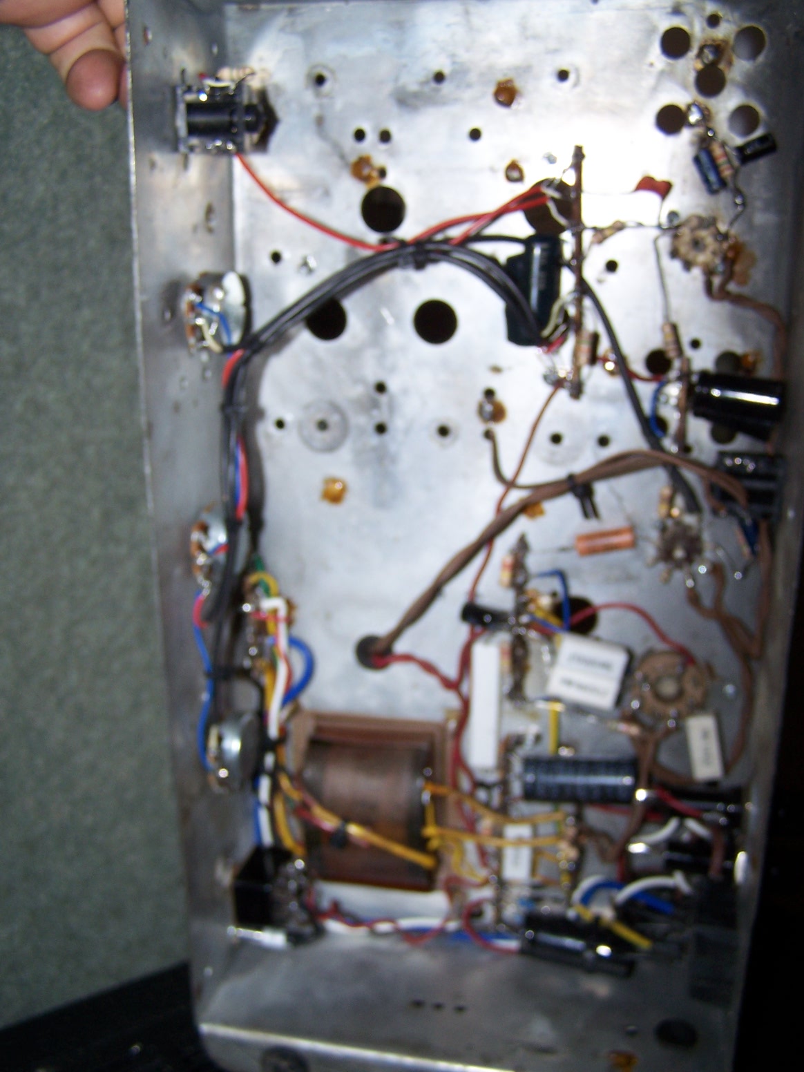

Hi,its a bit late I know.....this thread has run its course....but I just wanna put it out there....I came across a schematic of a champ reverb modded to suit a el34...SE of course so I looked around in my shed and I found a chassis with a tranny and some 7 pin bases in it and 1 octal rectifier socket......
I didn't like the position of where the socket sat so I put another one in and thought to use the old socket to hold a spare tube
as I recall I paid 30 bucks for 2 old radiograms so I guess the chassis has cost me $15

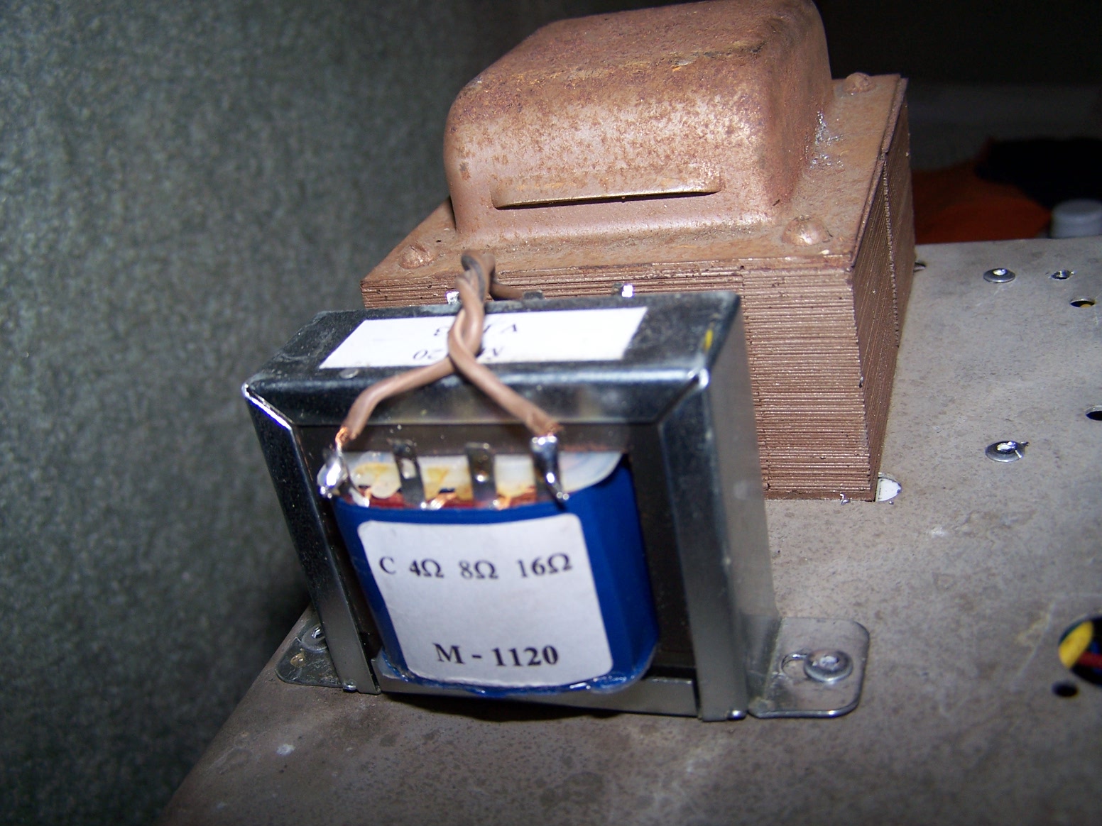

for the preamps I used 2 6av6 ( $6 from ebay) 7 pin tubes and the output tranny was a m1120 line transformer $ 19 bucks from altronics.....8k into 4,8,16 ohms
the power tube is a 6ar6 / Bendix 6384....the Bendix I've had sitting around for ages but the 6ar6 are plentiful and cheap and importantly.... quality....some are less than $15 on ebay
I walk out of jaycar with some bits and pieces ....$28
So all up its cost me $83 bucks and here is the thing......you can almost gig with this thing,....its that good!!!
I've heard mention of using the M1120 transformer in push pull situation but to me its basically a SE unit to start with so that's how I used it and in my opinion makes a better SE tranny than a push pull tranny efficiency wise
the power tube had 395v on it and I omitted the reverb section.
for anyone trying to make a quality , cheap amp it would be hard to beat this one.....those 6av6 / 6at6 / 6c4 tubes are awesome and plentifull
just check out the scheme and sub where the 12ax7 is with 6av6 and where the el34 is, stick a 6ar6 (kissing cousin to 6l6)
And did I mention , diodes n4007 , 100uf , 47uf and 20uf caps (all used ) and 340 ohms on the cathode (6ar6) and Quiet as a mouse
enjoy:D

Bendix 6384
Some guy on Ebay ran the prices of these up at least a dozen years ago telling everybody to put these into their guitar amp since they were "better than a 6L6GC " and would "never blow up." He was basically right about that, but neglected to tell people that they have a different pinout!
They are awesome tubes, but not exactly the same as a 6L6GC. I have some Tune Sol 6AR6's, which are quite similar to their 5881's. The 6384 is a militarized version of the 6AR6. A pair of 6384's will work in a 50 watt amp forever.
a surprisingly good-looking Brimar valve I'd never heard of before.
The tube is a Bendix, US made in New Jersey. Bendix made everything from car parts to avionics, and radar systems. There was a Bendix plant in Ft. Lauderdale near me that made avionics.....don't know if it's still operational.
The Bendix Red Bank plant made military spec vacuum tubes with mil spec prices. The 6384 data sheet is attached. Note the 30 watt dissipation, 750 plate volt, and 450 H to K specs. Like I said, hard to blow these guys up!

Hi guys,this build is not really about the Bendix tube but about the 6ar6 tube.......I used the Bendix because I don't have a 6ar6 but 6384 and 6ar6 are same in spec but obvious the Bendix is made for ballistic missiles so its tough and you don't want a warhead dropping in the wrong place do you.....the 6ar6 is close to a 6l6 but not identical, but so close they make adaptors so you can simply swap and go for it
there is a guy selling 2 for 30 bucks aussie , brand new on ebay right now!!
Just thought I'd share a quality alternative , that gives a whole lot of loving back to you.......on a quick note the 6384 tube is a 10000 hour tube......do the maths....it would take me 10 years at least to wear this one out in class A :rolleyes::eguitar:
Just adding that this challenge , a 100 buck amp is about making a amp out of new current product materials.....that would mean Chinese / Russian tubes , cheap alternative components etc ..... you can do it , but would you use it ?
I think recycling is the go, there is so much quality vintage gear out there it's not funny !!! and for coffee money !
Should be more about quality alternatives ! that are affordable for the tinkerer....something that makes you not want to turn it of , not wanna put that guitar down !.....anon

My amp was patterned Fender low wattage P-P amps but rather than using expensive transformers I went for a 120:120V isolation transformer for the HV and a 70V line transformer for the OT. Picked the rest of the parts from two suppliers rather than getting deals all over and not taking into account shipping. A 12AX7, 12AT6 and a couple of 12AQ5's. Rebuilding the amp right now, dropping the 12AT6 and using a MOSFET for the phase inverter and a couple of Fets thrown in. Hope it turns out to be a good combination but the majority of the pieces are from the Challenge design. Would I use it? Darn rights.
make it well !
EXACTLY !!! ........ make something on a budget , that you really do wanna play....
The m1120 in my opinion worked so much better as a SE big bottle transformer than a push pull tranny....and I've used it as both....handy to have all the taps as well...one can run almost anything with it
originally I used the M1126 ....from memory around 2500 ohm to 4 & 8 ohm at 30 watts...but the sound seemed restricted for the 6ar6 but it might work better for an el34
I did have 2 old chassis in the shed so i'm gonna turn the other one into a big bottle something....I'll post it as well......cheers ;)
