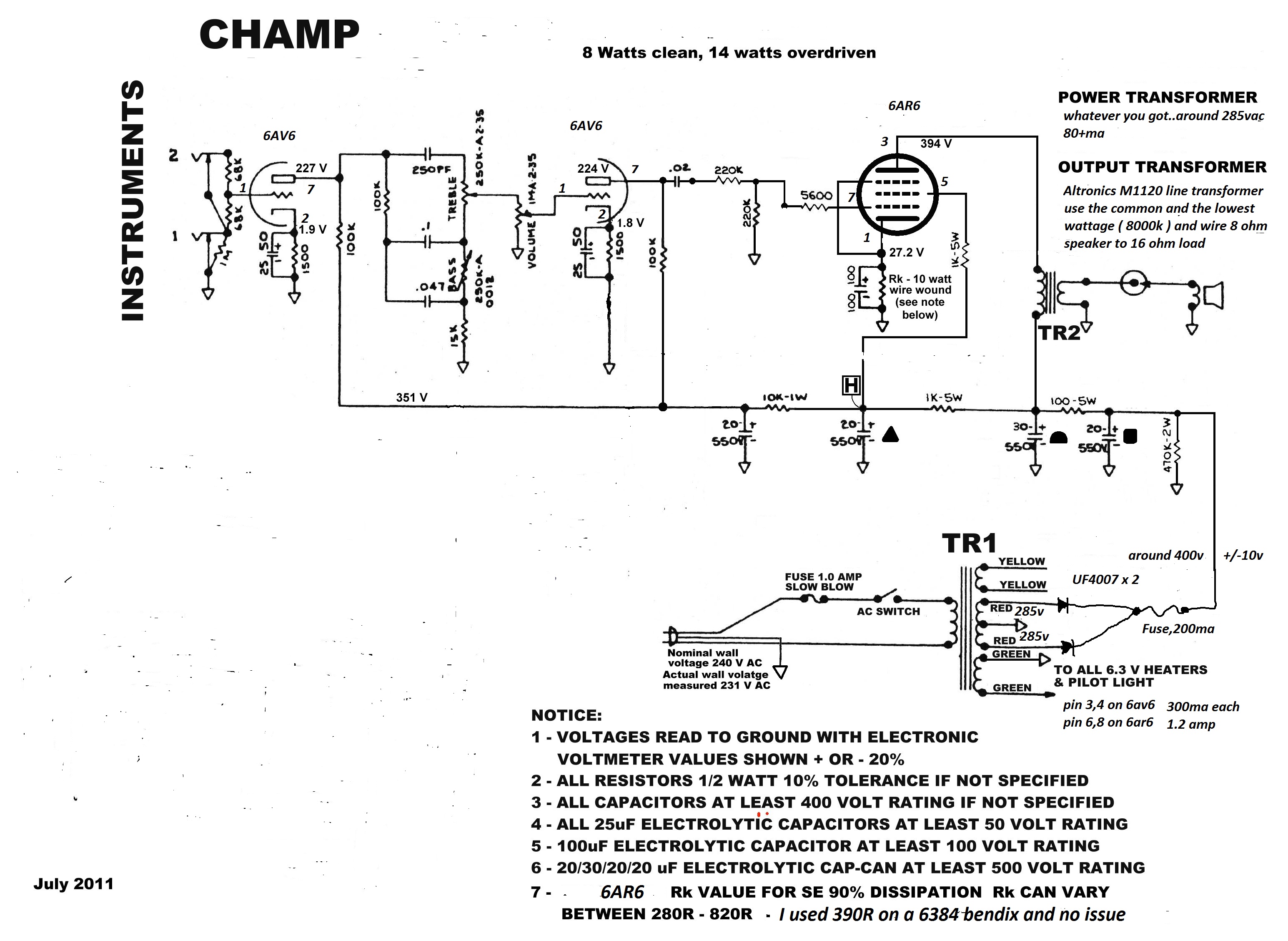

not a comp ...but
There is always a few ways of getting the job done....the way I look at it is that there are so many popular schematics available for all the favorite amp builds...marshal , fender , vox and the list goes on.....
NOS tubes for these amps are getting expensive which means that ultimately you are gonna go Russian / Chinese for tubes (which can only improve over time) or pay the big $$$......thing is , there are alternatives which will fit right in with these schematics
Example , a 12ax7 is just 2 triodes in a bottle and a 6av6 is a single triode in a bottle (with 2 diodes , just connect them to cathode)...both have gain factors of 100.....to get a mullard 12ax7 your gonna pay lots $$$ .... but to get a NOS 6av6 you can do it for coffee money and the lesser 6at6 is the same only gain is 70 (similar to 12at7).....so you just wire them in with no change to the schematic ,put them in side by side...and easy to wire
Same with the 6ar6 close enough to a 6l6 all you do is wire the pins differently and presto.....1 beautiful sounding amp with quality all the way ...but with tubes at bargain prices
That is what I'm about.....simple alternatives that work well

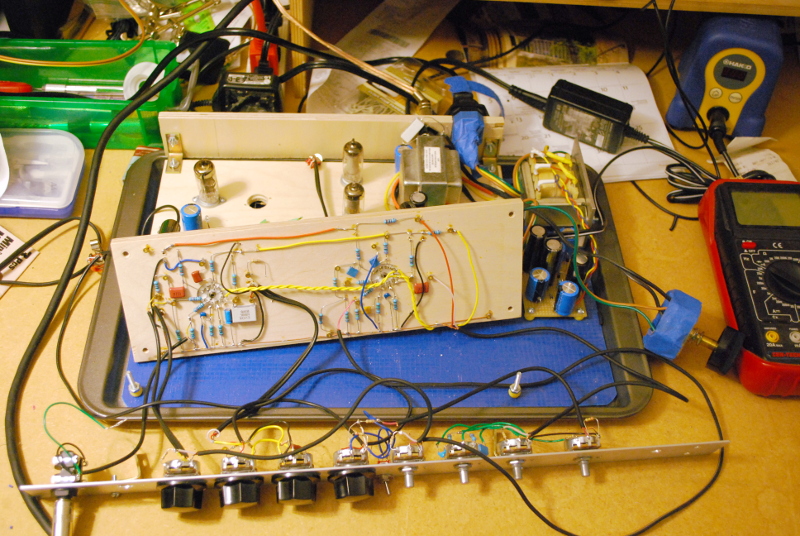

Just sharing a picture of my amp, in its current state. Eight pots on the (temporary) front panel, plus an Lpad off to the right side...it's definitely not a Champ!
This is a 2-channel amp, four knobs for each channel. Gain, bass, treble, master volume for cleans, then the same four controls for the drive channel. Pretty simple and logical.
There are two circuit boards (literally, they are plywood.) The one in the foreground carries two 6JW8 triode-pentode valves, which together make up the two channels of the preamp.
Since I wired up the drive channel, there is lots of hum (at all volume and gain settings). I probably accidentally introduced a ground loop, which is rather easy to do with shielded cable. I need to find and fix it.

Fixed it. No ground loop, I just forgot to ground the metal strip acting as my front panel!...Since I wired up the drive channel, there is lots of hum (at all volume and gain settings). I probably accidentally introduced a ground loop...
There's still a light buzz, which may be radiated noise from the HT power supply. I may have to put it in a metal box.

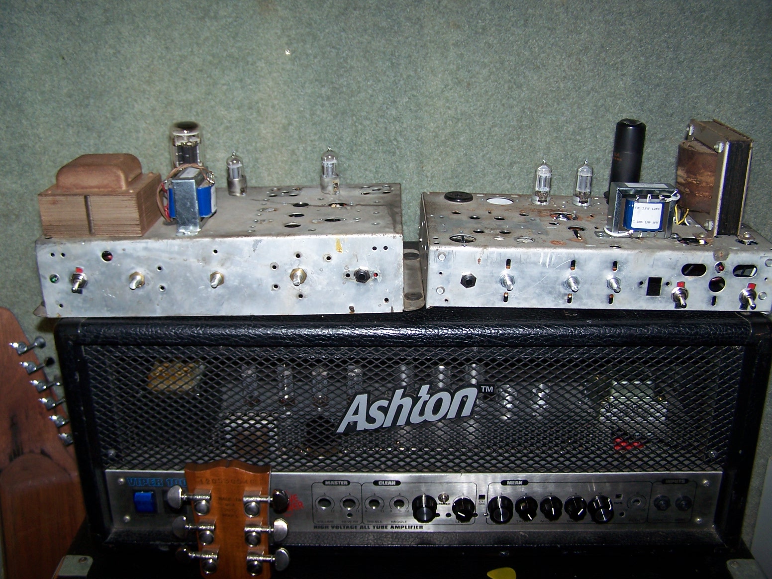

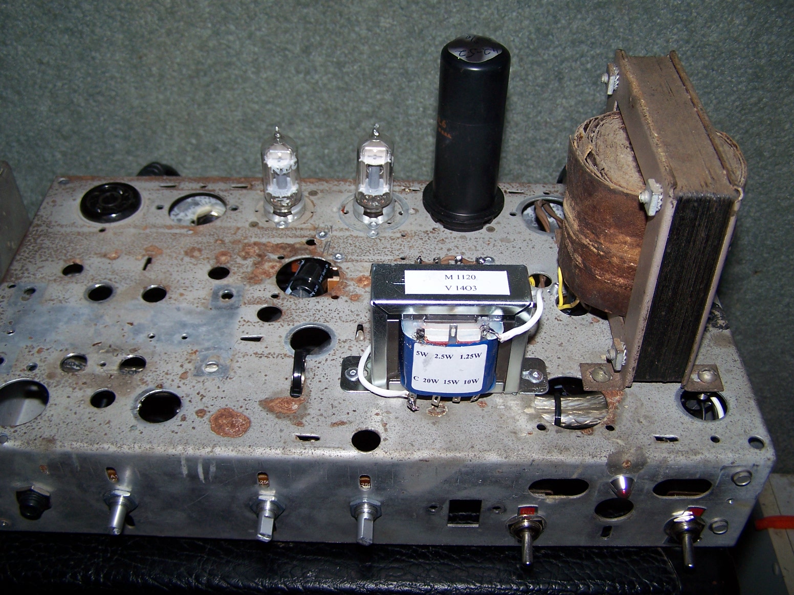

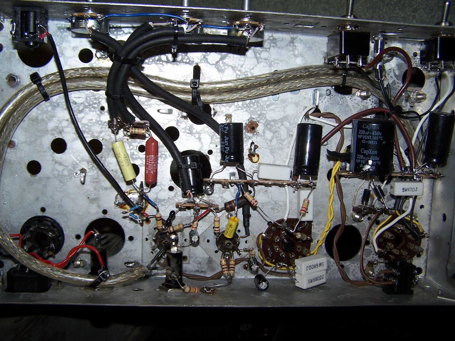

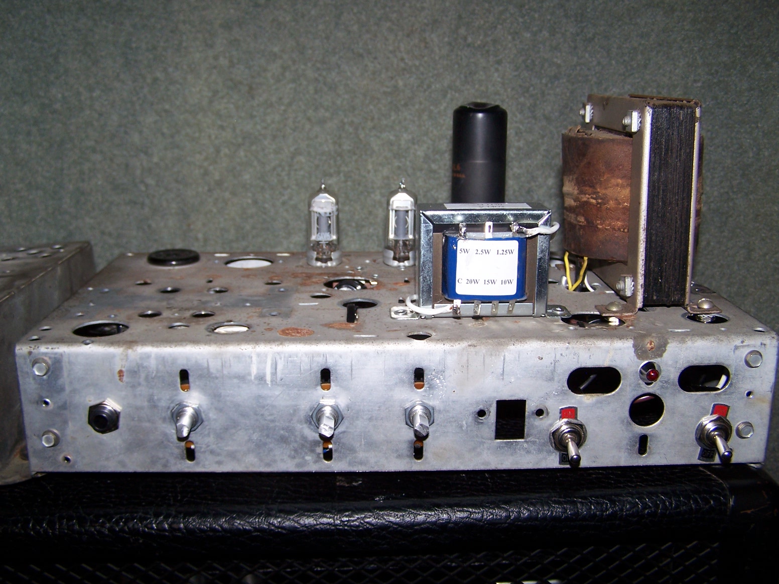

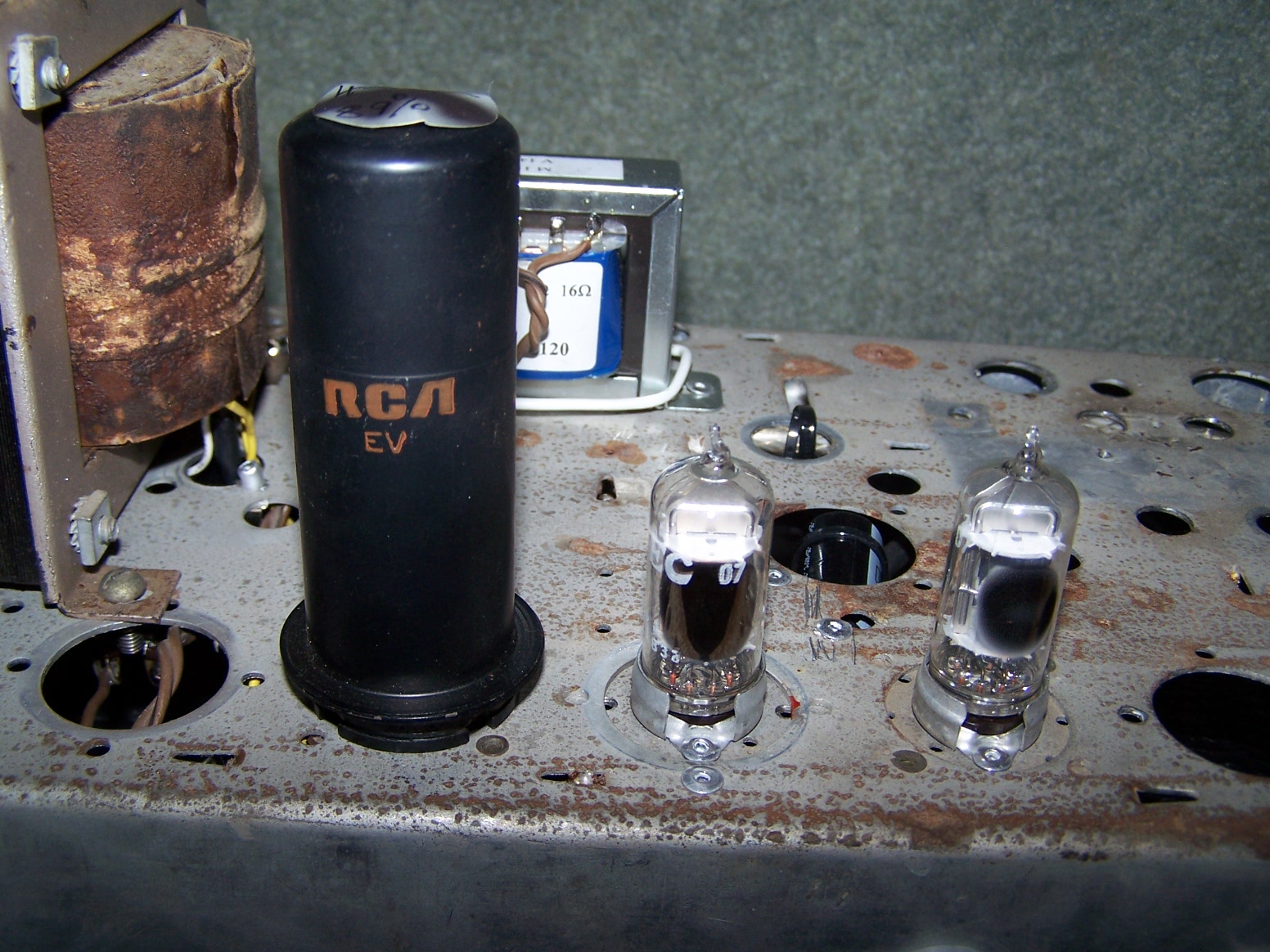

hi,fellow tube addicts !
I got this second one built.....used a metal 6l6,bought 2 for 12 bucks as is and they were still in the box so I assumed they were new.....but for $12 gonna risk it !
Ive run these before...actually still am in a bluesbreaker copy with lowered plate volts and they actually sound very very good despite what others say...only hangup is you cant look inside to see if they are going ballistic...and its possible volts can touch the sides....but mine are enclosed...also pin 1 is connected to the can.....but a $6 NOS RCA 6l6 !
2nd build didn't have as many volts as 6ar6 one...400v as opposed to 340v
but no noticeable drop in volume.
I think the M1120 transformer is a little shy of bass in both units but more can be done to bring it forward......ran them both in stereo effect mode and they were quite loud....possibly loud enough to gig with but not the cleans though...... although rolling the volume off the guitar puts it in nice middle ground but with a dedicated transformer I think a little more noise and a little more bass would make it through
I thought about adding reverb and vibrato but I control most things at my feet these days so slaves are really all I need.....no tricks !
This amp cost me about the same as the other one and sounds as good as the other one.....one thing I did notice was the different tones that came from the assortment of 6av6's I have here...in Australia they are in everything mono radio or gramophone

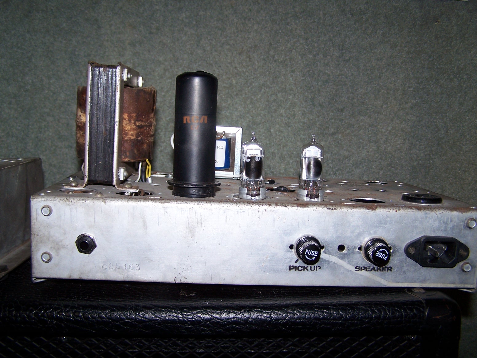

one last word on 6aq5 (7 pins).....they are actually 6v6 in a little bottle limited to 250v so the sides don't melt and the 6bw6 (9 pins)is rated to 315v I think and exclusively made by brimar....both 6v6 derived...
regards rifraf50
