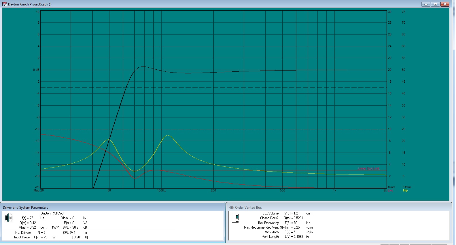

Several years ago I stuffed two cheap Dayton Audio 6 inch "Pro Audio" speakers (PA165-8, 93db, $18) into a ported 1.4 cubic foot box made with thin (1/2 inch) plywood, tuned to 70 Hz. Later I added a cheap Pyramid tweeter crossed with just a cap and an on - off switch. The idea was to make a pair of cheap, lightweight boxes that I could toss around, and abuse with lotsawatts without worrying too much if I blew a speaker. The total cost of all the drivers is like $42 per cabinet.
I have fed both cabinets electric guitar with a tube amp that makes 125 watts clean and over 150 at clip played outdoors, cranked for several hours, and ue these speakers for testing unknown amps. No blown drivers yet.....I fed them with a 100 watt Park 1207 (Marshall super lead 100W) too.
I have also used the same cabinets from a $25 Lepai class D Hifi amp running from a car battery playing a Roland synth (inverter fed from the same battery) for a parking lot (maybe 100 spaces) flea market gig, and the volume was adequate. Several people were surprised at the sound quality from my $100 PA system. The piano sounds from the old Roland JV-1000 were spooky real from those speakers. That's why I put in the tweeter.

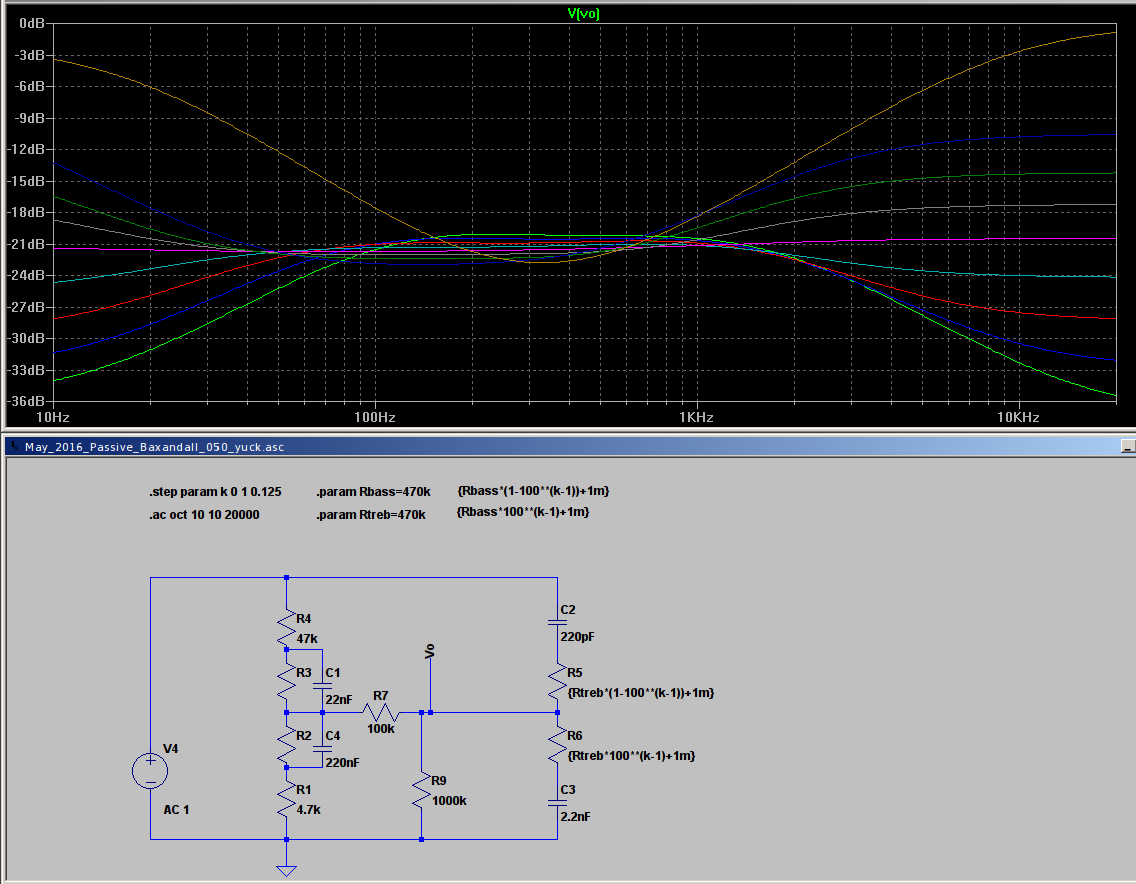

Just got done with necessary chores, so here's a screenshot of one of my attempts at using LTSpice to simulate a passive James circuit. I'll upload the LTSpice .asc simulation file as well, if the forum software will let me.
Some time ago I found online instructions on simulating a linear pot using LTSpice (two resistors, two algebraic equations, and .param and .step Spice directives.)
From that starting point, after some head-scratching, I worked out the algebraic equations for a logarithmic pot.
If, say, Rpot is the end-to-end value of the pot, R1 the resistance from wiper to ground, and R2 the resistance from wiper to the "hot" end of the pot, these equations simulate the pot:
R1 = Rpot*100^(k-1)
R2 = Rpot*[1-100^(k-1)]
"k" is the parameter that "turns" the pot; when k=0, the pot is at at one end, when k=0.5, the pot is turned through half it's travel, and when k=1, the pot is at the other end.
I believe these equations are correct, as they pass all the logical sanity checks:
  1. R1+R2 is always equal to Rpot for any value of k.
  2. If you set k to 0, then R1 = 0.01*Rpot, and R2 = 0.99*Rpot.
  3. If you set k to 0.5, then R1 = 0.1*Rpot, and R2 = 0.9*Rpot. This is the usual modern log pot behaviour, with 10% of total resistance when rotated to 50%. (I've read that there were slower-taper log pots available in the past, for example, 30% resistance at 50% rotation.)
  4. If you set k to 1.0., then R1 = Rpot, and R2 = 0.
Once I'd figured out these equations, it was straightforward to simulate a log pot in LTSpice (the screenshot shows the details).
In the screenshot, the directive ".step param k 0 1 0.125" turns the pot from one end (k=0) to the other (k=1), in steps of 0.125, which is one-eighth of the total rotation.
That means, if the tone control was linear and precise, you would see nine equally spaced and symmetrically spaced curves on the graph. (k=0 plus the 8 other step values of k.)
But that isn't what I see at all. Instead, there seem to be a host of problems:
  • Bass boost is very nonlinear with (log) pot rotation, and pretty wimpy except at full boost.
  • Treble boost is also non-uniform in a similar way.
  • Bass cut is pretty feeble.
  • So is treble cut.
  • The frequency response isn't particularly flat at any point, and there is some control interaction.
  • The frequency at which treble cut begins is very different from the frequency at which treble boost begins.
Unless I'm making some sort of stupid mistake in my simulation, this looks like a depressingly poor tone control circuit to me. :confused:
(Though not as awful as the usual Fender/ Marshall/ Vox 3-knob atrocity!)

Coincidentally, a 70 Hz lower corner frequency is about what I had decided to go with for a vocals-only small P.A. system. Also coincidentally, I do have a $25 Lepai class-D amp hooked up to my wife's computer! (Probably the same one you have.)
The little Lepai only puts out about 5 watts RMS per channel into an 8 ohm speaker before clipping, despite Parts Express' very optimistic max power specifications. So I never considered it for P.A. duty. But if it worked for you, I better try it out!

I have two 8 ohm 6 inch speakers per cabinet plus one 8 ohm tweeter crossed over with a cap (don't remember the size, maybe 4uF). That presents a roughly 4 ohm load to the Lepai, for maybe 10 WPC, probably a bit less running from a 12 volt boat (trolling motor) battery. It's plenty loud in a quiet park setting, and was running at about 1/3 volume control setting with the Roland plugged directly into the Lepai. The other players except for the guitar, were using acoustic instruments, violin, mandolin, and banjo. The guitar player had a Roland Cube which ran from AA batteries and maybe made 5 watts cranked.
how did the Dayton Audio speakers sound to your ears
They are not guitar speakers, and do not exhibit the usual midrange honk and cone breakup of a guitar speaker. They are rather clean sounding until really cranked, which was the idea. The simulation promised rather flat response down to 75 Hz, and they sound rather flat, but I never tried to measure them.
There is some obvious port noise and cabinet rattle when played loud on the 6th string. I never realized just how much of the sound (and air) comes through the port even with 6 inch speakers. A thicker box with a better port would be a good idea if you plan to get loud a lot. It's audible with a 20 watt (2 X 6CW5) amp cranked. At about 1/3 throttle the same amp sounds real clean with better sounding clean bass than expected. The amp will clip at about 6 watts into these speakers at 80 Hz because the speakers are about 25 ohms and the amp runs out of voltage (320 volts, 3300 ohm OPT).
I built then for "test" speakers so that I could hear the true sound of the amp, both for MI and HiFi applications, and so that I could play with big power cheaply. I also wanted light weight for outdoor use when needed. I can carry everything I need for outdoors in one trip easily except for the battery. The big battery I have will play all day at full tilt with out going below 12 volts, but it weighs 65 pounds. You can now get LiFePo4 (not LIPO) "lead acid replacements" on Ebay reasonably cheap which would be the power of choice today.

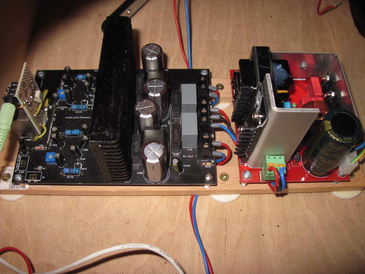

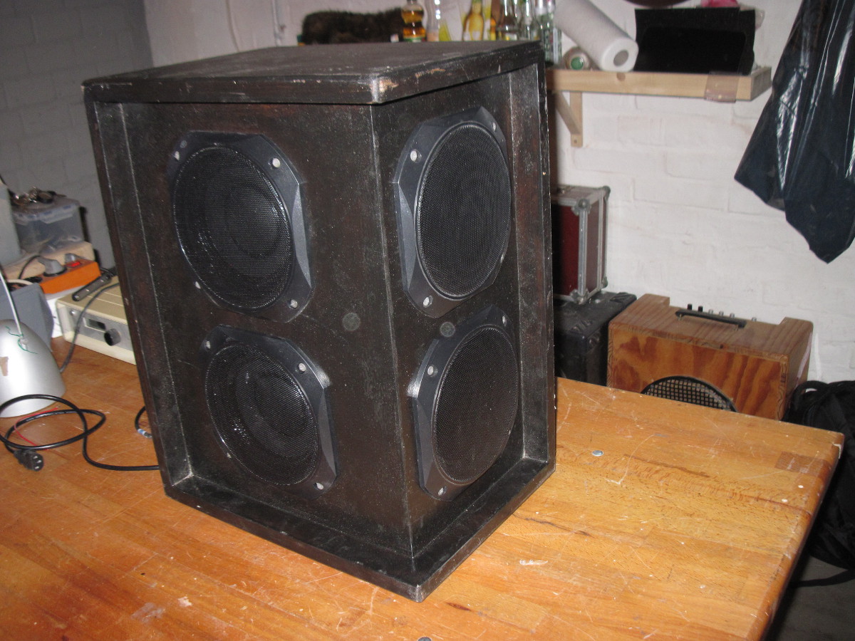

Here are some pictures. As can be seen these cabinets are "bi-directional" - one baffle pointing to the public, the other to the singer. Often saves us a monitoring system.

...one baffle pointing to the public, the other to the singer. Often saves us a monitoring system.
Good idea!
Is Vas really tiny for those speakers? Four of them in such a small cab works okay?
I had a similar idea for my DIY guitar cab. I thought about having one small rear-facing speaker (with it's own Lpad to reduce monitor volume). In the end I didn't go ahead for two reasons - I was concerned about needing a bigger cabinet volume, and also I wasn't sure the smaller rear-facing speaker would sound at all similar to the bigger one in front.
Even if the tone isn't matched front and back, it might still be a useful idea. Generations of electric guitarists have stood in front of their guitar amps, with the sound aimed directly at the backs of their ankles. Just about any change has to be an improvement on that!

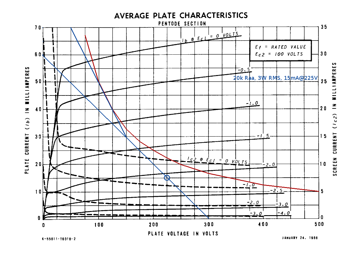

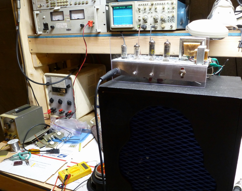

Back on topic - a few 6LY8 valves recently found their way into my box of treasures. The triode section seems to be half a 12AX7, judging by the datasheet numbers and curves. The pentode section (my first pass at a push-pull load-line is attached) looks good for around 3W RMS in push-pull. Importantly, this is using the same output transformer (22.5k Raa) and power supply (around 225V B+) I'm using now in my current amp. I have a 10W audio line transformer that would probably work, too.
Lessee. Two triodes could make a long-tailed-pair phase splitter, leaving two pentodes for a push-pull output stage. How about a two-bottle, 3-watt "Super-Lite" version of the 18-watt Marshall power amp? (Plus one more bottle for the preamp.)

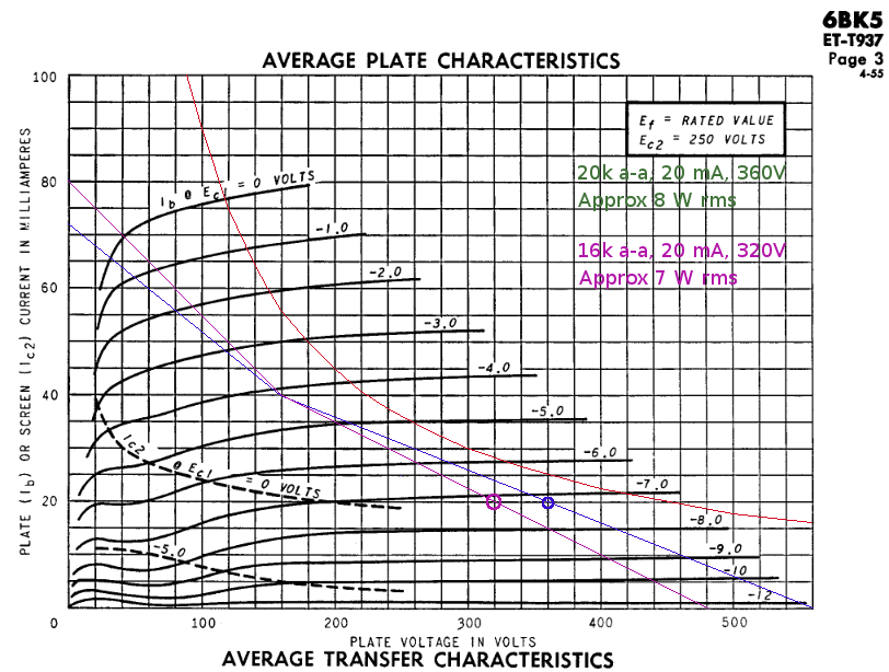

A few lost 6BK5's also meowed and followed me home. Those look good for maybe 8 watts RMS in push-pull with around 330V on the anodes. Perhaps that's enough power for a combined acoustic/electric amp, like the Riviera we were discussing a couple of days ago?
Too many interesting ideas, too much perfectionism and Internet time-wasting keeping me from following through with them. :mad:

I think I made a mistake calculating Raa in the graph above. The slope of the blue load-line is 5k in the class A region (zero to 30 mA anode current), and 2.5k in the class B region (above 30 mA, when the other valve has cut off). I think that means a 10k Raa transformer, not a 20k one as I indicated on the plot.
That's a good thing, less primary inductance needed for the same bass response. Maybe a cheap 70V audio line transformer will do.

For fun, here's my first pass at some push-pull load lines for a pair of 6BK5 valves. This time it really is 16k to 20k Raa for the output transformer, dictated by the higher B+.
B+ (in the ballpark of around 320V - 360V) was chosen partly with the idea of using a Triad N68-X as a power transformer (turned backwards and wired to double the 115V mains voltage). Or a voltage doubler, with the transformer run 1:1 as designed.
If we trust the datasheet, and I run the screen grids at 250V, it looks like it will only need around (- 8) volts on the control grids to bias it. So a 12V switch-mode power supply might provide enough bias voltage to do a fixed bias output stage, as well as powering the heaters (wired in series).
That's the output stage. That's about as far as my initial thoughts on this one went.
Since I heard about that Rivera two-in-one amp, I really like the idea of one (valve) amp for both acoustic and electric guitar, and maybe that's the direction to take.
So, what to do for the phase splitter? If this is to double as an acoustic guitar amp, I guess we want a low-distortion PI, so that means cathodyne (or MOSFET "sourceodyne"). No long-tailed pair need apply (unless we add unbypassed cathode resistors to linearize the differential amp.) 6BK5's don't need much drive voltage anyway, so cathodyne/sourceodyne is probably the way to go.
I think 360V is too high for the LND-150 (too much power dissipation for the tiny TO-92 package, even at 1 mA drain current). So either the traditional half 12AX7 cathodyne, or some other MOSFET in a bigger package for the sourceodyne.
I'm not sure yet what route to take with the acoustic guitar channel. If I get the power amp and speaker/enclosure to be reasonably low distortion and flat frequency response, hopefully the (clean) preamp will be easy to design. Maybe use the clean, flat-response PA 6" speakers George suggested. If they get down to 80 Hz, the acoustic guitar range is covered.
If the power amp is clean, and the speaker is flat, then all audible tube distortion on the electric guitar channel must come from the preamp. From my current project, I think I can get that from a 6JW8 (or maybe one and a half of them).
How about adding a little EQ circuit in the drive channel preamp to create a honky midrange peak to make the (flat) PA speakers sound like (midrange heavy) electric guitar speakers. Would that work?
The acoustic guitar channel wouldn't have the midrange peak EQ built into the preamp, so it would be flat, and suitable for acoustic guitar (or vocals, keyboards, etc).
I may have just over-complicated this project idea to the point where it will be still-born. Perhaps this time I should go against my instincts, and just roughly follow the schematic of a Fender Deluxe (the '65 reissue, not the older tweed versions), except for the 6BK5 output tubes. That way there will be very little R&D involved, just a fairly straightforward build.
But I'm really tempted by the acoustic+electric amp concept!
-Gnobuddy

Here is the output from the simulation that I used to make the box for the Dayton speakers. My box is 1.2 cu foot with two of the Dayton drivers in it. I decided that I would live with 1 db of ripple in order to get the corner down to 70 Hz. A smaller 0.9 cu Ft box with a similar sized pore sims to perfectly flat with the corner at 80 Hz.
