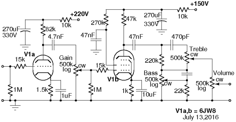

Last things first: Here's the schematic.
Note the two different B+ voltages, both derived from a single 48V Hammond power transformer. The 150V is from voltage doubling the transformer output, the 220V is from a voltage tripler. The doubler makes a negative 150V, but the negative rail is my "ground". The tripler is then easily made by simply adding a positive half-wave rectifier to produce roughly +75V. If that's not clear, let me know, I'll draw up the power supply schematic.
The tone control is straight from Merlin Blencowe's preamp design book. It's the "Bandmaster" circuit. I think I prefer the Voight tone control I was using before - the Bandmaster was an experiment to see if I preferred it (I don't). It's easy enough to swap out the tone control circuit to suit your preference.
The 270uF, 330V caps are surplus photoflash caps from disposable cameras. Affordable, low ESR, lots of capacitance for excellent ripple filtering. (With the input shorted and gain and volume at full, all I can hear is hiss, no hum.)
The other part of the "no-hum with shorted input" result comes from using a small thrift-store 8.4 V switching power supply to power the heaters, with a series resistor to drop the voltage to 6.3 V . I did not add any additional filtering for the heater power - it doesn't seem to be necessary. These days, it's simpler and cheaper to power the heaters with DC. With no AC current to create hum, heater wiring becomes very straightforward, no black arts necessary.
Between the gain and master volume controls, a range from squeaky-clean to early classic-rock distortion is available, at any volume, since it's all preamp distortion. Somewhere in between, there are some gain settings that create an interesting bit of compression, which sometimes sounds like a bit of slap-back delay.
I used fairly low voltage (around 25V) ceramic caps for both cathode bypass locations. The 10uF one (from Mouser) is only about the size of a match-head!
-Gnobuddy

I think that trying to squeeze 50 to 60 db of voltage gain into a single stage WAS the bridge too far.........
Perhaps you could get the same sonics (and less unwanted side-effects) with a little bit of clean gain ahead of the pentode, and a bit less gain in the pentode-saturator stage?
In my preamp, I went to some effort to keep the gain of the pentode stage down. The anode load is relatively small, the B+ is low at around 140V, and anode current is around 1.2 mA, not down in the weeds like vintage pentode preamp stages.
All this keeps gain and output impedance in the same in the same ballpark as the typical 12AX7 stage, so I could bolt on a tone-stack without needing a buffer, etc.
On a slightly different topic (but related to the excess gain/ noise/ microphony issue) I did a few back-of-the envelope noise calculations, and it seems as though a JFET might do substantially better than a typical input valve stage when it comes to input noise. Flicker noise is the main issue in both devices, but it seems that some JFETs have much lower flicker noise (in the guitar's frequency range) than a typical small-signal triode or pentode.
Mebbe a JFET clean input stage configured for a fairly low voltage gain, before the signal hits the pentode saturator?
That was my next plan. The breadboard was about halfway wired up when I left on a 15 day road trip. Now that I'm back I see that there is a 6JW8 in the socket. I chose that tube mainly because There is a box full of them and others with the same pinout to roll through the board when its built. I didn't quite remember which one wound up in the socket.
The next experiment will aim for a triode first stage followed by the pentode. Haven't thought much beyond that, and even that may change......I got a couple of really DUMM ideas to test.

I like some things about this particular tube/valve for audio preamp use, i.e., tube parameters fall in a useful and easy-to-use range. The $1 price is nice too.
The only minor downside (to my ears, I don't have THD measurement capability yet) is that my 6JW8 triode gain stage sounds very, very clean, cleaner than a similar 12AX7 stage. My guess is that this is because the internal anode resistance (ra) is quite low, so that even a reasonably low external anode resistance Ra acts almost like a constant current source, and you get a very linear transfer function.
In other words, if Ra >> ra, one gets very little nonlinear distortion out of a triode, and it's hard to avoid this situation with the 6JW8's triode section, because ra is quite low.
I do like the sounds from the "pentode", though. (It appears to actually be a beam tetrode.)

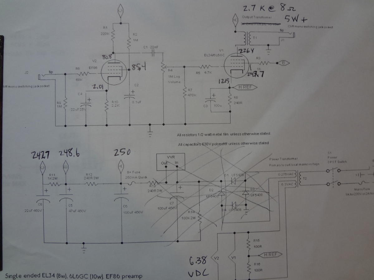

I made a few Champ amps from them but found I like this circuit better.
EF86 - 6L6 at +250V for B+, puts out @ 6.5W according to DS.
It is a very clean sounding, simple circuit, with much better sound than a Champ IMHO. More powerful too.
If you want dirt, you just need to put your favorite distortion pedal on the input.

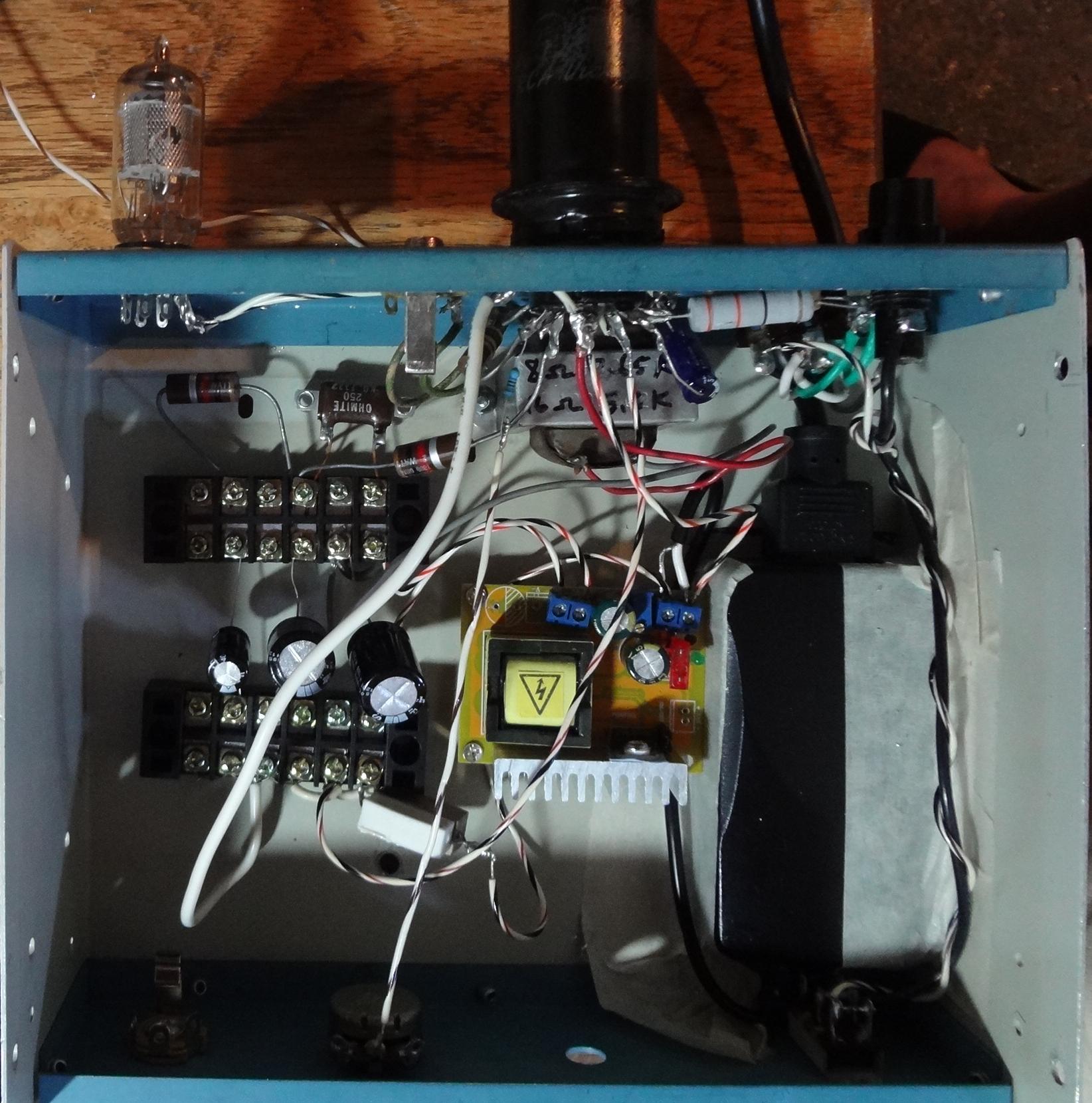

I've used a 2.5A 12VDC laptop PS rescued from the trash.
It powers the heaters and an $8 Chinese DC-DC step up board.
A very inexpensive build, that sounds outstanding to me. :D

See what happens when someone tries something different.
The pentode can be switched to be either an input stage, or a second amplification stage? Interesting idea! :)
... a James control tone stack going into a pentode?
How are you liking the James tone control? In LTSpice, I found the passive James circuit simulates rather badly (with very assymmetrical boost/cut behaviour), which has discouraged me from building one.
The passive Baxandall seems to have the same problem, i.e. extremely different boost and cut characteristics.
