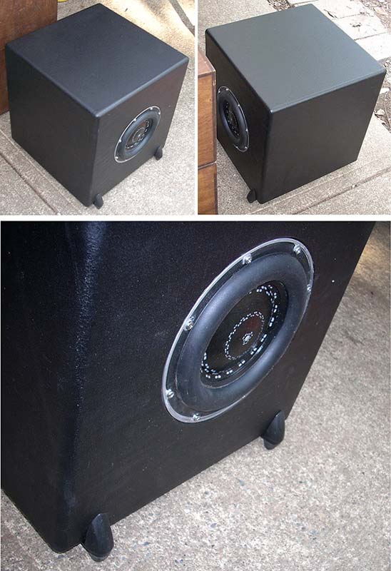

The plans say the first approximation for the cc is 1.8 liters *(for the 108). Is this still recommended and accurate? Just asking because I'd prefer to not have to remove and replace the driver a million times as I tune it or my screw holes will get wrecked. And it needs tuning BAD.
just a guy said:The plans say the first approximation for the cc is 1.8 liters *(for the 108). Is this still recommended and accurate? Just asking because I'd prefer to not have to remove and replace the driver a million times as I tune it or my screw holes will get wrecked. And it needs tuning BAD.
Retrofit with threaded insert fittings ( not T-nuts) and machine screws. Black oxide finished socket cap screws look particularly nice on the Sigma drivers.
Normally you'd hammer them in place before attaching the front baffle, but they can also be tightened with the aid of a flat washer on the front side.
Understood. Thanks for the tip about not using t nuts, as that would have been my first choice if/when the threads are stripped on the wood.
What about the cc size though? How did 1.8 liters work for you? Those plans were published very early in the development of these speakers, have there been any insights since then? This is my first fullrange project, so I could literally spend days finding the happy balance since I have no point of reference as to what to expect.
1.8 litres is just about right for the 108...

Ahhh, much better now.
Not perfect yet, but with 4 bars of ivory soap in the chamber, and the driver area subtracted, I'm in the ballpark at least. And it makes the house smell nice.
It sounds very nice now, dripping with detail, with a killer midbass snap that could take your head off. Maybe a bit too much midbass, but it's all cool for now. Low bass is mia, but that's ok and expected. It gets plenty loud in it's comfort zone range.

After a comedy of errors the second box is mostly finished, it will be listenable tomorrow.
In the meantime I'm having a nasty, awful time trying to tune the first one. Today was the first time I stopped listening exclusively to the bass spl potential and started listening to voices. Vocals served to prove that I have a big midbass problem, even female vocals resonate throughout the whole room. I ended up taking everything out of the cc again and that helped but not enough. I had to pull the speaker about 3 feet out of the corner and that helped too but not enough.
So I fired up my media player eq and... I noticed that I had forgotten to turn off the 6db BSC I was using from 125 hz and down on the last speakers. So I turned that off and things improved immensely, but now even with a flat signal, no cc fill and 3 feet out from the corner I still have a touch of a midbass problem.
Taking 250 hz down 3db and boosting 125 hz 3db seems like a happy compromise for the moment, but I'd rather solve this mechanically.
This midbass problem might have more to do with the room than the speakers so I'll have to move this setup around the house a bit.

The boxes are made from 5 layer arauco ply. It sells as 12 mil but measures 11 mil. This wood is used on all outside panels as well and the plans were adjusted to take the thickness of the outside panels into consideration (slightly less tall and deep than if I used thicker wood for the outsides).
No chamfer on the baffle, but that was done because the wood is so thin already that if I chamfered it the driver mounting screws would have almost nothing to grab onto. If this proves to be a big concern I can retrofit a chamfer with a file and a few minutes (hours?) of work. For that matter, I could fit another thickness of wood to the whole front baffle and make a larger chamfer.
The drivers are very well sealed with a thick foam weatherstrip homemade gasket.
Absolutely no idea how many hours on the drivers. I got them used and have used them since as tv speakers in small ported boxes, but never beyond conversational levels.
The cab (still only one done now) has been tried in a couple of different corners. The 2 corners I've tried are both in a recessed alcove in a very large room that is open to the entire house. The alcove measures about 3 feet deep x 9 feet wide (by looks). This alcove is nested in a corner of the large room. So it's in an alcove in a corner. (Supercorner?) It has been placed everywhere from 5 inches from the corner to about 3 feet away from the corner (slightly past the "mouth" of the alcove). Pushing the speaker back into the corner makes the midbass problem more pronounced (subjectively - no measurements yet). Pulling it out past the alcove mouth cleans up the midbass a bit but it's still too strong. Maybe the size and shape of the alcove are a problem, still have to test in different rooms.
No suprabaffles, since these are a gift for a girl, so waf is of ultimate importance. It's my sister's wedding present. Some girls might appreciate the looks of level 3, but I don't think it would go over well. I can fashion some slip on suprabaffles for testing, but I actually think they would make the problem worse. If I have too much at 250 hz, a suprabaffle would certainly bring that 250 hz up in volume a bit. To my untrained ears (and brain) I can't see a suprabaffle helping, but I'm willing to try.
Also, the sealed wasted space chamber is unfilled. This might be a mistake, not sure how much that big unfilled chamber can contribute. I was going to leave it open with a "fill hole" so they could fill it with sand when they get it home, but I can almost guarantee they won't. Weight is a major concern here too, since they have to take these back in a suitcase and the limit is 60 lbs. Currently, without drivers, it weighs 13.5 lbs (each), so filling with sand now may (or may not) take me close to the luggage weight limit.
