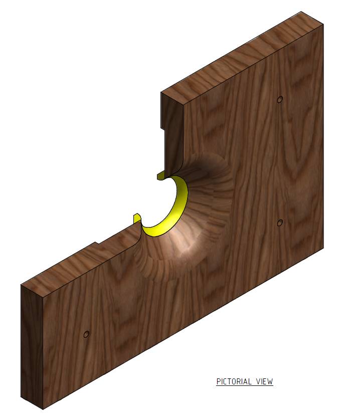

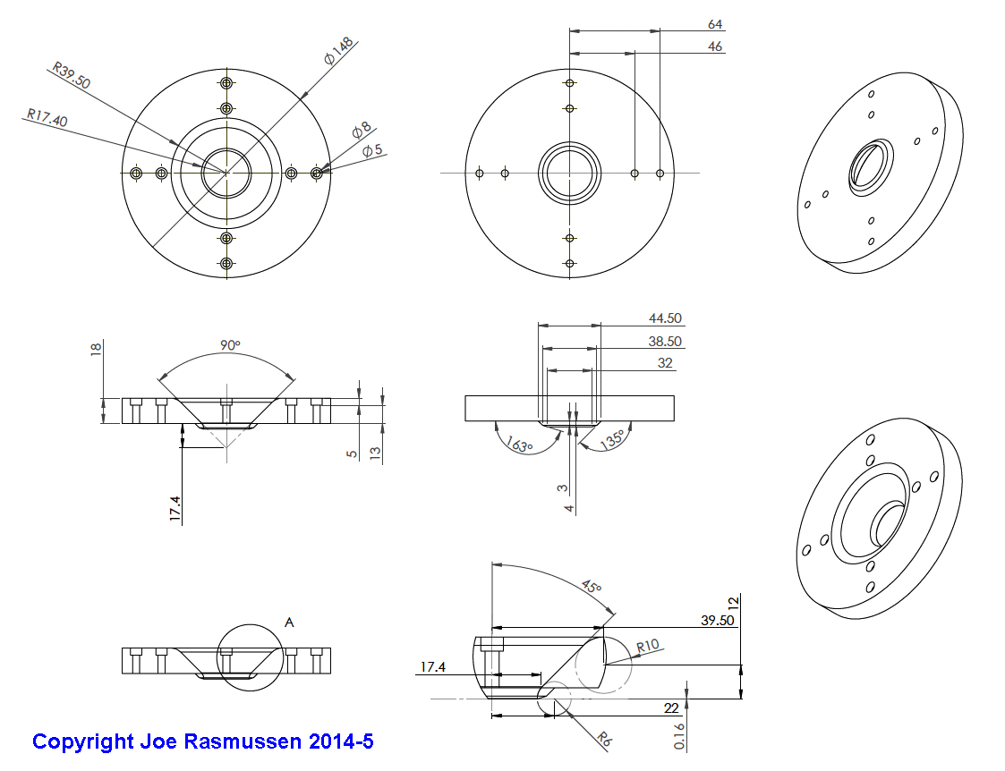

Re Waveguide drawing, I used an example from Joel Wesseling and gave it to my industrial designer friend, who then produced a sample made of Acetal (also known as Delrin). I asked for a small adjustment near the throat. This is the part that forms the hole in the middle and needs to fit into a bevel on the front plate of the tweeter. The second sample proved perfect, but I don't have drawing of it. I only have the earliest drawing of the square Waveguide that was used to upgrade earlier Elsinores like the Mk1 where we had a large square cavity to fill. I can find that drawing and post it.
The current Waveguide is so precise that the tweeter self-centers itself. It itself is the drawing. Maybe I should try measure it and make a drawing. Maybe I will try that (difficult).

I found a drawing that I forgot I had.

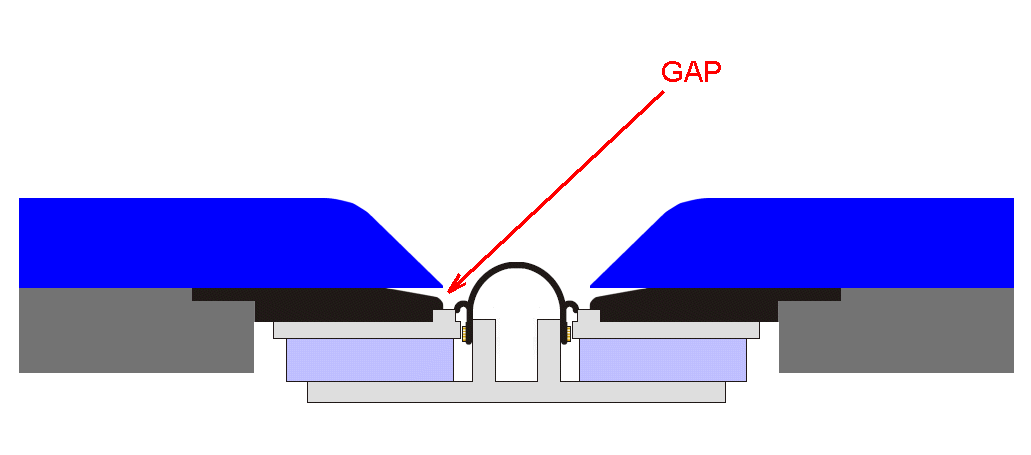

The key is the fit inside the bevelled edge, you don't want a gap there.
This is bad and will give you an irregular response:
This was the original drawing with the square 18mm MDF was used, was hand-made by a friend, about ten pairs:
The fit in the throat was good, but not perfect.
It was around this time we went to a round Waveguide, which was first made by Joel Wesseling.
Later it was up to me to continue it, but it was decided to give an even better throat fit.

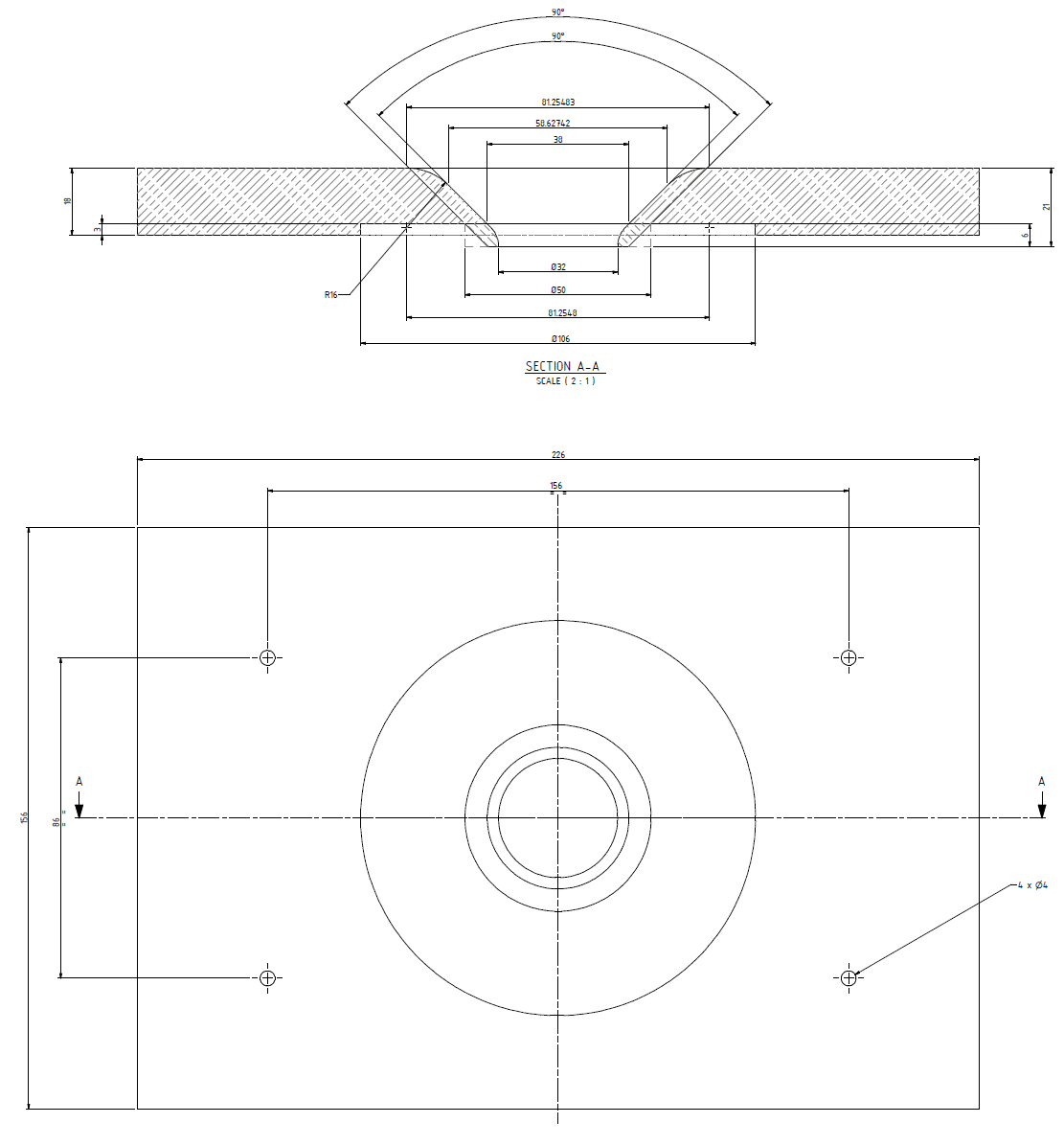

This is what I just found, the actual drawing:
PLEASE NOTE COPYRIGHT - ONLY ALLOWED FOR SINGLE PERSONAL USE:
Look carefully at the throat and the 163 degrees and 135 degrees, they are critical to get the best throat fit.

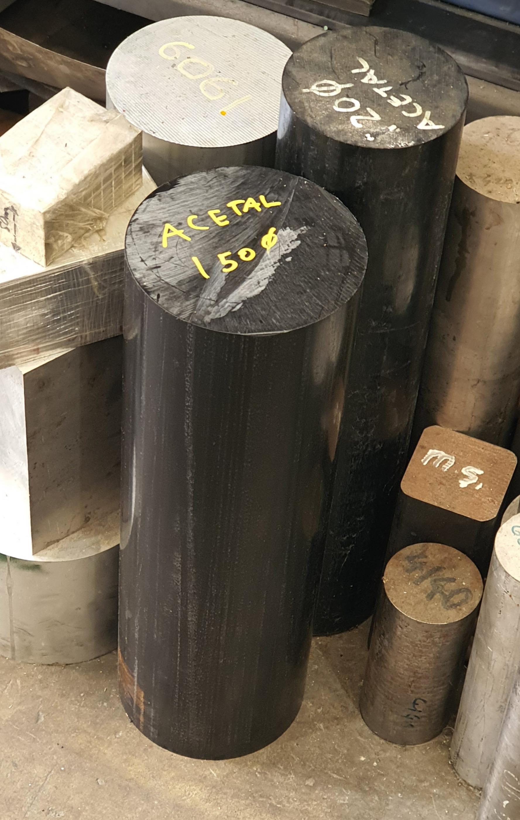

as i can see waveguide diametr is 148 mm but on constructure drawing page the hole for waveguide is 152...
Corrected! I think that this is a legacy of Joel's Waveguides were made out of aluminium and 150mm leaving 1mm all around. But we have been making it out of rounds (see below) of Acetal (or Delrin) and they are 150mm diameter and for better finish are machined to 148mm.

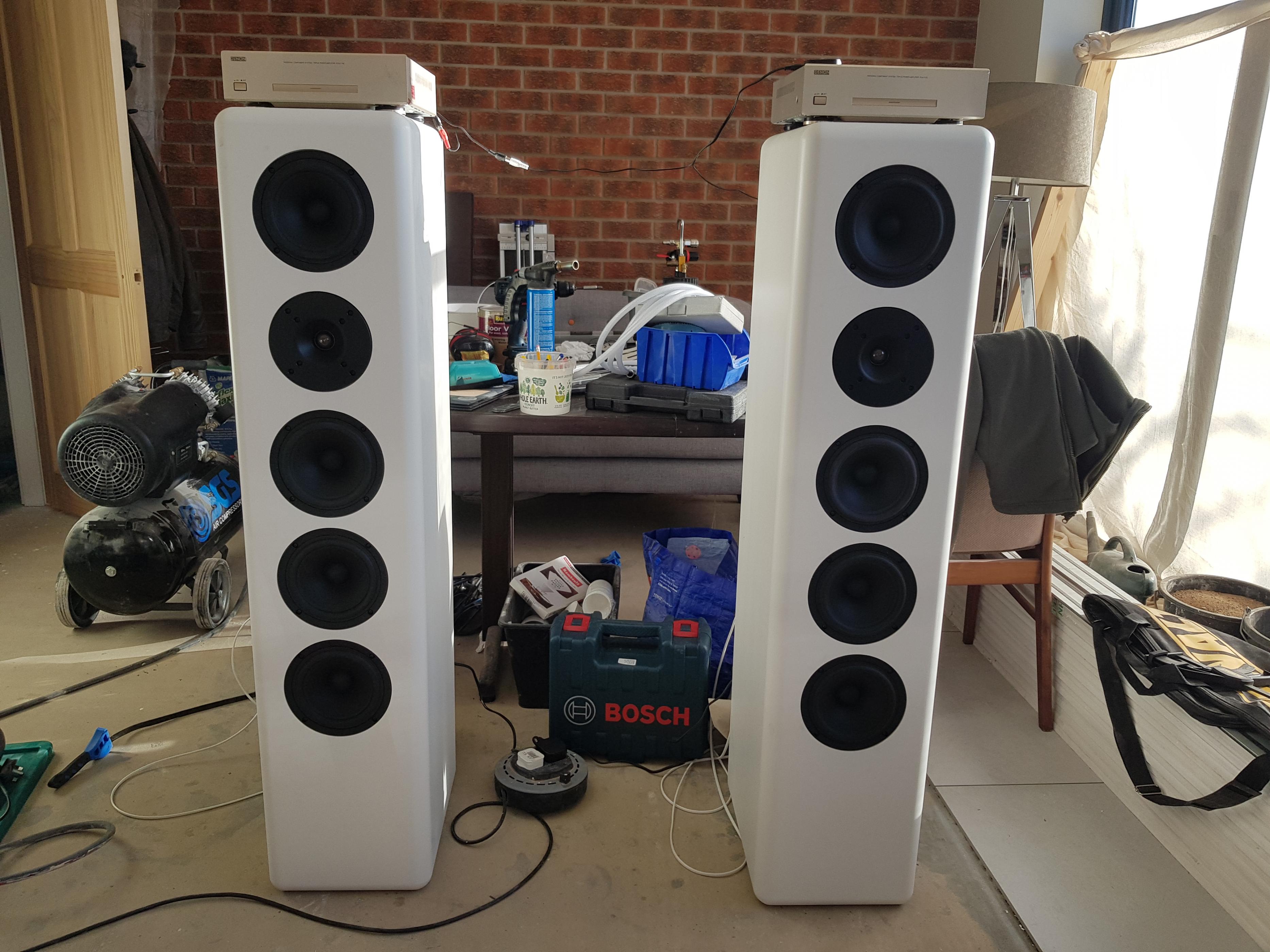

Mildly tweaked the design of the cabinets. They're about 125mm taller to bring the tweeters up to ear level, and the added volume has been reduced back to stock with a silly amount of epoxy/sand in an elaborate pattern on the back panel. The goals of the sand nonsense, aside from reducing cabinet volume a little, was to add stiffness and lots and lots of weight (over 50kg each without drivers).
Rounded corners (1.5" radius) were chosen mainly for aesthetics, but perhaps assist diffraction too. Don't mind either way, much fun with the router though 🙂
Right now, there's only dampening materials on the walls, no bass port and the crossover is a single 4.7 uF cap blocking bass to the tweeters. They're being driven by a pair of 3 channel Denon amps - so tri-wired. Sound pretty good, but clearly need tuning. Also only finished in a white shellac primer but look pretty good.

Yes, that's right. Though the back isn't flat. Glued some ~50mm acoustic foam between the braces, then carved out enormous diagonal crosses in the foam to roughly remove the desired volume. Then filled the empty cross spaces up with the sand/epoxy mix. (might have been polyurethane not epoxy - ages ago)
The idea was to create a lumpy back to break up reflections. Generally thinking that every whimsical idea must help, or at the very least add to the story.
3D printing the bass ports at the mo. Should be tuned to between 32 and 35 Hz, depending how it behaves. Usually prefer sealed cabinets, but if having a port, then tuned quite low. Some extra stuffing will be added centrally height wise to dampen the organ pipe effect I can hear. That will be put in place in a few days (each port takes about ~27 hours to print including the wait for it to detach itself from the build plate).
Final tuning will be done once they're in the final resting place - which will be in 2 further house moves. So probably going to tinker a bit in the mean time.
Is it considered a sin here to deviate from the design at all? Hope not! They should eventually end up quite close but tuned to suite whichever house I end up in in Helsinki.
