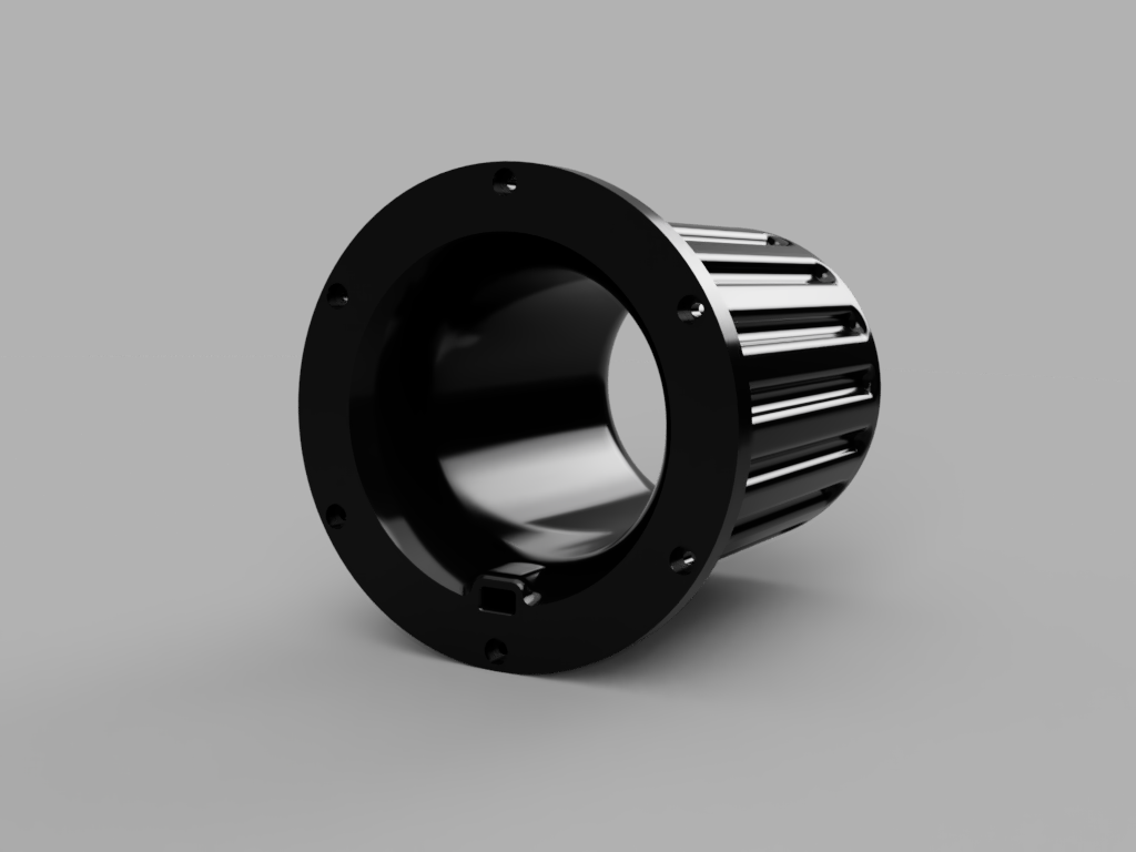

Here's a render of the bass port that's printing.
Strange hole at the base is for the 3 cables to run through (will be sealed). Lost enthusiasm to make a binding post panel. Also not sure where it should be as not sure of future listening room layout. Seemed a better solution than running the cables through the actual port.

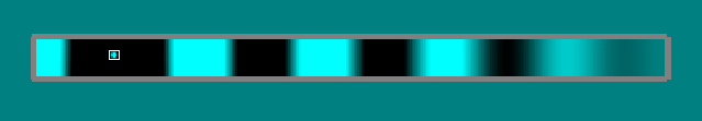

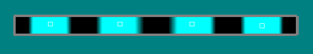

When you have woofers distributed along the box length in the way I've shown below, the effect of each tends to stay in its own part of the space.. the same as if there were dividing panels in between them.
Although I couldn't get the (animated) simulation to show timing very well in this form, my intention in the first sim was to show the way the variations are spread evenly with 4 evenly distributed woofers, and they ignore the length of the box as they don't travel.
The second sim shows one woofer in the end of the box. As the wavelengths are short enough they can be seen to make their way down the line, making the length a part of their behaviour.

The first thing you need to know is that a cone normally produces pressure, eg higher than the air around it, and this pressure difference causes it to move, and expand outward as the pressure relieves/equalises with its surrounds.
If you instead surround it with equal pressure (from the other drivers in the cabinet) then it has nothing to drive it to move or expand. The pressure just builds up on the spot.

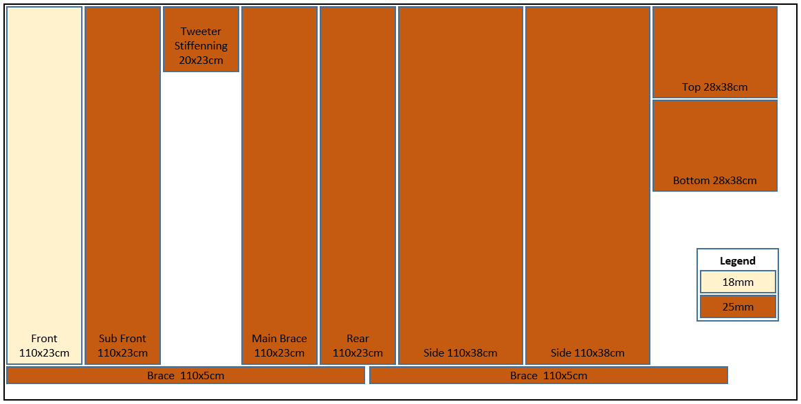

i will use bb/cc plywood with 18 & 6 mm combination, is there any cutting plan that i can use as reference? so i can estimate how many sheet i should order
