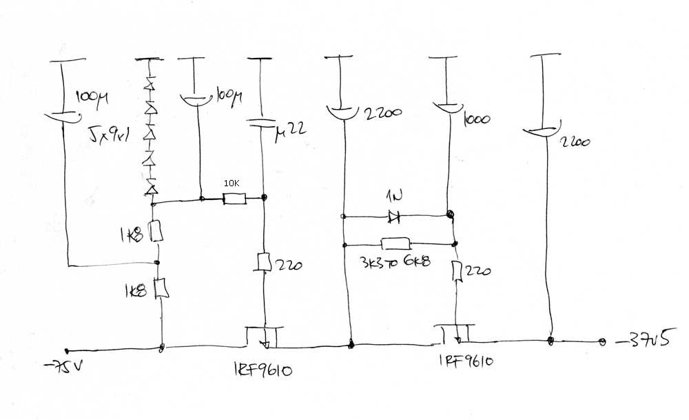

this was drawn as surrogate for Super Shunty :
(pos. side )

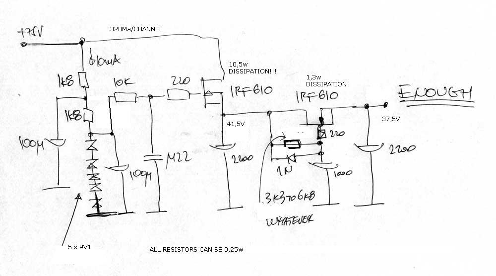

ZM, thanks a lot for the suggestions, and the power supply. Yes, I doubted;) I have just measured the current draw to 245mA pr channel and having the preamp playing for a couple of hours was no problemo, heatwise. I might just stick with the voltage/current settings for now and work with the psu, to bring down the noise. I am probably gonna build the Luxman EI-trafo back in for this. It has 43-0-43V on the secondaries for the power-amp section it was feeding. I will also install the resistors you mention for stability. Can the BC's be plugged in, without any other mod's? (Watching the pin's ofcourse)
Zen Mod said:
yup - just look at Pumpie schmtc ;
are your ears no problemo too , heatwise ? :clown:

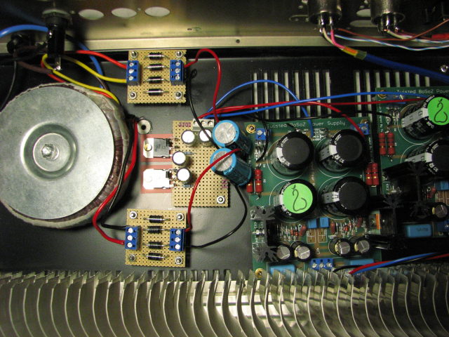

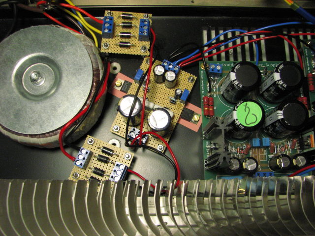

The Drek is doing great, though. I have installed a small BJT capacitance multiplier, in front of the Twisted supplies. It took care of almost all the noise. There is a tad buzz, but nearly no windy hiss left. Unfortunately there is not enough room for the Shunty's, unless I go dualmono, which is completely nutz with a preamp. I might try a 317/337 prereg or the other supply you posted earlier. I also installed schottky bridges using 3A devices, and simply lifted the rectifiers on the Twisted boards.

Judging from the smell, I'm still here. At least partly:devilr:
I changed the pre-reg to a 317/337 and that cleaned up the noise a bit further. It is now at a level where I have to stick my ears to the speakers to hear it. I beleive that the last bit of bzzzz'ing noise is comming from the zeners in the BosoZ supply. I will install a set of Toolereg's when the GB boards arrive. I dont feel like etching four of those doublesided compact b*stards, with boards on the way. I think that getting rid of the zener regulated supply, will do the rest. Anyway's, the noise is at such a low level, that it is easy to live with. The Drek is definitely touchy, regarding supply noise. It has been pretty interesting to hear the noise change, from using different supplies.
The Drek sounds great. It is a real pleasure and entertaining, to listen to the music it produces.
Here is a shot of the new prereg. I didnt (ofcourse) bother to mount any of it permanently yet.
