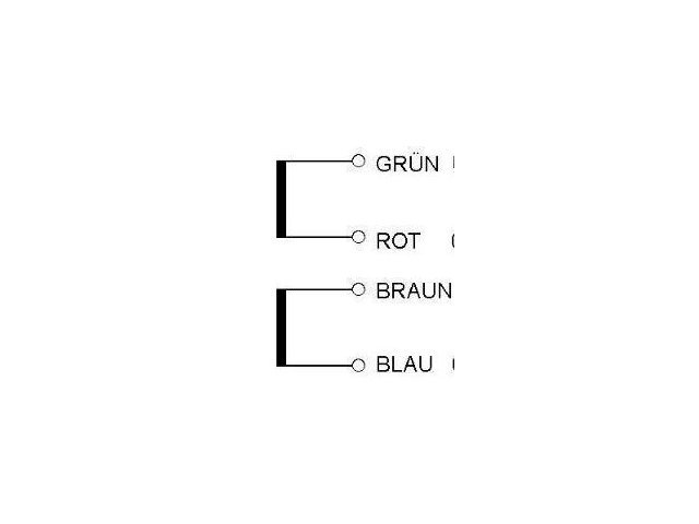

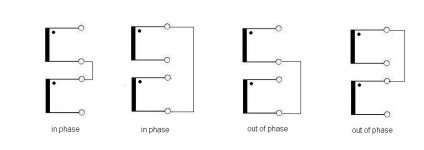

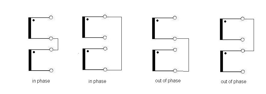

steenoe said:Does it matter if the two in the middle are connected or if it is the two outermost? I was ofcourse looking to find the middle point, which is the Rot und Braun on the pic.
Yes, it matters.
Magura
Zen Mod said:
I think my measurements make sense after all. How do one determine the two in the middle, was the question It looks aesthetically much better to use those as the CT point.
steenoe said:That would be DC resistance, not impedance
I know, but I dared to assume that he meant DCR, as the inductor would be smaller than what I know he is playing with, if the impedance would be <0.1R.
