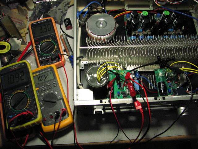

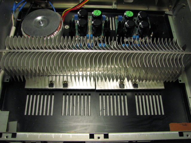

Last picture:D I built the Drek into an old Luxman 2x80 watt'er integrated, and used the heatsink from it. By bolting too small pieces of alu (heatsinks actually) underneath it, created an area to mount the fets to. Worked out pretty well, regarding the heat. The supplies are for now two Twisted BosoZ supplies, set up for +/-36V.

It sounds fantastic:D There is still some things to modify, like rebuilding the supply to Shuntreg's and so on, but this preamp has more potential than I would have though. The dynamic's are simply tremendous, and soundstage , details and so on, are the usual Toshiba J-fet business;) Simply great stuff. The outputswing and gain are much too much for my U.P's so I lowered the gain to about the half, which is still too much. ZM, what are the possibilies to run this thing at lower rail voltages to give it some more relaxed working conditions? Without any penalties, soundwise ofcourse.
There is some noise with the gainsetting used in the schematic, it was less when I lowered the gain. (Sort of hissing, windy noise)

anyway - it have worse CMRR and ripple rejection than :Pumpkin: , because Pumpie is more symmetric ....... and Drek's chokes are perfect path from hiss flowing from supply to output , collecting it also to gates ;
put some chokes somewhere in both neg and pos supplies and find what's difference .
I can bet that his is solely from PSU's
regarding voltage - I think that you can go down to +/- 20V , and to half current through outputs , comparing to what you are using now .
double increase source resistors for outputs (22E) for that , and re-set .
another one - to increase stability - put 22k to 33k ditto from both 369 gates to gnd .
you can do that easily from copper side .
you can also try BC546B as cascode elements , instead of 170s ; Metaldanske was responsible for that ........ :rolleyes: " I have fets in my junk , but I don't have small bjts ....... can I put 2N3773 there ...?"
