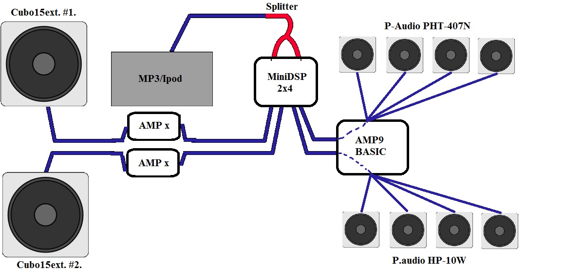

The use of MiniDSP, AMP9 B and SUB (Cubo15)
You can probably build two dual 15" reflex boxes and use your amp9 sub channels. One dual 15" on each. That'll probably do it. Won't be very compact though.
I am starting to understand the benefits with the MiniDSP and the AMP9 Basic. Please correct me if I am wrong Saturnus, but since the AMP9 B has two inputs would the setup look like this? (Directly connected to the amp without any passive protective components?)
And then by splitting/doubling the MP3 signal the adding of SUB speakers is possible. Where the AMPx will be rated with 4 or more times the power output as the AMP9 B.
