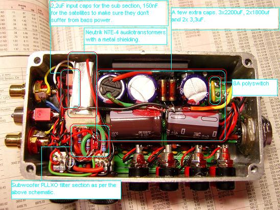

I am running a AMP9 BASIC with a PLLXO filter which splits the channels at around 100hz.
My plan is to make not only one standard Boominator but a second one as well just larger and instead of tweeters and bass drivers, it will only have 4 subwoofers mounted in the same fashion as the standard Boominator design (magnet to magnet).

I would very much like to do what you recommend Saturnus. However as of now my problem lies likes this. I only have a assembled AMP9 Basic and a disassembled AMP6 Basic. I won’t hassle with changing my AMP9 Basic, I would much rather read up on use of LR4 filters and start from scratch with another amp or maby even the use of a MiniDSP. (I am afraid of ruining the amp see pictures.)
Because of the open air environment I can understand that the subs would need much more power. Do you think that only disappointment awaits if I were to use two Cubo15 ext. on my subwoofer channels? In a sense that it won’t be able to keep up with the Boominators output.
