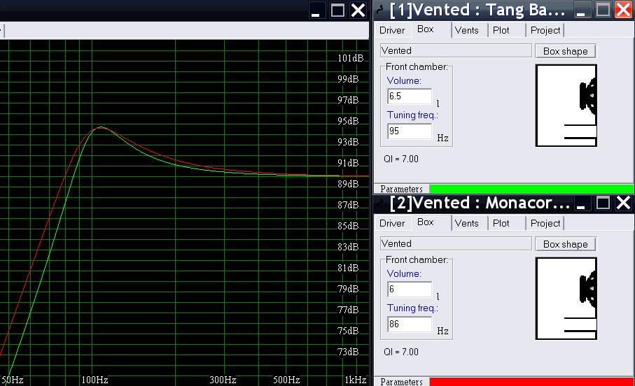

1). Monacor exceeds the bass performance of the very loud Tang Band W4-1052SDF even if the exact same amount of decibels are entered into WinISD's model parameters for both woofers. See attachment. 2). Despite the international shipping the Monacor was considerably less expensive, whether or not considering that less complex crossover makes an additional price difference. Reference: Mini Bass Speaker SP-60/4 by Monacor 3). The cabinet size for a pair is 1 liter smaller for the Monacor.

Did I do the tuning right (see attachment)? It seems that one wouldn't want to cut the efficiency with a BSC circuit or push extra hard with a bass booster either of which run the amp out of power easily. Or, there's this boost:
Okay, you're awesome. I was convinced that I should build a miniature Halfinator. There was a lot of fascinating reading in the boombox/portable index document The answer that I got from reading there was: Miniature Halfinator with Monacor SP-60/4Lots of examples over at the 41hz.com forum

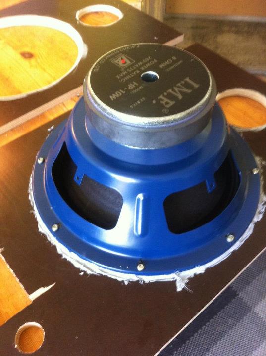

I left the project when i had to glue the grill, with the driver then on the wood. I remember trying and thought this ain't never going to work so i have taken some pictures now. I still don't know how to proceed with this. My biggest concern is how the glue should hold the grill and the driver together onto the wood.
I know that you @saturnus told me once that the gasket that comes with the grill should not be used and that the glue should hold but when i tried last time with the glue that's shown in the picture it was a disaster. Maybe i am missing something. Any ideas ?

Plastic padding does work with a fair bit of effort and lots of it used but acryllic silicone is far better for this.
Picture stolen from Rubenn's build.
oh well then acrylic silicone it is. I pressume he has the grill between the wood and the driver without the rubber gasket that comes with the grill ? Also i would be curios how he fittet the screws because i looked at it and you need to be very lucky to hit the holes from the grill when putting a screw through the driver.
Yes.
You don't need luck really. The screws go through the grill quite easily even if you miss the holes.
