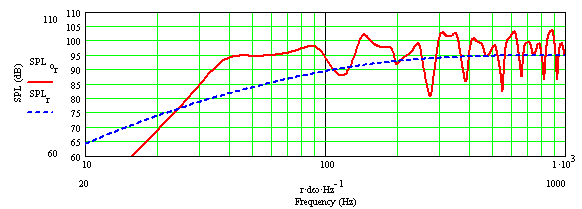

Sam, here's the BIB dims you wanted.
Line length 145in
Zdriver 33in
Sm=58.5in^2
Just to let you guys know, I'm currently working on some dedicated BIB bass extenders. Jeff (Godzilla) is away for a long weekend, so they won't be up on the site for a week or so, but they'll be worth waiting for. A few others should appear too; particularly those Greg's done recently, which haven't yet made their way onto the pages.
Regards
Scott

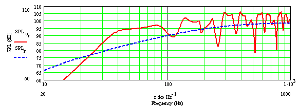

I think Greg's done a couple of Lowthers about 30 pages back. It's about time I did one though, so here's one for your DX3s, using the parameters off the Single Driver site -the ones on Lowther's own site are worth about as much as the ink on a £1 note (removed from circulation 1985).
Line length 128in.
Zdriver 25.6in
Sm=118.25in^2
I want to know what these sound like, so get that saw fired up!
Best
Scott

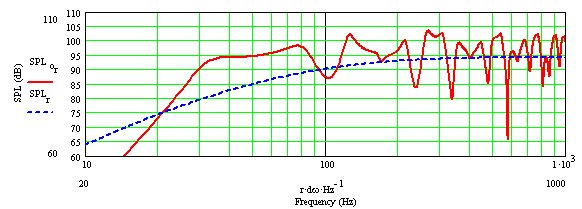

Many thanks as always Greg, why it didn't occur to me to use those on Martin's site I don't know. I must be loosing it.
Here's a plot for Greg's DX2 cabinet:
Line length 138in
Zdriver 30in
Sm=220in
2 ohm series resistance
