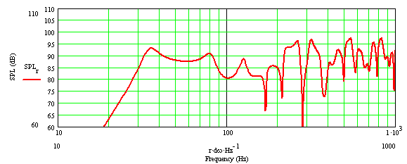

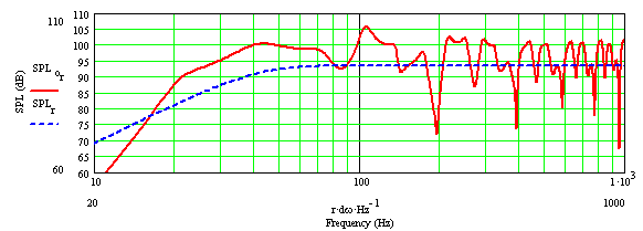

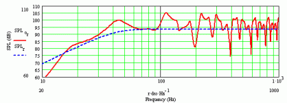

Quick demo. Here's a B200 BIB, courtesy of GM. Line length 169.5in Zdriver 34in. Sm=350in^2 (yes, you did read that 350in^2 bit correctly.)

Hi All!,
thanks for the responses. Hopefully my room will welcome the slightly reduced BiB's as they are and not needing the extra 5l Vb to flatten its in-room response.
As source I'm using lossless audio-files with Foobar from my computer, in the near future a Squeezebox, so some eq is easily made.
As I have two pairs of 166-ESR's the bigger (2xVb) design with higher tunability is of much interest for a later project. Scott, could you please make the sims for a "bigger, bigger is better" ;)
GM, thanks for taking time with thoughtful and technical correct answers, hope you don't mind me posting your "knee jerk" version. I simply got surprised when it vanished before my eyes.

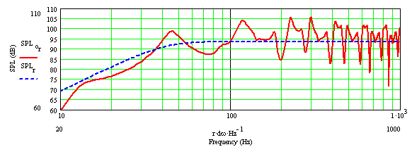

Final B200 BIB box, with Vb halved again, and is now 1/4 of that Greg originally advised.
I hasten to add, I wouldn't advise trying these two smaller versions!

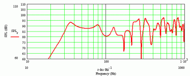

I'll run a sim of the ES-R enclosure with Vb doubled. The predicted FR will have a dip between 2 peaks below 100Hz. That doesn't mean it'll behave like that in real life of course -it probably won't.

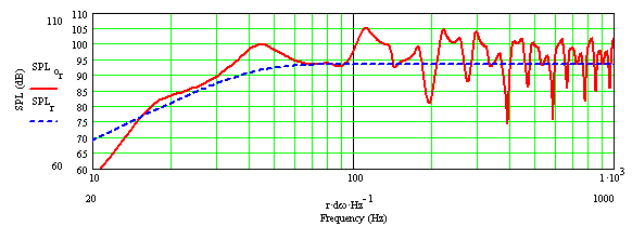

Here's the ES-R box, with Vb doubled. This is why I tend to limit the sizes a bit -note the dip between two peaks, and the increased dip in the midbass on the sim. I suspect the value of these simulations actually decreases as Vb goes up, unless you add series resistance to restore the aparrant balance. I haven't looked an the in-room bit, so I'll check that as far as can be done in the existing sheet and post the predicted curve in the next post as well.

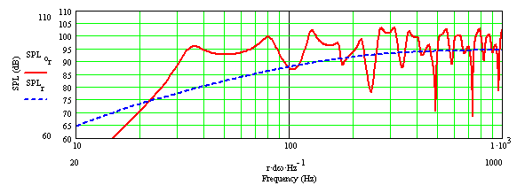

1/4 space sim of the large ES-R enclosure, assuming them rammed against a rear wall. Actually, this is the plot assuming a BSC circuit in place. It flattens the LF out, relative to the midrange, and I reckon the extra LF boost you get from the corner should produce a similar result, albeit with greater efficiency. I believe Martin is working on a 1/8 space upgrade to the sheets, so hopefully we'll get confirmation before the year is out.
Of itself this is quite interesting though -look at that slow dip in the mid-bass that is characteristic of these big pipes. The uneven response Martin reckons is considerably over-estimated. Even when we get the 1/8 space worksheets, an upward firing mouth probably won't be acounted for in that upgrade, so I've had to fudge it a little, assuming a rearward firing mouth at the very top of the enclosure (well, half on the top, half above the top to be pedantic).

I'd hang fire on your dipoles. Not sure the 166 will be the best choice for them to be honest -not enough Xmax for that application IMO. Try the small BIB; if it works, well and good. If not, you can go for the larger variety.
BSC? Depends which you're refering to. The sims on the Zilla site? No. Deliberate choice. Because these are designed to be rammed into corners, baffle-step isn't much of an issue as the box is close to the room boundaries. If you find you need one, I'd suggest Martin's variable circuit detailed on www.quarter-wave.com to dial it in to your specific room. Much better than sugesting generic values.

Hi Scott,
Thanks for the very incisive reply. I see now that Vb is the biggest factor in that type of response as far as the post I referenced.
Looking at the 1/2 Vb simmed for the B200 there is a large dip in the midbass. And then going 1/4, the LF gets more truncated still. Although the lower midrange has just a tad more dip when having a larger Vb (the best balance, ie, Greg's sim), the BIB's placement/room dependent nature + other variables cited makes it less of an issue, if at all.
fred
